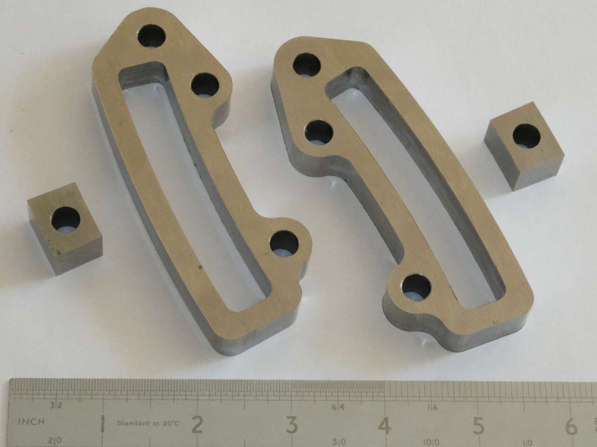

                I also buy gauge plate from M-Machine and Coventry Grinders. I made these last week:
                Embryo Expansion Links
                Julie

                  Red herring: Full-size locomotive die blocks I have seen are one-piece solid bronze.
                  #816729
                  Julie Ann
                    @julieann
                    I don’t think Nigel is building a locomotive.
                    Julie

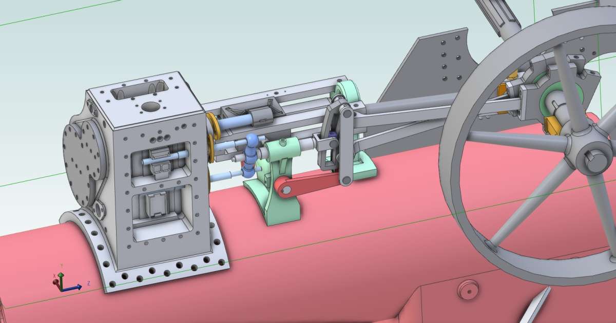

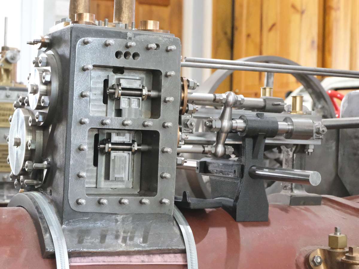

                          Since I changed all the steam flows and port sizes I had to design my valve gear from scratch. Anecdotal comments also indicated that the valve gear as originally designed didn’t notch up properly. I know it’s a sore point but I modelled my valve gear in 3D CAD:
                          Motion Work Assembly 21-9-2025
                          I then spent ages changing dimensions and measuring leads and cutoffs at various valve gear settings. I used to have a motion simulator for Alibre, but it seemed to get lost in the transfer to Geomagic and then back to Alibre. Mind you it didn’t work very well, so no great loss. I hope there won’t be any interferences in the design. I am currently machining the wayshaft support casting. A 3D print of the CAD model shows it fits:
                          Valve Gear - 3D Printed Wayshaft
                          Fingers crossed the machined casting will also fit.
                          I’ve had a bit of a search but can’t find any information regarding materials used for die blocks in full size. Certainly locomotive die blocks tend to be a more complex design with multiple parts and wear plates. I will stick with what I have made and will be not be hardening the expansion links and die blocks to avoid distortion.
