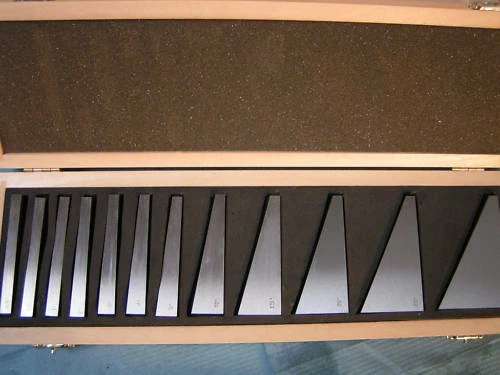

            Do they look like these, albeit with less in the box?
            Precision angle block set.
            http://www.ebay.co.uk/itm/266174600860
            image_2026-01-18_222033076

                Thank you, Bill/Peak4 for your reply and photo which is spot on. Thanks also to Charles,Humber and Peter for your replies.
                As I said,  I tried various suppliers in the hope of finding them pictured on their websites for sale, but no success. Trouble is, unless you provide an exact match of words their puter will reply not found. Without proper name, snookered! I tried ruler/s and parallels as I thought that they could be displayed on the same page. I have only that small set of 5 from 5° to 25° and no box. Could have been sold as a cheap set of most commonly used angles. Possibly the much missed Arceurotrade supplier.
                Thank you all again for your help.

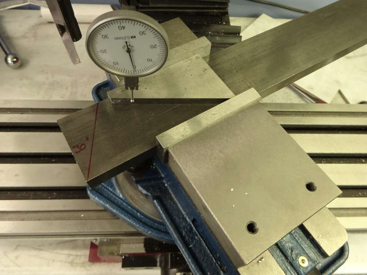

                #833163
                  Says Angle blocks on my box.
                  Photo 25

                      Thank you for your reply and photo. I note your set appears to be 10, so much more comprehensive.
                      I think that I used the enquiry term angle plates and drew a blank. Didn’t say ‘blocks’ as I thought that suggested something entirely different, given  how things they are.  Thank you.

                        Could well have originally been a 6 piece set but the 30° has gone missing. By using suitable combinations that would have given all the 5° increments up past 90°.
                        These days the common, affordable, import sets are 10 piece giving 1° increments up to over 100° and 12 piece ones adding 1/2° and 1/4° increments.
                        But there are many varieties. Sets covering restricted ranges such as up to 10° are quite common.
                        If you re filthy rich Starrett will sell you a 6 block set giving 1° increments from 0 to 99° for just under £9,000.
                        1 1/2″ is quite short for stand alone use, Jasons picture shows one such set up, so possibly intended for use with a tangent bar.

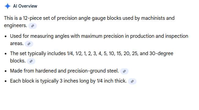

                          On DMB Said:
                          As I said,  I tried various suppliers in the hope of finding them pictured on their websites for sale, but no success. Trouble is, unless you provide an exact match of words their puter will reply not found. Without proper name, snookered! …
                          Next time try searching for the image, perhaps with Google Image.
                          Bill’s photo got me:
                          Screenshot From 2026-01-19 14-44-09
                          Plus adverts from Amadeal and Amazon, who sell them.

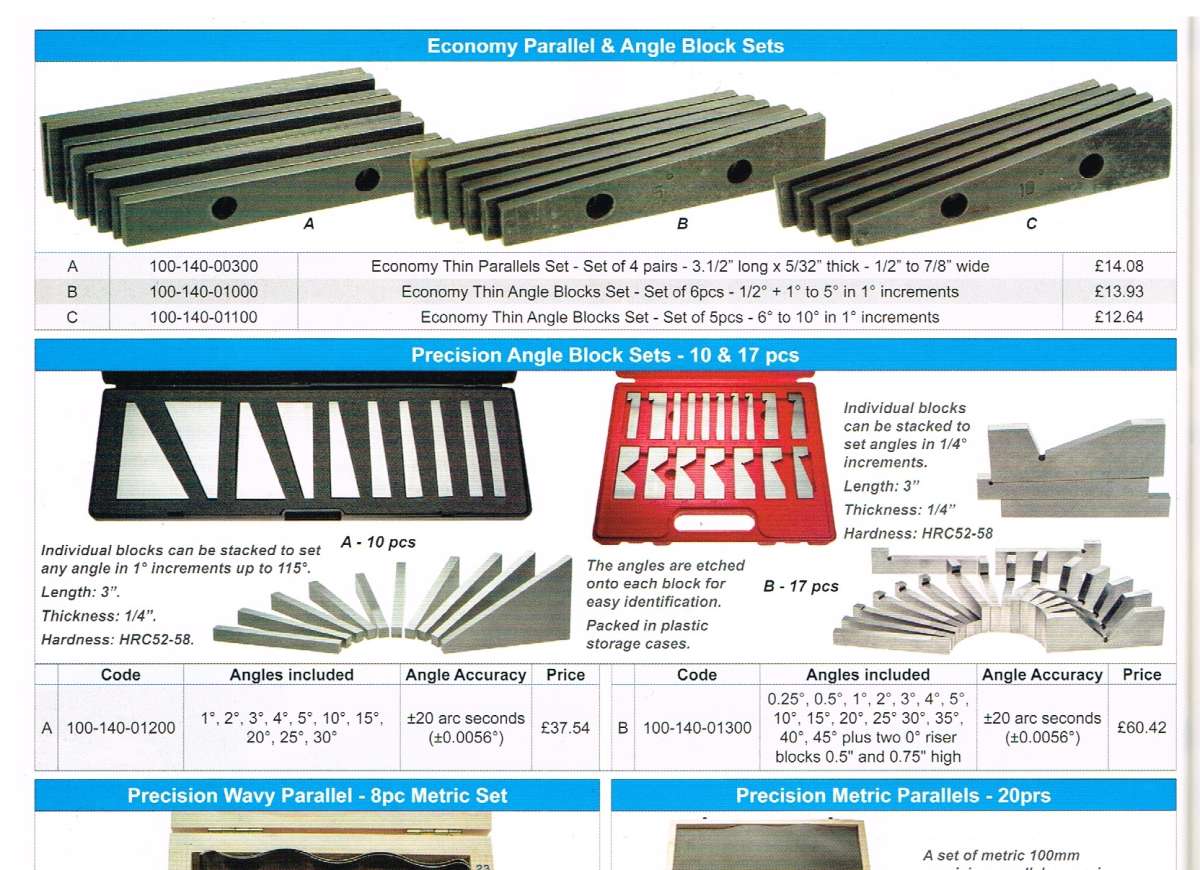

                            Hi DMB, I don’t think they came from ARC, as they only sold an economy set of 5 from 1 to 5 degrees in 1 degree increments, and the box of 10 that JasonB has shown, plus those shaped ones in the red box, and the boxed set of 10 and the red box, was only from catalogue No. 10.
                            Scan_20260119
                            Regards Nick.

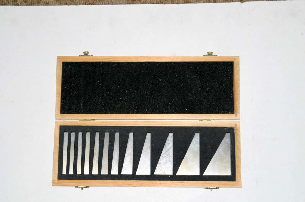

                              Mine is like the one Dave alluded to, 12 piece 1/4 to 30 degree. I think I have only used them a couple of times in 20 odd years!
                              angle blocks

                                John Purdy,
                                Thank you for your reply. What you said describes my feelings on the matter. I have never sought to buy them just for the sake of it as I cannot envisage a use for them. It was just the fact that they turned up in a deceased friends collection of tools. Maybe they might come in handy sometime, if I don’t snuff it first! I was curious as to what the correct name is.

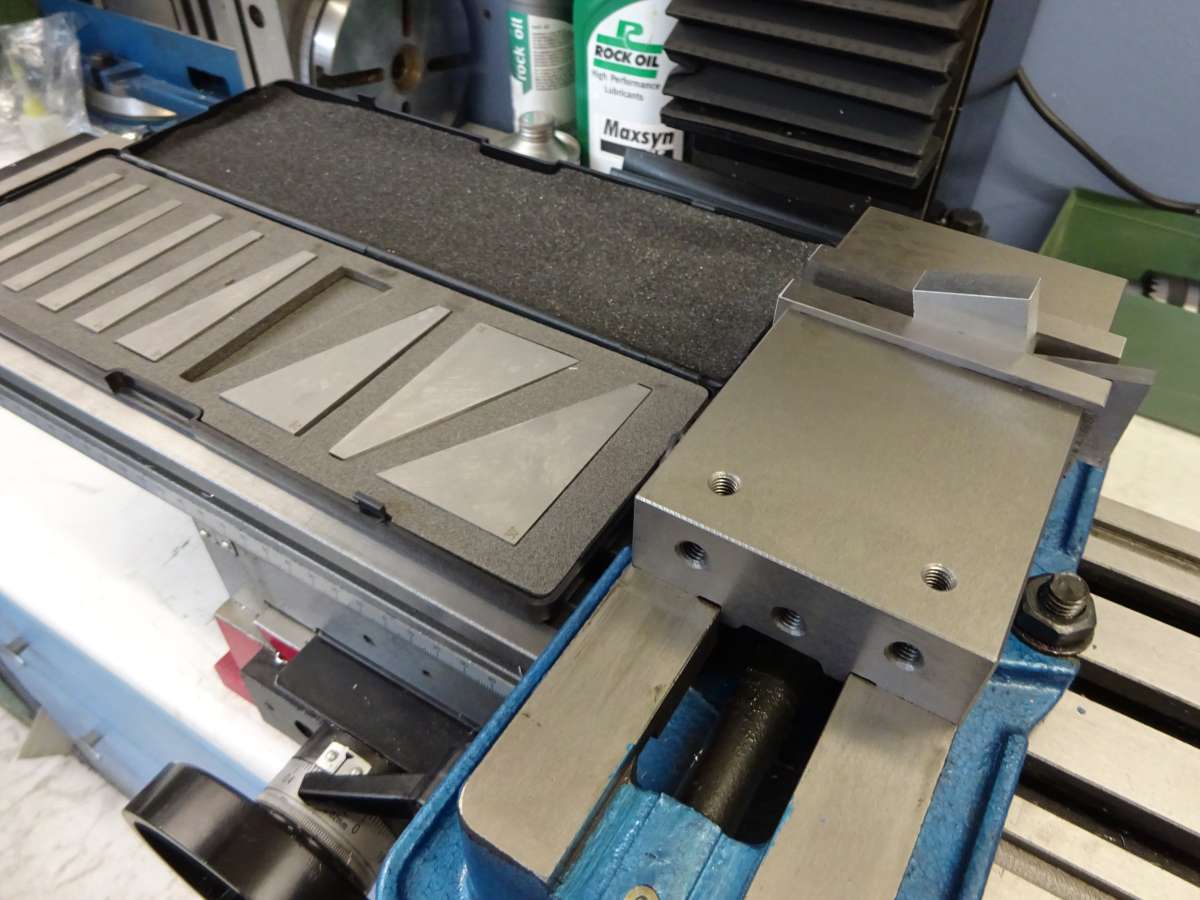

                                    I suppos ethe amount of use comes down to what and how much you get upto in the workshop.
                                    For setting work at an anhle in teh vice rather than th eimage I posted earlier I mostly use one of the digital angle boxes.
                                    Where I mostly use these angle blocks is to set the vice at an angle on the mill table. I don’t use a swivel base and would not trust the markings to be 100% but it is very easy to place one of thes eblocks against a vice jaw and then you have a surfac ethat is parallel to the mill table and easy to clock in with an indicator.
                                    Photo 136

                                      Thank you for your reply and photo, JasonB
