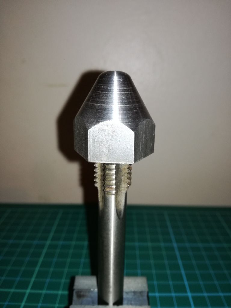

                                    Nicholas Farr
                                      @nicholasfarr14254
                                      Hi, just about all the dome nuts that I've seen and used have been sold and quite often have a small flat on the very top of the dome, I think I only ever saw some nuts with the dome pressed on, once. But I did rescue eight of these austenitic stainless steel M14 pointy type nuts from ending up in the scrap bin in my old day job, the slightly domed part at the top is about 9mm diameter, so could be used on small holes providing the rest of the nut didn't clash with anything.
                                      No idea what they were meant for and never saw a machine which used them, but the company did purchase a transport firm that had quite a few lorries and associated gear and a shed full of spare parts, so they could have come with them.
                                      Regards Nick.

                                      Oven Man
                                        @ovenman
                                        Posted by Nicholas Farr on 29/10/2022 09:30:17:
                                        Regards Nick.
                                        They are the sort of thing that's used in the nuclear industry because they are easy to decontaminate compared with an ordinary nut with the thread sticking out.

                                        Nicholas Farr
                                          @nicholasfarr14254
                                          Hi Oven Man, thanks for your thoughts on that, as far as I'm aware, the old company that I worked for didn't have any connection with the nuclear industry, but maybe that transport firm they purchased made deliveries to the nuclear industry or others associated with them and they just happened to have been left on their lorry by mistake.
