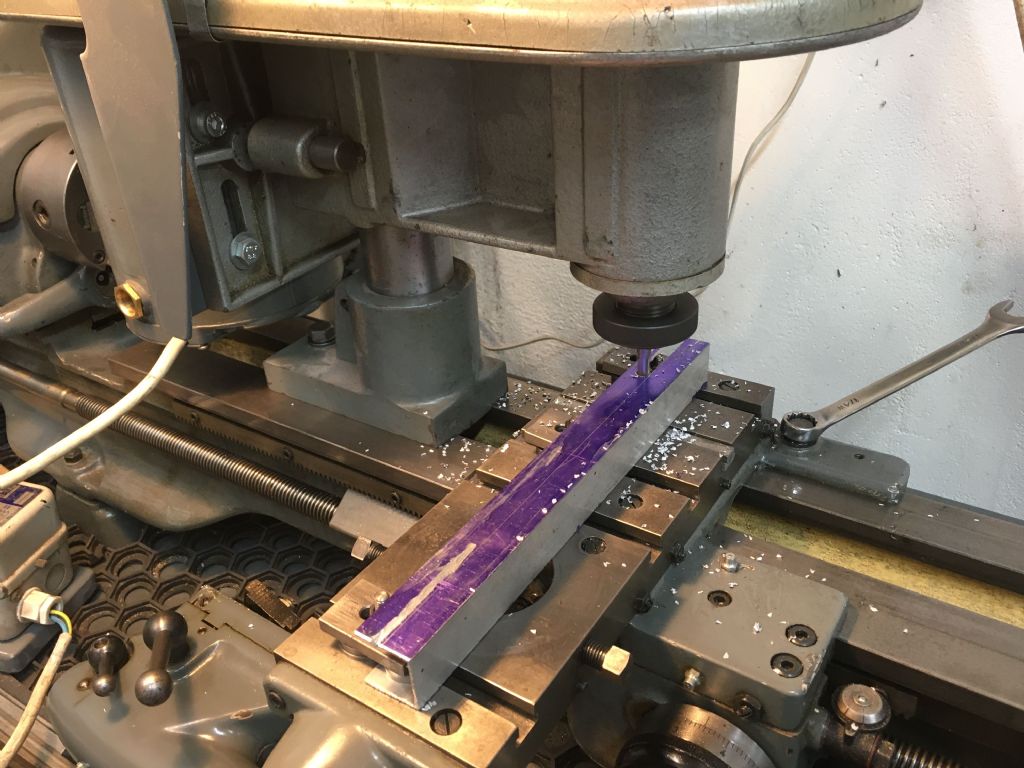

          Hillclimber
            @hillclimber
            I think the intention with these is that you would use your trusty Myford 2MT collet set, hence the presence of the threaded nose for a Myford collet retainer.
            Otherwise, a bit of threaded studding without the lid on, as John suggested…..
            #456795
            Hillclimber
              @hillclimber
              Found a pic from something I was chasing a few ago. The slot drill is being held in a 3/8" Myford collet….
