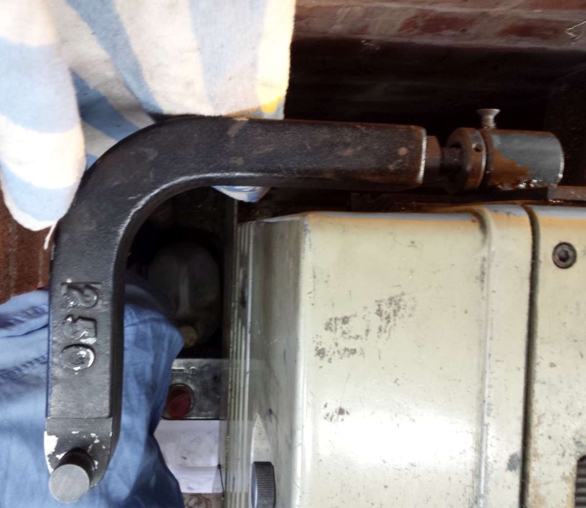

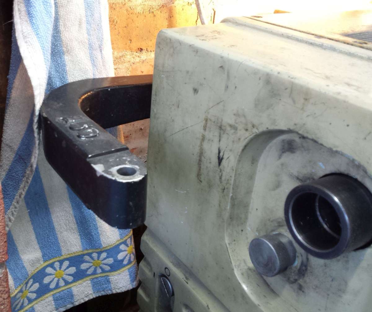

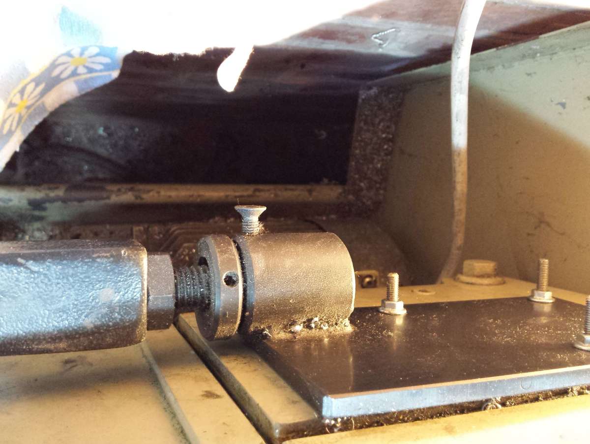

                  Pictures below are of the Acrogrip bracketry on my M250. I’m not sure but I think the boss welded to the plate is actually a very stiff ball joint which allows some height and position adjustment to accept clevis part of the closer.
                  I still have the lathe but not the 5C collets and Acrogrip.
                  Ian P
                  Acrogrip fulcrum bracketView looking down back of headstockLooking down on Acrogrip bracket

                    Hi everyone,
                    The info regarding the use on the 250 was very useful and directly applies to the 300.
                    The photo of the backplate in Ian’s post is correct for the M300 – even the plate mounting holes on the headstock were drilled and tapped M5 and filled with a grub screw to keep out the dirt.
