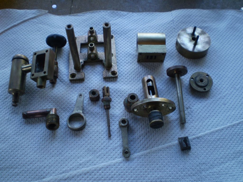

        I have a model steam boat which must be over eighty years old and have stripped the engine down as it was in a bit of a mess.
        I intend to make the engine 1/3 size bigger some time in the future with a boiler but I'mpa270351.jpg not sure what the small tank on the valve case is for.
        I've made a few small steam engines so I should know but I don't, it has a small screw on the bottom so the only think it could be is for collecting condensed water, or a oil tank..

          The small tank looks to me like a displacement- lubricator.
          If I am right, the top cap should unscrew to reveal a tube open cloe to the underside of the cap, and communicating with the branch entering the valve-chest. It's feasible the same function was achieved by a port and passage in the lubricator's wall.
          The screw at the bottom is indeed for draining the condensate that had floated the oil up to the passage into the valve-chest.
          #434953
          paul rayner
            @paulrayner36054
            Hiya Bob
            It's a cylinder lubricator, very basically steam condenses in it water go's to the bottom oil floats to top into valve and lubricates the cylinder. the tap at the bottom is to empty the water out, you fill with steam oil at the top
            regards
            Paul

                Thanks all, if I remember it never had oil put in the tank so I will look forward to get it going.
                Bob

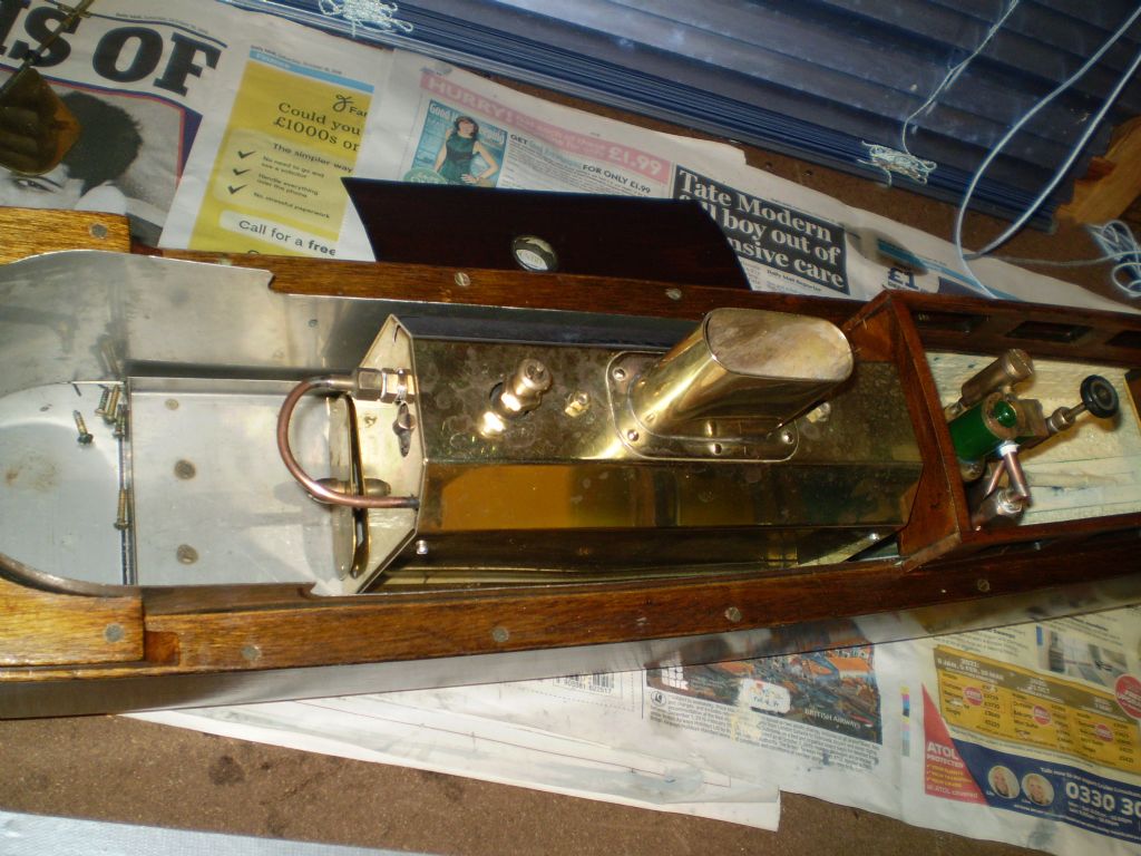

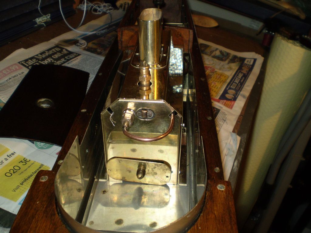

                  I've cleaned up the boat after over 40 years of non use and now would like to get it going on gas. Any suggestions of how I can do this, I've seen these self fill butane micro gas torches which would be idea butpa300359.jpg would like a burner with a separate gas tank.
                  Bob
                  #435322
                  Nigel Graham 2
                    @nigelgraham2
                    A beautiful vessel and heartening to see being brought back into active service.
                    I'd certainly go for gas-firing, so look through what is already commercially available for just such model boilers. These are outside my personal experience but I do know the field is well covered.
                    Try for a start, Clevedon Steam, who appear to have taken on the Cheddar Steam name, stock and goodwill. Other, similar firms may be available!
                    I would not try to build my own gas tank, not for running the boat in recognised model-engineering / model boat events. You can, but the test requirements are remarkably stringent. Have a look at the MELG Boiler Test Code 2018 Vol.3 – and try not to be too frightened. Vol.2 deals with testing the boiler itself, in such scales (<3Bar.litre rates, as I imagine your boat's will comfortably be).
