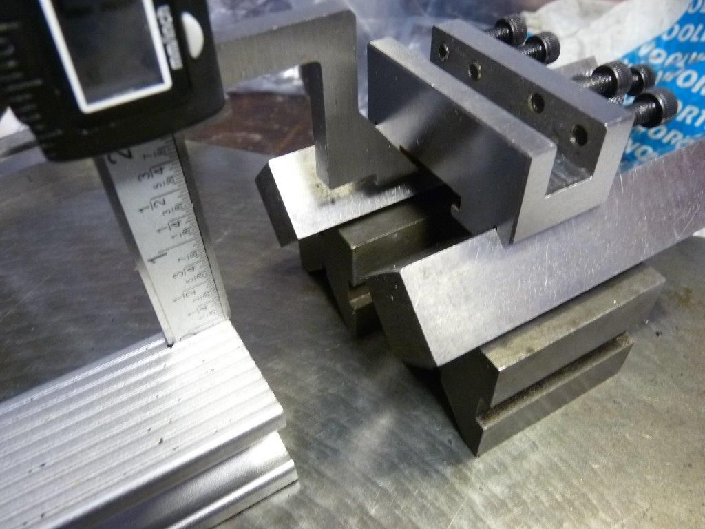

              CotswoldsPhil
                @cotswoldsphil
                Hi All,
                Prompted by this latest thread on QCTP compatibility issues, here is my experience of trying to find compatible holders to extend my usage of QCTH's at reasonable cost.
                I have measured the relative position of the V seating to the working face of the locking t-slot of 11 Myford (T00) sized holders of different brands which I have purchased over the last year. My aim was to try and establish the most compatible pattern holder for my set-up at the least cost.
                I appreciate that my measurement set-up (see photo below) is not to national standards, but it was repeatable.
                The 2 holders which came with the Bison/Toolmex tool-post (and started this whole saga) were used as the reference point i.e. zero. These holders positively locked at approximately 50% on the clam-shell height adjuster. (all measurements shown below are + values in imperial units)
                I have 3 holders sourced from the Midlands Exhibition last year; stamped "M" or "W" these gave relative measurements of 0.013, 0.008 and 0.012 providing reduced locking positions of 25,30 and 25% and just about OK, i.e. reasonably positive.
                I took a punt on a 26mm / 2mm Carbide Parting Blade holder (HBM brand) from RDG and this measures 0.007 with a very positive 40% lock position. This holder has sorted all my parting-off woes – very pleased.
                Based on this positive experience, I purchased a HBM HSS parting tool holder (for use as a screw-cutting tool with minimum grinding) This measured 0.020 with a not very positive 10% lock position.
                Another HBM standard holder measured 0.023 with a not very positive 10% lock position.
                Another HBM 1/2 inch tool holder, measured 0.015 with a not very positive 15% lock position, especially important as it is designed to hold a larger tool at centre height on the Myford.
                These 3 holders are obviously made for the HBM tool-post but there is still a wide variation in my sample.
                Foxed again; I took a punt on 2 holders from Axminster Tools (turned out to be SOBA brand when received), these proved to be even less compatible measuring 0.024 with hardly any locking action, and a whopping 0.038 with no locking action at all. Again these are designed to go with the SOBA tool-post but my very small sample, showed quite a large variation for a precision product.
                All these additional holders are nicely hardened and ground but the variation is very wide, even within the same brand.
                So, I have now collected 11 holders, of which, 6 are usable in my workshop, I'm really thinking I should go back to the 4 way tool-post and be done with it!
                I seem to remember Jason mentioning a lick on a linisher to correct this incompatibility. My next step is to purchase a 1 inch wide linisher (I could do with one anyway) to hopefully fettle the working face of the t-slots in the non-compatible holders. Fortunately, every holder needs metal removed! I think I've worked out a method, but I'll report back later.
                I hope this information may be of use to members. I have no connection with any of the companies/products mentioned and my purchase decisions were aimed purely at trying to find a source of holders compatible with my set-up at a reasonable price. In no way do I question the quality or suitability of the mentioned items in their designed configuration.
                CP

                    #217719
                    Clive Foster
                      @clivefoster55965
                      And suppliers wonder why folk distrust import "the sticker is the brand" tooling. However when it comes to hobby market Dickson clones it was ever thus. Way back when such first appeared at prices that were merely tooth extraction without anaesthetic painful, relatively speaking far more expensive than todays prices, received wisdom was to buy the tool post and all the holders you would from one supplier in one hit, test the fit and send back any that didn't fit well repeating until you had a good set because the chances of getting another batch that fitted really well were slim.
                      Different for proper industrial standard components. I have both original Dickson and two varieties of Italian made Rapid clone tool posts in S2 (or is it T2) size. Far as I can figure out I have at least 4, more likely 6 or maybe more, breeds of toolholder which mix and match with gay abandon and nary a worry as to rigidity. I'm sure I've read somewhere that the tolerance on flange surface position Phil measured is of the order of ± 5 thou for good locking which seems to be pretty much in accord with his results. I'd guess the variation in mine is probably under half that using subjective memories of how far the locking spanner has to be turned before proper lock is achieved. The only tricky variation I've found is that the bottom flange of the height setting bobbin varies between makes with, presumably, corresponding variation in in the mating groove. Maybe 20 thou variation in my samples, sufficient to make fitting problematic in some cases, but reducing over thick ones to a suitable depth is trivial.
                      The double Vee alignment set-up is remarkably tolerant to manufacturing errors. Way back I had to analyse the contact geometry for another purpose and still have unfond memories of the resulting headaches. Unfortunately the critical dimension measured by Phil, what might be called effective lock flange depth, is more difficult to verify.
                      I'm impressed by Phils efforts but think that it might have been better to sit the holder Vees on a pair or round bars and use a dial indicator to measure the drop of a weighted or spring loaded "T stud" sitting in the locking slot. Especially when you need to check the effect of modifications. Round bars of suitable diameter give line contact along the middle of the Vee which is probably more repeatable than square or rectangular ones sitting on the whole Vee although the results will clearly be misleading if the Vee faces should be concave. Fortunately that particular error can be found relatively easily by other means. I've always found using a height gauge in the way Phil does to be a little subjective as tiny tilts of the base can easily be missed leading to thou class errors. Its also difficult to get into the middle. A T device can be slid to any position in the slot easily enabling slant errors to be detected. As relative rather than absolute dimensions are needed a lever type indicator should do fine.
                      Of course Phils way makes effective use of components to hand whilst my way needs stuff to be made. That said I'd like a bob or two for every time I've improvised 'cos its quicker than making and wasted considerable time before finally giving up and making the right gear. Having passed 60 I've finally realised that doing it right is almost invariably quicker. Maybe in another 20 years I'll translate that realisation into action every time! Sure didn't manage that last Wednesday.
                      Clive.
                      Edited By Clive Foster on 24/12/2015 21:19:58

                      CotswoldsPhil
                        @cotswoldsphil
                        Hi Clive,
                        I'll try the round support method and see if I get any variation – thanks for the tip.
                        What I find difficult to understand is how any manufacturer can continue to put out such a wide variation in what is a standard product and that it appears to be acceptable to the distributors. Surely distributors have some say in the quality / conformance to specification of the product they sell.
                        CP
                        Edited By CotswoldsPhil on 24/12/2015 21:28:58
