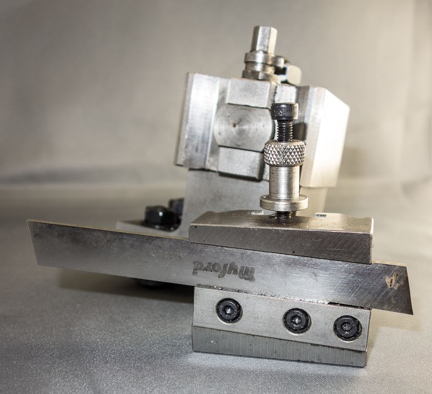

                  No Tim , as Peter says don't modify your holders. The advantage of the QCTP ( mine is the "conventional" type) is that you have a holder for each tool ( I have 15!! ). You set each up to be on centre height then just change between tools as required.
                  Regards
                  Norman

                      That's a nice collection you have there Norman. Not seen an upside down parting tool holder like that before, did you make it or buy it?
                      #217590
                      NJH
                        @njh
                        Well spotted Vic! I have another QC tool post that mounts on the back of the (long) cross slide and the "upside down" parting tool is fitted there. Parting is thus achieved by "withdrawing" the cross slide. Having parted off then the conventionally (front) mounted tool can be used for the next item. (Tool post, holder and blade were purchased )
                        Bazyle yes I agree it is more usual for it to be positioned 90 deg C/W but this photo was taken for a thread many many posts ago just to demonstrate my (bodged up!) mounting for a dti for setting up 4-jaw work.
                        As to "economising" on the number of tool holders yes you have a point but having the tool you need ready mounted saves time and frustration.

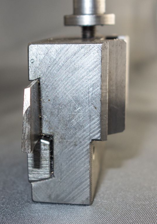

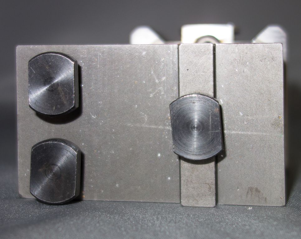

                                                      For Vic's benefit- but maybe of interest to others also here are some pictures of my rear tool post QC parting arrangement.
                                                      As you can see it is a substantial item and fits firmly to the cross slide by a three point attachment. It does need to be the long version cross slide to get it all on and still leave room to work. If not carrying out parting on a particular time the tool can be removed or maybe a chamfering tool could be added to ( yet another ) toolholder.
                                                      As far as the source of the tool holders they are either Myford originals or Chronos I think. ( Always a useful item for those who don't know what to buy you for xmas etc.)
                                                      As KWIL says if you are going to have quick change tooling ( and I certainly recommend it !) then there is no point in economising on the number of holders or it becomes "not so fast change"! I'm not so sure about 52 holders though ! That risks becoming "Quick Change Once You Can Find It " ( In my workshop anyway !)
