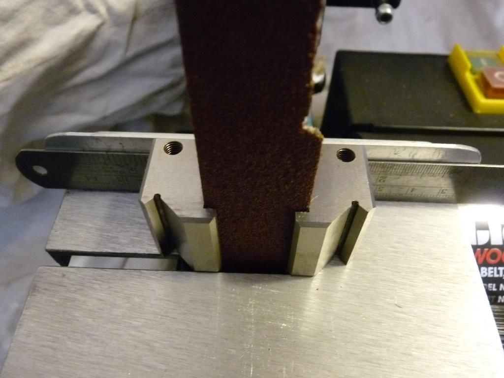

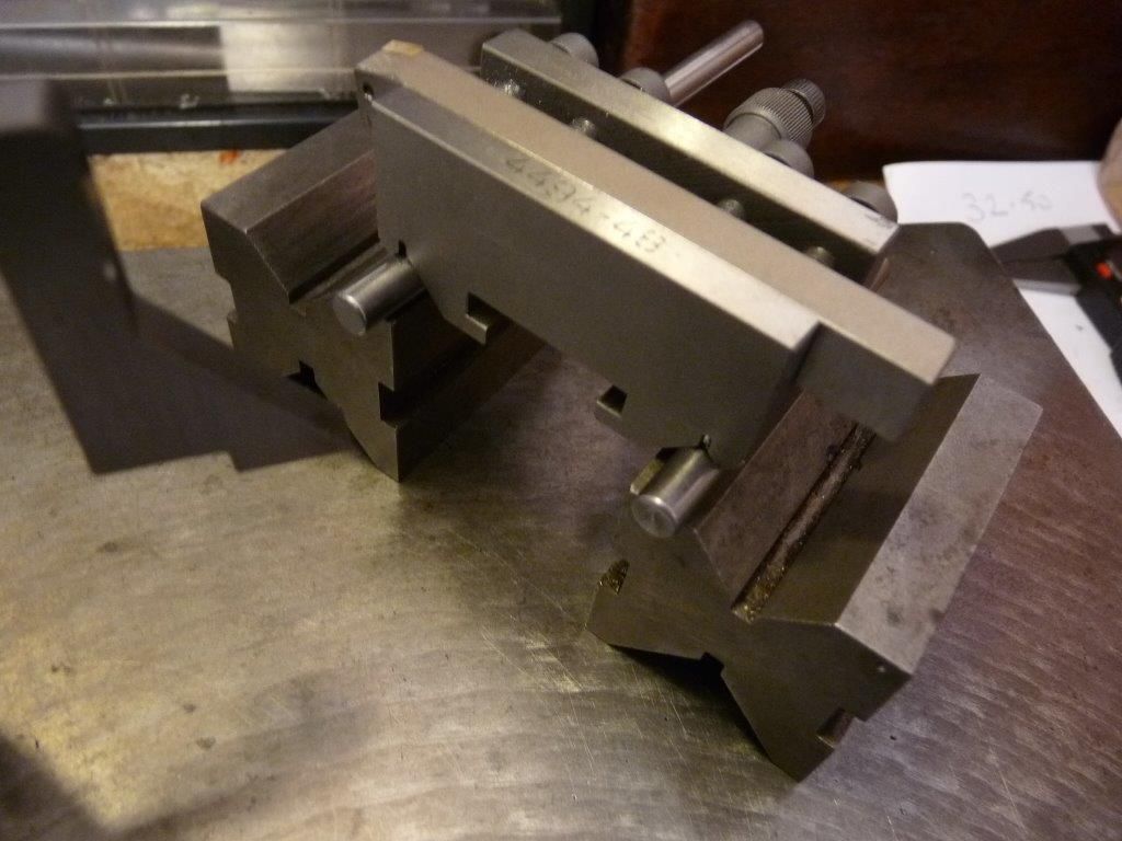

          I'm back with some more information which might be of interest.
          Just managed to upload the 3 photos after 3 attempts…so here goes.
          Clive Foster suggested that I use round bars to support the holders whilst measuring, I can report that all the measurements made on round bars were within a couple of thou of the first set, where I used ground square bars supported in matched v-blocks. (see earlier in the post)
          This alternative set-up did allow me to check the location of the v's by measuring the width across the two bars (short lengths of 1/4 silver steel) and subtracting one diameter, the result (4 different makes of holders) was all within +0.03mm to +0.08mm of the 48.00mm stated specification for the T00 sized block.
          I've just bought and modified a 1 inch linisher (from the big red and black tool-shed) to do the work (yes, the slot is 1 inch wide – how lucky is that) and so far have fettled the worst of my errent blocks so they now lock positively at <> 50% on the cam as per the original Bison blocks – result.
          The linisher, as bought, needed a thinner belt platten to get the belt into the quite narrow groove, a guide/stop and suitable shims were required to set the cutting depth. A little piece cut-out of the side of the belt was needed to feed the block into position. The resultant simple grinding procedure was done from both sides to reduce any potential error. I know that the slots are not absolutely true, but the blocks were essentially scrap and now they clamp-up very well. Fitting a new abrasive belt, now that I have fixed the worst offender(s), should improve the precision of the slot as lighter cuts will suffice on the remaining holders.
          My ruler just happened to be the correct thickness to set the depth of cut for this holder.

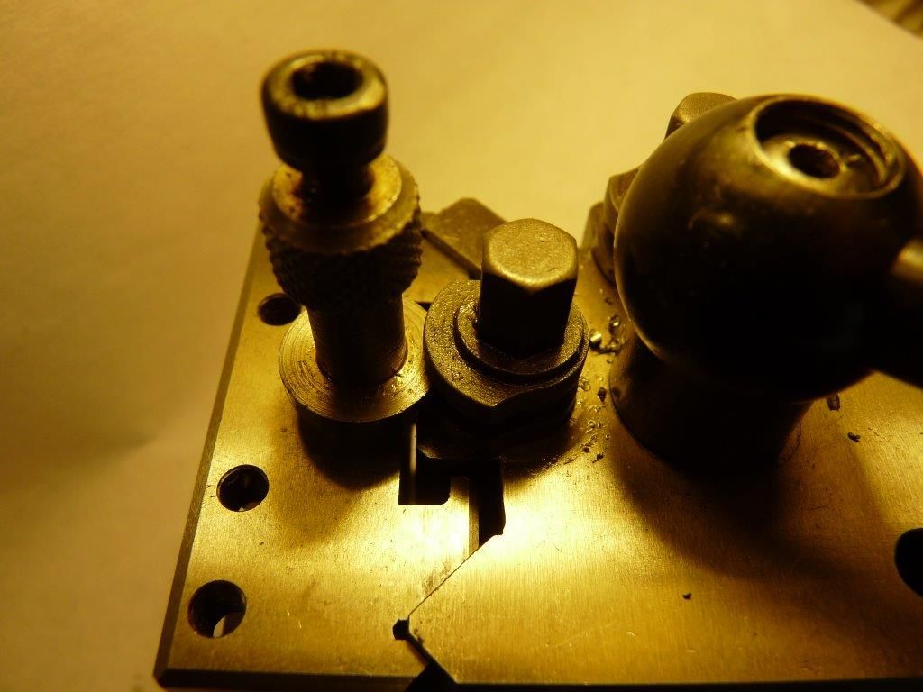

          Based on potential savings over original Bison blocks, I'm quids in. Although I still wonder how manufacturers produce precision v groves to the tolerances shown above, but are unable to get the clamping slot anything like correct for a T00 QCTP, clone or otherwise. The worst case for me, needed the best part of 1 mm removed – the holder as delivered only just slid onto the block.
          This is the holder that would only just slide into place – no locking action at all, now after grinding, a nice positive 50% lock position.
          Michael G's remarks on what are acceptable quality levels rings true – here I am, happily sorting out a very obvious manufacturing error, the distributor being unaware unless they follow the forum.
          When is a T00 QCTP not a T00 QCTP – when its a clone.
          Phil
          Edited By CotswoldsPhil on 28/12/2015 19:33:12

            Well done Phil. Really glad you have a good result by decently simple means. I'd probably have splashed out on a good carbide centre cutting end mill, machined down the back face to get a flat flange at the right position then screwed'n glued gauge plate flats on to make a new Tee slot with the clamping surface in the right plane. Tapping might have been a bear if the material was the near tools feel used on industrial rated holders.
            Round bars make it easy to check both the Vee spacing and parallelism of the Vee axes. Also work well to check that the clamping side of the T slot is parallel to the planes of the Vee. Would have put money on the error being due to planes of the Vees and T slot clamping plate being mutually out of parallel rather than the absolute dimension error you found. Out of parallel is the likely error if you get a bit careless with simple grinding set-ups. The dimensional error you found is basically not watching wheel wear so failing to make the necessary compensation. Which basically says the makers know that the production process is designed to produce out of specification parts and just don't care. A couple or three thou variation is plenty for finish grinding. 40 thou / 1 mm is beyond outrageous. Wonder how much error is on the Vees and how much on the T slot flange as wheel wear errors will be additive. In series production its always good if you can make tooling wear and other errors roughly opposite rather than additive so things tend to cancel out.

                  I'm not intending to make any holders, my aim was to check the dimensions of the 11 commercial holders I have, 5 of which don't fit my tool-post at all because the clamping slot is too shallow. Checking the width of the V's was just a side-show and proved that any poor fit was not due to manufacturing errors in the V's.
                  The only metal I'm cutting is to increase the depth of the existing slot to make them usable i.e. able to clamp-up positively. With the set-up shown, I've been able to establish how much needs to be removed from each errant holder to get them to fit.

                        Posted by John Hinkley on 29/12/2015 12:25:36:
                        I don't want to labour the point, but, before you go about re-machining or re-grinding the vees, have a close look at the clamps. My original ones didn't do the deed properly out of the box. I ended up making new ones with a (VERY slightly – like gnat's kneecap) thicker width to the clamping bit. (I'm sorry, I can't think of a better way to describe it!) That did the trick. The thicker clamp pulled the tool holder closer to the vees, bearing in mind the rather limited movement provided by the eccentric pin.
                        Hi John,
                        I have no intention of touching the V's. The are nicely ground and accurate as far as I can measure. All my measurements have been to establish how much to remove from the working face of each clamping-t-slot (all 5 are different and too tight) to allow the clamp to operate in its correct position, which seems to be the opposite of your situation. The original Bison holders are a perfect fit, so redoing the clamp is a non-starter, I would then have 2 Bison holders that are too loose. My aim was to have all my clone holders clamp to the same position as the Bison's.
                        If you take a look at the linisher set-up (a couple of posts back) you will see the method I have used to relieve the slots. I set the measured discrepancy with a shim, in this case 0.0315 inch (the worst one) and conveniently the thickness of my ruler, between the fence I made and the holder when the working-face of the slot was just touching the belt. Everything was set-up square beforehand – table / platten / fence / belt tracking. I removed the shim and linished away, until it all sparked out, having turned the block over about a couple of times to even out any potential errors.
                        I've just completed the rest of the holders this afternoon (much less metal to remove) and all is now well in my workshop, having 11 usable holders, instead of a pile of scrap.

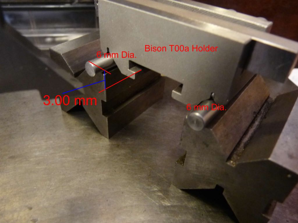

                                A final bit of information (for those not bored silly) about the dimensions of the Bison QCTP and compatible holders.
                                I decided (for reasons unknown) to rest an original Bison holder on 6 mm bars (instead of 1/4 inch as previous) to locate the bottom (working-face) of the t-slot relative to the V's. Working in metric, to my surprise, I got exactly 3.00 mm; is this a coincidence or designed?
                                Phil
