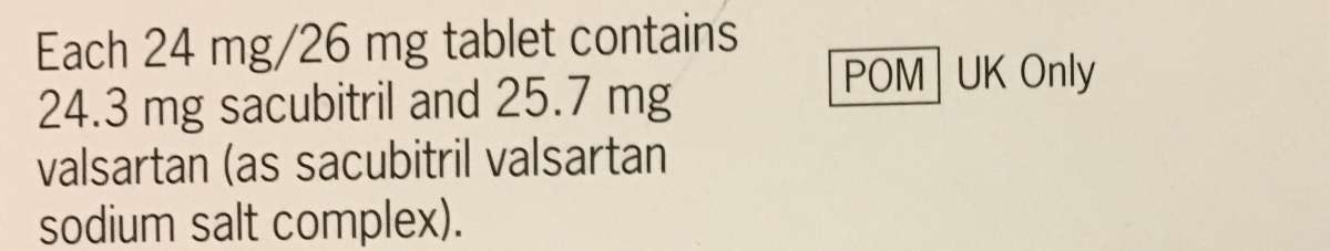

        Looks perfectly fine to me. Correct rounding down & up and indication that the tablet contains 24mg of one drug and 26mg of another.

                    Thanks for your explanation, Robert … although I remain not entirely convinced
                    The dual marking just seems to add ‘noise’
                    [still taking the tablets]
                    Ref. https://bnf.nice.org.uk/drugs/sacubitril-with-valsartan/

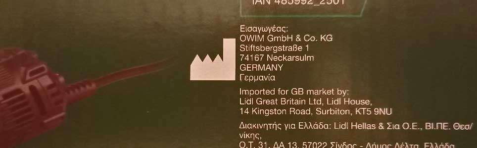

                                        Parkside are being disingenuous. I don’t have the die grinder to hand but I know it had a solid white factory symbol and a German address on it. On MEDICAL devices a solid black factory symbol indicates the manufacturer. I do have a Parkside digital caliper to hand. It also has a white factory mark. In this case the instructions say the German company is the importer and the manufacturer is in China.
                                        I’m very confident the die grinder was made in China as well but will check when I get a minute.

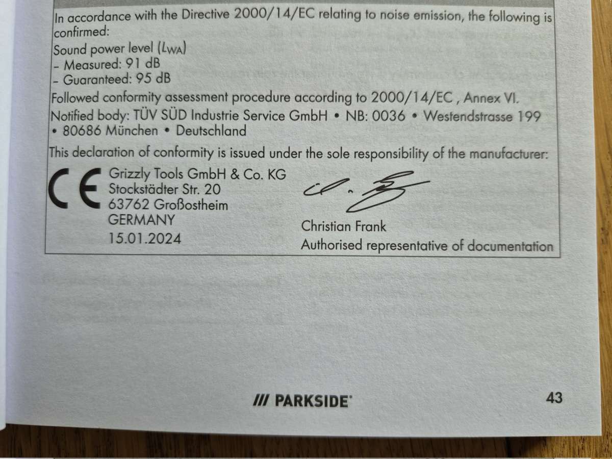

                                          I got the die grinder out. Parkside are being VERY disingenuous.
                                          lidl-die-grind
                                          As I said before, under the medial stndards for CE a solid factory symbol (usually black) denotes the manufacturer. The hve put a white factory symbol next to a German address. This implies it was manufactured in Germany.  However there is some greek (literally) above the address that when translated says “Importer”.
                                          Why greek? Because this is the UK version with a BS 1363 “13A” plug. They use this plug in Cyprus.
                                          While it is not a leagl requirement for the country of origin to be declared on this type of goods, it is illegal to deliberately or recklesly mislead consumers over where an item is made.
                                          I consider this misleading. Unlike the plastic digital caliper the manual says nothing about the country of origin.
                                          I was also a bit disappointed to discover the 3.2mmcollet is in fact just an adaptor thet goes inside the 6mm collet.
                                          The declaration on vibration is interesting. Very precise at 0.709 m/s2. Shame the uncertanty is 1.5m/s2
                                          Measuring to the nearest thou with a ruler marked every 1.5″.
                                          Robert.

                                                The CE mark does not, and has never, implied that the item is made in the EU. And the factory symbol is not, in any way , a part of the CE mark.
                                                All items sold within the EU do have to supply the name and address of the ‘responsible person’ which would usually be the importer. But I don’t think that information has to be affixed onto the item. Many Chinese manufacturers supply the name and address on a paper leaflet in the packaging.

                                                  I certainly agree the device labeling is disingenuous, but ‘deliberately and recklessly’  might warrant a slightly higher test.
                                                  They do not claim the tool is made in Germany ( that would fit ‘deliberately misleading’ ), but they do not state where it is made for some reason (which might be ‘reckless’ if tools from a particular country posed a hazard, for example).
                                                  I also find it disappointing that stating country of manufacture for an item is not a legal requirement. I am sure it was once.
                                                  #833812
                                                  Robert Atkinson 2
                                                    @robertatkinson2
                                                    That would be “deliberately OR recklessly” not and. I don’t know which it is but using an icon used in another directive to indicate the manufacturer next to the german address (in english) of the importer with the label “importer” in greek  above it is certainly one or the other. Why would you use a factory icon for an importer.
                                                    IIRC the requirement for country of manufacture was dropped wenf CE was introduced. I think the reasoning was if it meets thee standards it shouldn’t matter where it is made. It’s also an equality issue.
