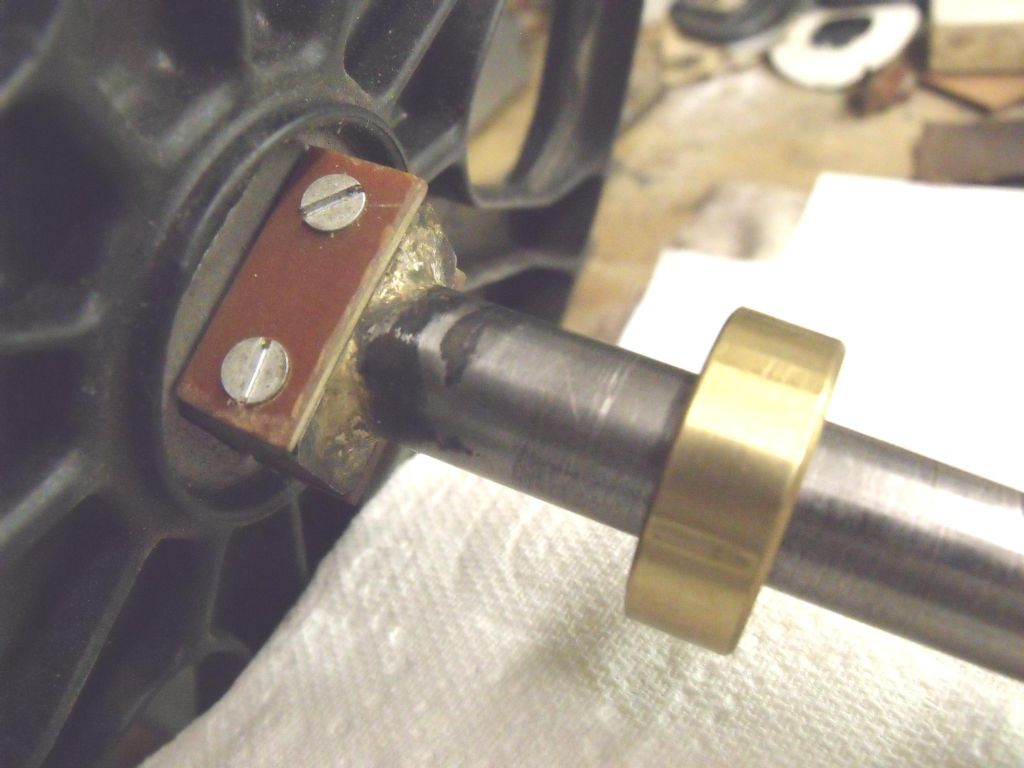

                                Stuff it with Plasticine inside some cling film or a plastic bag ! Though it would be much easier to use a wood plug and a nut and washer through the middle.
                                This is how I did mine ! It is an old pulley from a washing machine. !
