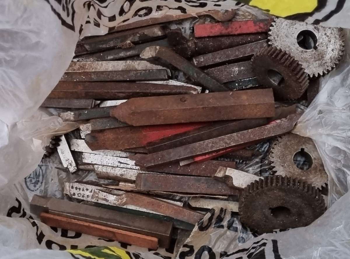

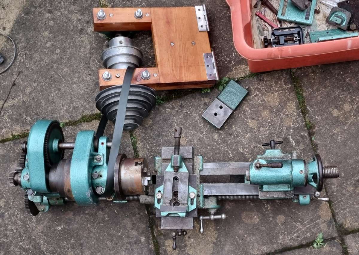

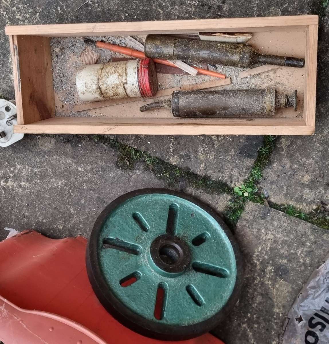

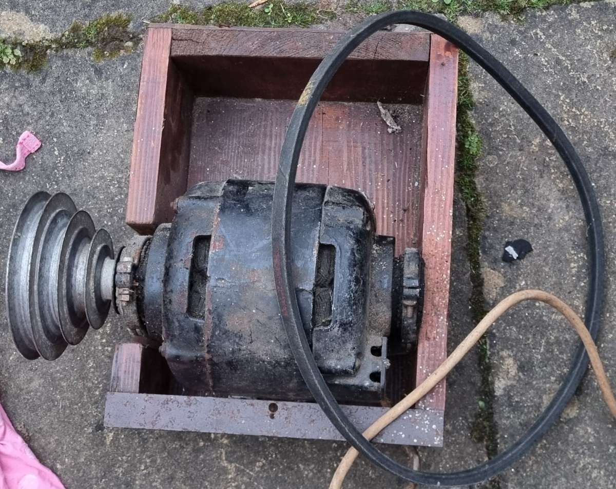

      Hello model engineers!
      I have recently come into the possession of a lovely ZYTO mini lathe. I am, however, very new to model engineering, and so have no idea of how to construct the lathe or even if I have all the parts. I can’t seem to identify it beyond the big “ZYTO” on the side, and a small metal plate that I think says “T357”. Just posting here to ask, does anyone have ideas as to what this is, and if I have everything? I’d like to try and get it up and running (I’ve ran it once, but by holding all the pieces far apart so to properly tension the belts), but my expertise is very limited.
      Best Regards.
      theshonkymachinist
      20250202_164134-min20250202_164152-min20250202_164201-min20250202_164207-min

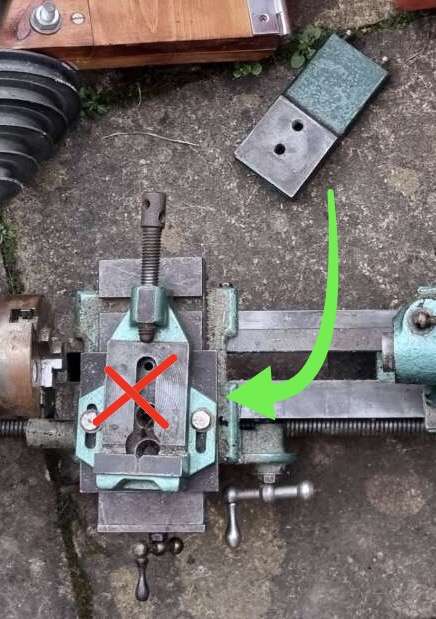

            The first rather odd thing about your lathe is that it currently has a vice mounted on the cross-slide … which might suggest it was last used for a milling operation.
            It would be worth checking the loose parts to see how much of the top-slide assembly you possess.

              Lathes UK will provide more information.
              the wooden piece with hinges looks to be the countershaft.

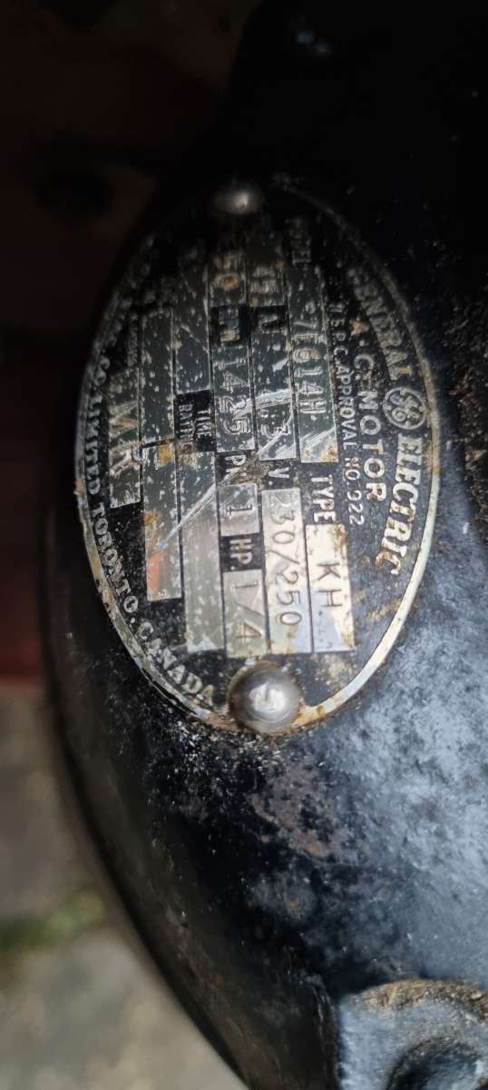

              The motor having been made in Toronto, and a little battered, may very well be old.

                The “T357” is probably a serial number, which MIGHT allow you to find when it was made.
                Yes, I noticed that a vice is mounted (To my mind, the wrong way round) on the Cross Slide.
                If the paintwork is anything to go by, it looks to be in reasonable condition.
                Explanation of the gears and their uses, can wait until you have a little more experience, as can the many tools with the lathe.
                By moving the belt between the pulleys on the motor and the counter shaft, you can vary the speed. Moving the belt across the pulleys in the countershaft and the spindle will provide another set of speeds.
                It looks as if, in total, you have nine possible speeds available.
                But be wary of using the highest ones. The spindle might well be running straight in the cast iron of the Headstock, and so not be suitable for sustained high speeds.
                Use oil to lubricate the bearings, rather than grease.

                  Can you set out the loose parts and photograph them? That will help anyone here help you identify them.
                  Fior exanple: the small rectangular block on the ground between the lathe and red box in the first photo, seems to be the top-slide so you need know how complete that is. It should contain a screw with a bearing and handwheel and those might be loose in the box.
                  Those gears with the key-ways are likely the “Change-wheels” used in various combinations for cutting screw-threads. The numbers stamped on them are of their teeth-counts, used in working out which wheels for what threads.
                  You’ve a goodly collection of tools there, probably all High-Speed Steel, so you’ll need a bench grinder for resharpening them, with introductory books on turning explaining their shapes.
                  Though those things in the wooden box look like grease-guns, lathes like this are normally lubricated with a light oil.

                    The motor has a 5 step pulley, the counter shaft a 4 step. Measure the steps and try to align so they are equal, biggest and smallest on each pulley the same. This will make changing speeds easier. Good Luck. Noel.

                      Try to see if you can assemble the Top Slide from the bits in the box, and the part lying just beside it.
                      If you can, you will find that a top Slide allows you to produce chamfers and tapers (Useful for trimming up centres before use).
                      Eventually, you will want to use the changewheels to provide a power feed rather than traversing the Saddle by hand. But don’t rush, until. you feel ready.
                      When it is finally set up, you will have useful little machine.

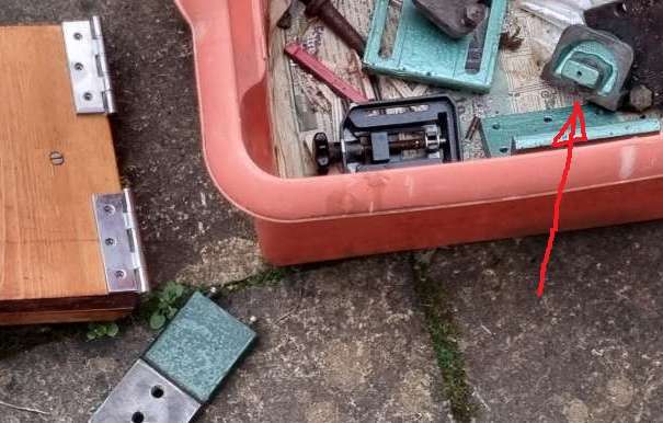

                        Hi, one thing I think you will find, is the piece I’ve shown with the red arrow, is the moving jaw for the vice, which is on the cross-slide that MichaelG has mentioned.

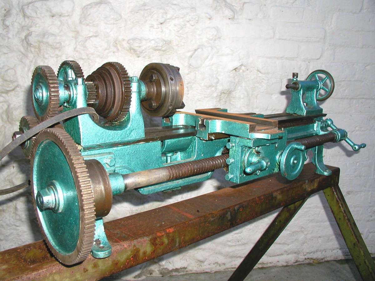

                            There must have been a year when green Hammerite was the height of fashion – I have a lathe vandalised like this. The topslide base can be seen in the wooden box but teh screw may have gone for a walk.

                              Hi Bazyle, I guess you must be right about the green paint, as I have a lathe that I bought  many years ago, that’s almost smothered with it.
                              good09
                              Regards Nick.

                                Adding to Noel’s point about the pulleys, the shafts should of course be parallel and the opposite flanges in line. On a lathe like this it is normal to have a two stage transmission but always a step-down from the motor to the countershaft (I think it’s about 3:1, maybe 4:1 on my Myford, which has a single motor and c/shaft input pulleys) then the countershaft / spindle pulleys to give a useful range. The centre pair normally is of equal diameters.
                                I take it the rather complicated covers etc. behind the chuck hide the back-gear. That is an extra low-range for screw-cutting and for turning large items on the faceplate. NB: Tempting though it is, the back-gear should NEVER be used as a spindle lock when unscrewing a chuck that has tightened itself onto the spindle nose thread, as they like to do. That practice is almost guaranteed to break the gear teeth.
                                Those Tee-slots in the saddle are a bonus, allowing a range of accessories to be used, and providing for “boring between centres”, for producing relatively long parallel bores such as in model engine cylinders. Remember that Tee-slots are relatively fragile on any machine-tool so need care to avoid jacking against the underside of their flanges.

                                  Hi, looks like my picture is not working, so I’ve tried it again.
                                  Photo#Zb

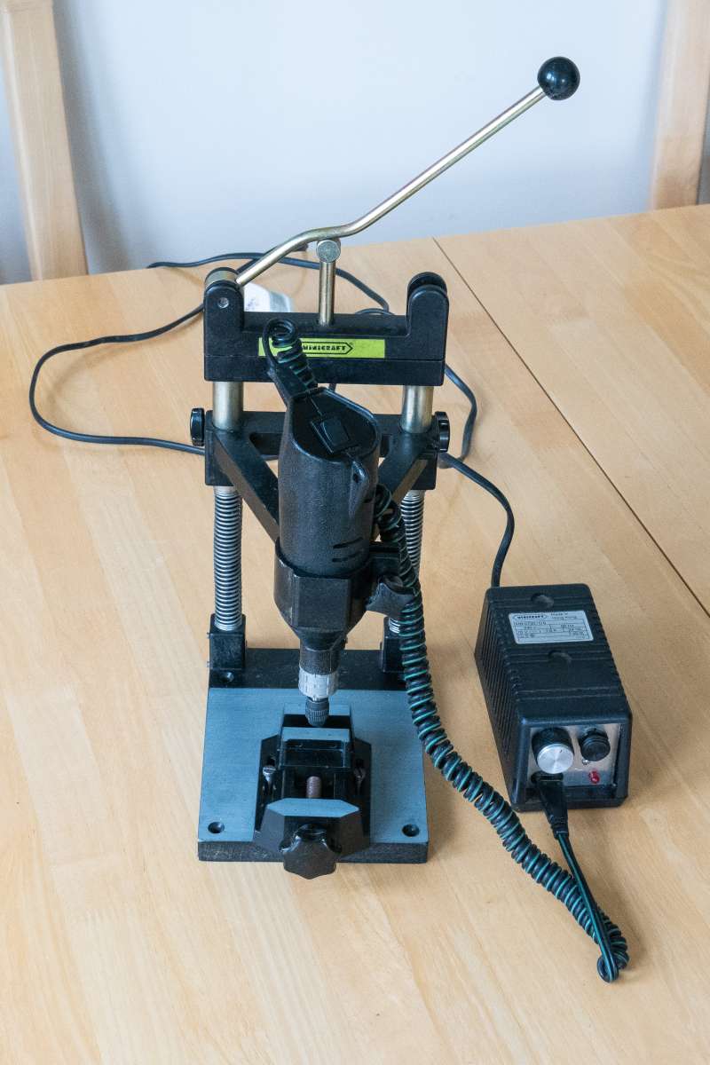

                                  I’ve also got a vice like the black one that can be seen in the left hand corner of the box, it’s not what you would call precision, but it’s handy for holding and drilling small parts that don’t need a high degree of tolerance. It came in a box of other stuff that I bought at an auction.
                                  Die Cast Vice 1
                                  Die Cast Vice 2
                                  Regards Nick.

                                    Nick, the vice is a Minicraft like this:
                                    a minicraft
                                    I’ve also got a mini jigsaw and orbital sander which plug into the transformer, all of which I inherited

                                      Hi Rod, thanks for that information about the vice.

                                        The vice may have been a makeshift toolpost judging by the size of some of the tools.
