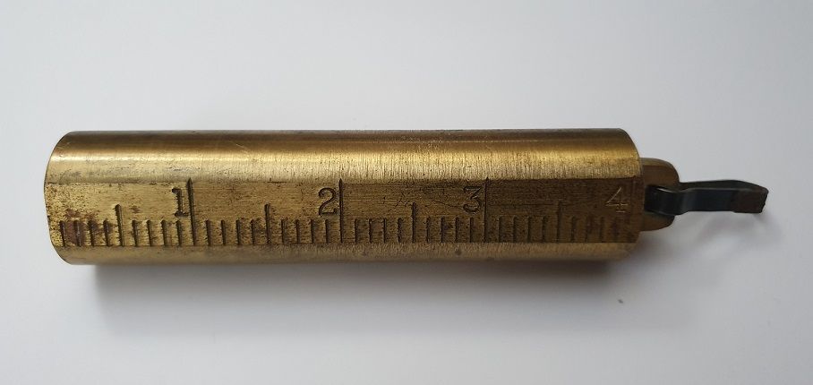

      Look what the dog dragged in
      #487357
      Brian G
        @briang
        Last night my dog was frantically trying to get this out from under a cabinet (I think he believed it was a rawhide cigar). I guess it rolled under there when clearing my father's shed and has lain there in the dark ever since. There are no markings, not even a broad arrow, although I wouldn't be surprised if it came from the 'yard.
        The body is a solid brass cylinder 1" in diameter with a black clip attached to a square loop at the end. One side is flattened and marked from the bottom up to 4 inches in tenths. I doubt it is intended as a weight as at 15 1/2 oz, it doesn't lend itself to calculations.
        Any ideas?

          Could it be for measuring the level of the remaining liquid in the bottom of a liquid (oil) tank?

            Perhaps part of a dip stick or some thing like that . So, inches convert into capacity (surface area) in a tank or perhaps it establishes a level 'down below some where'. Maybe not, not sure having written it.
            Perhaps reads some thing from up above. Float on one end………………just a thought

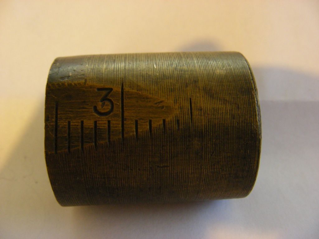

              Reminds me of this bit of brass that an ex-dockyard friend gave me years ago:

                I did wonder if it was for checking bilges, but thought that 4" was a bit optimistic.

                  Posted by Rob Thomas 4 on 24/07/2020 12:46:36:
                  Regards,
                  Rob
                  Very likely. Ships and commercial operations take fuel by the ton and the huge quantities involved provide many opportunities for dishonesty. The remainders at the bottom of a tank are called ullage, and the cumulative value of ullage is big money. 75mm of oil left at the bottom of a small 20m diameter tank would amount to nearly 2.4 cubic metres of fuel, roughly 530 gallons, and the tank might one of dozens each emptied several times a year.
                  Tanks were frequently dipped at all stages of fullness, even those notionally empty. A small weight on the end of a line is a good way of dipping empty tanks. At least two types of fraud prevented, stealing left-overs or using an empty tank to collect fuel misappropriated from other tanks. One way of profiting from privated collected ullage is for a road tanker to arrive, do the paperwork at the gate, pretend to unload into a tank already full of ullage fuel, and then leave – still full – for private sale. Fuel isn't physically stolen from the big tank – instead the owner pays for fuel that stays in the road-tanker, while his trusted employees retire in comfort. (Or go to jail!)

                    Indeed, it is the end of a sounding tape for manually dipping fuel (not cargo fuel) tanks. The tape was metal and graduated in inches, taking over from the graduated brass weight. The tape was wound on a reel.
                    Bilge sounding rods were usually thinner brass rods (1/2" or so diameter) about 12" long and the 'tape' was a rope. This was just coiled up after use.
                    At the bottom of all sounding pipes was a disc welded to the shell plating and due to the continual speedy lowering of the weights, this disc would quite quickly become pitted. It was not unknown for the weight to become detached from the tape and lodge at the bottom of the sounding pipe staying there until the next drydocking! Needless to say, spare sounding tapes were always carried on board.

                        Yes, most probably a fuel tank/bunker sounding weight of some sort. IIRC there was a green paste to smear up the side of the weight which turned red in the presence of water.

                          It looks like the internal sliding part of a device for measuring a volume of powder, such as that for reloading cartridges; although larger.
