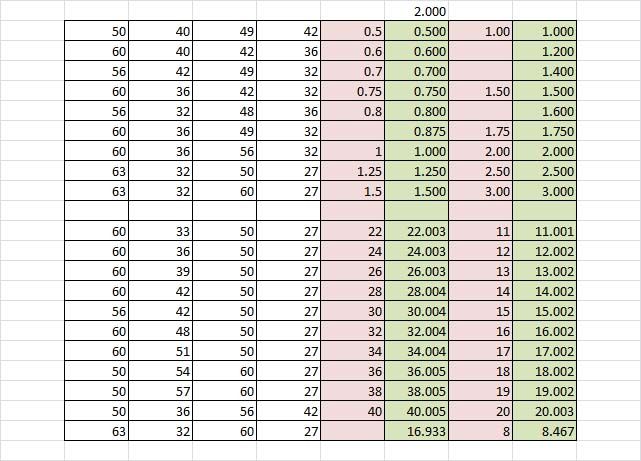

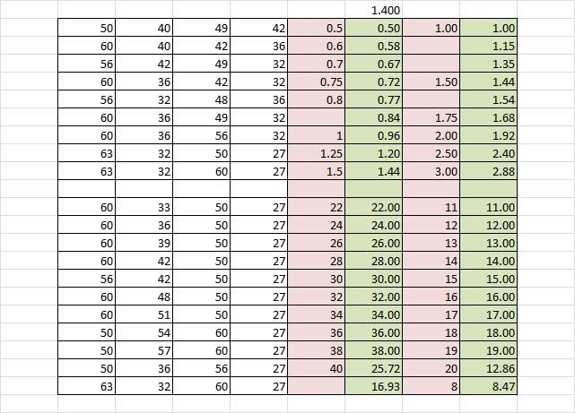

      Thats better! With a 24/50 pair (threw me for bit there John) and a 1.4mm pitch leadscrew we get:
      The imperials are exact and the metrics improved. Interesting way of doing it!
      Rod

        Just one awkward question: How do you reconcile 1.4mm pitch with the 'measured' 13tpi
        … Is it the effect of that two speed-gearbox ?
        #208401
        Roderick Jenkins
          @roderickjenkins93242
          Posted by Michael Gilligan on 18/10/2015 21:49:15:
          I can't make it work with a 2mm leadscrew frown

                    I think MichaelG is correct, there is further translation gearing associated with the 2 speed lever. A 2mm pitch leadscrew seems to fit with Naughtyboy's measurement. This, together with introduction of 20:14 (or similar ratio) gears gives a very good result:
                    I've added the third place of decimals so we can see that the metric gears are now exact and the imperials are very good approximations. If this is how the gearing is arranged then hats off (and apologies) to the designers!
                    It really needs a 30 tooth gear in the train to give a reasonable 8tpi.
                    What a fun puzzle smiley
                    Rod
