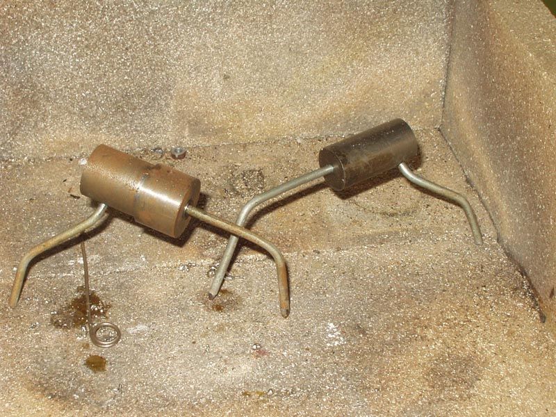

                            wheeltapper
                              @wheeltapper
                              I use these things to hold small parts when soldering, I have no idea where I saw them or I would credit them,
                              just an odd lump of round with two legs and a probe, the weight of the lump holds things in place.
                              Roy
