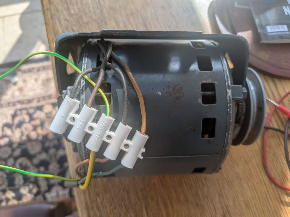

      I’m after some help understanding the wiring of a 240v ½ HP electric motor which doesn’t behave quite the way I was expecting.
      I recently dug out an old small ¼ inch chuck pillar drill which I bought second hand as a stop gap about 30 years ago while renovating another small pillar drill. I’ve used it occasionally ever since, but recently decided to clean it up and put it to a new use. The motor is about ½ HP and I would guess is about 60-70 years old and painted a standard grey. Unfortunately, the motor has no plate on it or any markings at all. The wiring and plug needed replacing and when uncoiling the insulating tape over the connections I noted that there were 4 wires coming out of the housing in two twisted pairs.
      Yellow and Black (These were originally connected to 240V and used for years and Red and Black (These were unconnected and insulated)
      There is no external capacitor or evidence of a capacitor in the casing and when switched on with the yellow and black connected to 240V the spindle historically always rotated clockwise (looking at spindle) from a static start. There is no sound of a centrifugal switch operating.
      I put a meter across the two pairs of wires to try to understand what was going on and got the following
      Yellow – Black = 14.5 ohms
      Red – Black = 21.0 ohms
      So two independent windings as there was no continuity between the two windings or with the chassis.
      I connected the yellow – black to 240v again and checked the rotation speed = 1490 +/- 3 RPM in clockwise direction, but I also found that I could get it to rotate in either direction if I spun the motor first.
      I connected the red – black to 240v and measured a rotation speed of 1490 +/- 3 RPM. However, I stopped the test quickly as there was a smell of hot windings and the casing was warm to touch. When it had cooled down I quickly checked rotation direction and could get it to rotate in either direction if I spun the motor first.
      Ideally, I want the motor to be reversible and ultimately, I want to put some speed control on. Can anyone tell me what type of motor I have? Why it runs on just two wires with no apparent capacitor or use of a start coil? What the red-black terminals are (?120V?)? if the hot winding smell on the red-black winding is just 70 years of non-use? Whether I could make it reversing and which terminals I should be connecting? If there is likely to be something missing on the motor.

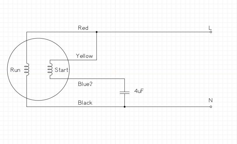

          If the black wire on the yellow winding is dark blue, and the motor is British, then this is probably a “capacitor start and run” motor.   (Guessing: there are at least 5 different types of single-phase motor.)
          Try this circuit:
          spmotor
          The 4uF capacitor is as suggested by Robert.  The optimum value depends on the motor and is unknown, so a guess is necessary.   Reversing done as he said.

            The wiring suggested by Dave is for a permanently connected capacitor motor. Different animal to a Capacitor Start and Run which has two capacitors, one for start and one for run.
            As I understand things the run capacitor effectively turns it into a “sort of” two phase motor and is usefully more efficient than a common single phase motor at its rated speed and load.
            Unfortunately the fixed single capacitor variety are usually tightly tuned to a specific speed. Generally they don’t like varying loads or speeds. Starting torque isn’t great either. The permanently installed capacitor is tuned to give a phase shift for maximum efficiency at the operating rpm, not to boost start.
            Usually found on fans and similar devices with predictable loads and modest starting torque needs.
            I’ve run a couple on drill presses before and found they tend to get very hot if the speed and load shifts outside its rated value. Melted the second one when I left it running (bad boy!) off load for a couple of minutes whilst distracted. Got way too hot to touch and never worked well again. Shame because it was really nicely engineered with a smart cylindrical body and spider mount. Clearly a fan motor. Very cheap from Bulls surplus in Croydon.
            Clive

                    Thanks for all your comments. Your questions made me look again at the wire colours, and I can’t see any hint of blue, they both look black to me unless the colour has oxidised over the years (see picture).
                    240v 0.3hp
                    However, in the bright sunlight I did notice very feint inscriptions on the casing. (Only goes to show you can never look at something long enough!). I finally managed to read these as follows:
                    General Electric
                    Model 5KH29 GG16A     HP1/3    PH1
                    CY 60/50   Volts 230    Amps 1.5/1.85
                    Temp Rise 40C          RPM 1725/1425
                    Time Rating Cont                   CODE R/S
                    PTU      GFJ 1445                 Made in USA

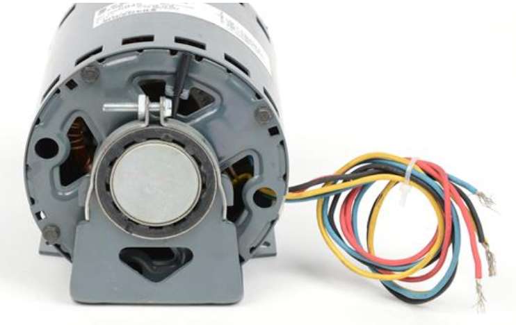

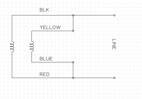

                    I did a quick google search and found the following:
                    5KH29GK6845 Marathon Electric Thermally Protected AC Motor (Motor looks very similar to mine with 4 wires red, black, yellow, blue)
                    The Marathon Electric 5KH Series Thermally Protected AC Motors come in a variety of shapes and sizes. This series offers several different horsepower options, as well as thermal protection. The 5KH series comes with permanently lubricated bearings.
                    The GK6845 is 1/8HP 125V so not the same., but the series looks identical in construction and appear to be obsolete

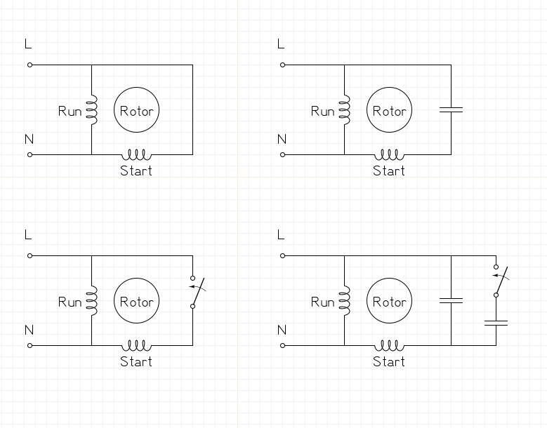

                                Mucho confusion about single-phase motors!  Clive picked me up for saying I thought you have a “Capacitor Start and Run” motor,  If so, my book is wrong!  “Capacitor Start and Run” is not the same as “Capacitor Start and Capacitor Run”!  Modern parlance may be clearer: what I call “Capacitor Start and Run” is a PCM (Permanent Capacitor Motor),
                                I prefer to understand and explain, if I can, rather than rely on hazy memory and experience.  Electric motors rely on two magnetic fields repelling or attracting at the right time so that a rotor turns.   Quite easy to arrange with a DC motor, or a 3-phase AC motor, rather difficult in a single-phase motor.  A single electromagnet flips North/South 50 times per second so the rotor doesn’t move, even though the electromagnet induces current in the rotor coil.  The two currents are in phase, and unless something unbalances it, the rotor just vibrates slightly and gets hot!  By imbalance I mean “shifts the phase / relative timing of two magnetic fields”.
                                Spinning the rotor mechanically creates the necessary imbalance: once the rotor is moving, the magnet fields are out of phase, and attraction/repulsion occurs.   Rotor speed is locked, with some slip, to the AC frequency of the power source, hence 1725rpm @ 60Hz, and 1425rpm @ 50Hz.
                                There are several ways of creating the imbalance needed to start a single-phase motor, and it may also help to reinforce the imbalance even after the motor is running.
                                Here’s 4 different examples, note the basic similarity.   They all have a run winding and a start winding.  The start winding is arranged inside the motor at an angle to the run winding.  This creates the necessary imbalance, but exactly how the start winding is managed varies considerably:
                                spmotorexamples
                                Top left: run and start windings both connected permanently, no capacitor or centrifugal switch.  Simple, reliable, inefficient, and low torque.  The start winding needs a lot of Copper.
                                Top right: run and start both connected permanently, with the start winding fed by a capacitor.  The capacitor provides the phase-shift needed to unbalance the magnetic fields,  and maintains it when the motor is turning.  The capacitor reduces reliability, but the motor is more efficient, with more torque, and a smaller start winding.
                                Bottom left: only run is connected permanently.  The start winding is connected to line via a centrifugal switch until the motor is reaches about 70% of full speed, after which the start winding is disconnected.   Less reliable because of the switch, but the start winding can be much thinner.
                                Bottom right: this common arrangement provides better torque and reasonable efficiency, the cost is reduced reliability.   The run winding is always connected to line.   As is the start winding via a capacitor.   But this capacitor only trickles power into the start winding to help maintain torque: it is not enough to start the motor.   The beefy start capacitor is only connected to the winding by a centrifugal switch whilst the motor accelerates up to speed, then it’s disconnected.   The start winding is on the thin side, and powering permanently soon overheats it.   This type is unreliable because it depends on two capacitors and a mechanical switch.
                                Single-phase motors are far from ideal – the design is always a compromise, and they all vibrate.
                                Though they look similar, different types of single-phase motor are not the same inside.  They are each arranged mechanically to optimise the necessary magnetic effects for their intended usage; coil positions, wire gauges, gaps, core metal etc.  A mass of devil in the detail and the design maths is well beyond me!
                                Anyway, in practice, connecting a bottom right type motor as if it were a top left type will probably burn out the start winding.  But adding a capacitor to a top left type won’t cause any damage – the motor will just have reduced power and torque.  Likewise, using the wrong sized capacitor, at least too small, won’t do any damage, which is probably why Robert suggested 4uF.
                                If a motor needs capacitors they are usually mounted on the case.  Not the law though – some designs put the capacitor in a separate box, or inside the control unit.   Without the spec, the best we can do is guess.
                                These days, a good way of sorting a duff single-phase motor is to replace it with a VFD & 3-phase, or – even better – brushless motor with controller.  Chinese sewing machine motors are popular – powerful and cheap.  They’re industrial, not to be compared with the dinky Universal motors found on grannies Singer!
