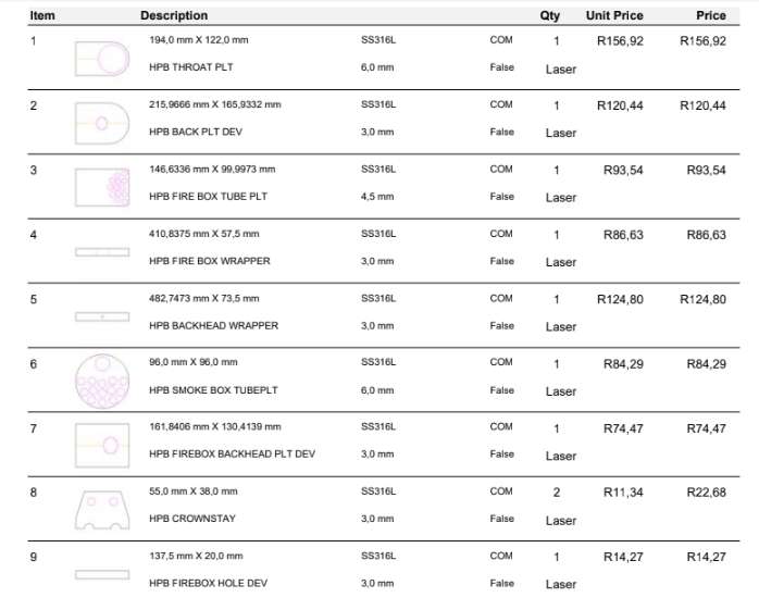

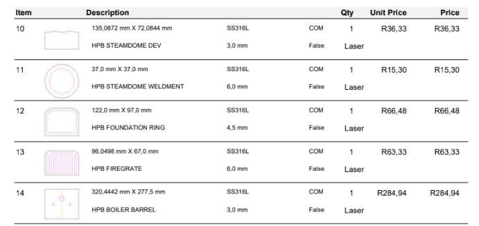

                  It’ll probably cost me less than $200. The boiler is done and all the laser has been cut and I’m sitting at R1600. If a builder follows my methods exactly then they will probably be able to build this model for around that. To give some comparative costs, my 71/4 Stirling cost around R9000, my Wahya R11000 (but that was a ridiculous build just the wood alone added to that considerably as well as all the small laser cut components), the Ballaarat was less than R4500. I never kept track of the Fire Queen or my other unpublished builds. All my castings are from scrap, and I make all my steam fittings including injectors and pressure gauges. I don’t include my time because play-time is not billable! Scratch building makes this hobby very affordable!
                  I think most of the ME readers/forum members know my view on bureaucracy in this hobby. I honestly think that if the builders in the UK want to try out new techniques and not just read about other builders from across the pond innovating, you should take back your hobby!

                    Wow stainless and laser cutting must be a lot cheaper where you are than here. I just ran a few more pieces through the online pricing of the laser cutters I normally use. 3mm 316L Mill Finish. Based on what proportion thing look based on a 100mm dia boiler mainly rectangular plate so some of the curved cutting and extra holes may add a bit more
                    Cost
                    37.00   Barrel 250 x 300
                    20.00   Front tubeplate 94dia & 13 holes
                    26.00   Throatplate 114 x 175 1 lg hole
                    20.00   Wrapper 75 x 300 No Holes
                    18.00   Firebox top and sides 60 x 250 No Holes
                    40.00   Firebox front and back No Holes
                    25.00   Backhead material
                    19.00 Foundation 1 rect cutout
                    22.00   Girders 2off no holes
                    10.00   Allowance for postage
                    237.00
                    47.00   VAT
                    284.00 GBP Total Laser cut 3mm 316
                    75.00   13No 10mm tubes @250lg in postage
                    359.00 Total not including firehole, dome material or consumables.
                    £359.00 is $468 USD so say $500 for just the boiler materials.

                      Crazy pricing in the UK! I can build a few boilers for that! BTW can’t use 316, needs to be 316l…

                        That really is so much cheaper. Even if I were to just buy a sheet of 3mm and cut it all myself I would be close to $300 with the tubes. That was 316L as were the tubes, I’ll edit previous.
                        I see you also have some 4.5mm and 6mm and several parts larger than I assumed so that is going to make by laser price at least $600.
                        You had best go into the business of supplying boiler kits, even with international postage you could make a profit🤑
