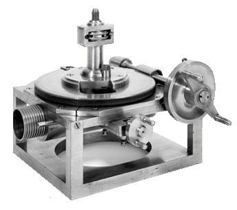

                                Maudslay's Screw Generating Machine (in the Science Museum):

                                  I think your local works would have either relied upon a leadscrew, or spaced it out with dividers.
                                  For the benefit of future readers: It's worth mentioning that a Gaertner-style "effective pitch adjuster" could be used [for example] to convert a 26tpi leadscrew to 1mm pitch [or vice versa] … very handy for those occasional jobs.
