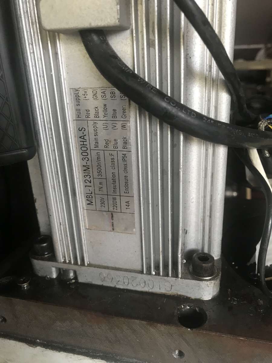

      Hi out there. I am trying to figure out the wiring on my milling motor. The motor is a Chinese item, the serial number is. MBL-1231M-300HA-S. please find name plate attached. There are 4 wires coming from the motor. However the wiring diagram I have been able to find lists the wires in the following way.
      GND-BLACK
      SA-YELLOW
      SB-BLUE
      SC-GREEN. However apart from GND I have know idea which wire is what. Can anyone help. ThanksIMG_4192
      #822483
      Adrian R2
        @adrianr2
        Looks like a brushless DC motor, [Edit: maybe not DC – see later] label says there should be two separate cables:
        • Cable 1 is the “mains” power and has three wires in it Red, Blue, Black one for each phase of the motor.
        • Cable 2 is the “hall” effect rotor position sensor, this has its own low voltage power (Red, Black) and then three signal wires (Yellow, Blue, Green)
        The four wires you are asking about appear to be from the sensor cable.
        This is about the limit of my knowledge of such things.

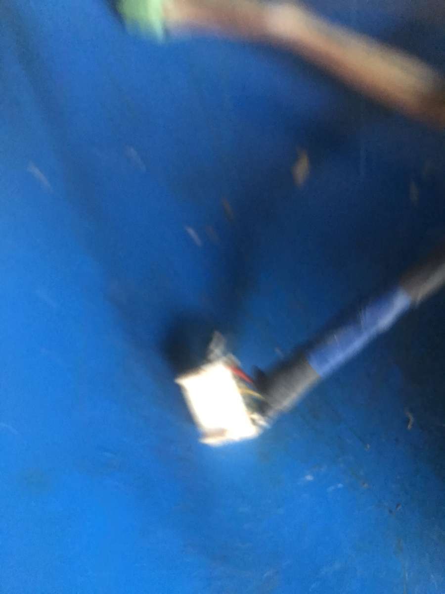

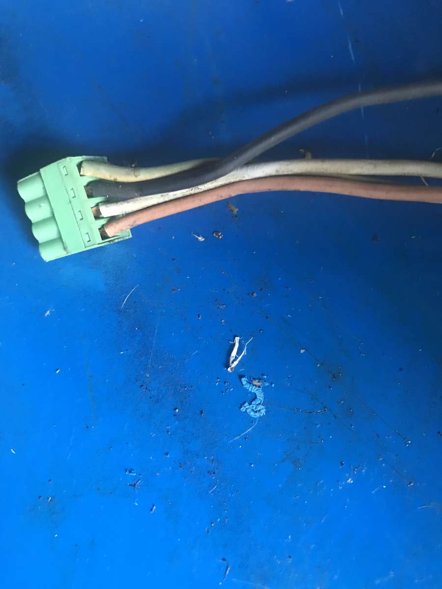

          Here are pictures of the wires leaving the motor. The smaller block of wires is the encoder. However the main wires I have no idea which is which IMG_4195IMG_4196

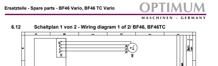

            As its raining here I did a Google image search of the label and threw up a few matches with the Optimum BF46 mill, there are some wiring diagrams in the manual but colours used are not (always) the same as yours so be careful.
            It’s possible that the 4th wire in the power cable is an earth, some tests with a multimeter might confirm that.

              If you google the part number it relates back to the manufacturer. From the label and the manufacturers data sheet it seems to need a 3 phase 220 volt AC power supply.
              Martin
              #822495
              noel shelley
                @noelshelley55608
                The mains is a simple 3phase supply at 240v, from an inverter, U,V,and W are the 3 phases the order you wire them will dictate rotation if wrong swap any 2 wires over. It is a hefty motor at 2200W . THIS IS NOT A SINGLE PHASE MOTOR
                The Hall supply is for the speed sensor and is 5V. Good luck. Noel.

                    Hi Martin. Your reply got me thinking. I cut the cable wrap right back and came across the following marked wires. V,W,U and the green/yellow earth. Would it be to wire the motor to a normal single to three phase VFD. Will it run. If the green/yellow wire I found (same thickness as V,W,U wires) is not earth what is it. Does the motor need the other thinner wires connected or will it run without and use the VFD for speed control.

                      @Dave, does your AI friend know what the 4th wire is? Google “optimum bf46 wiring diagram pdf” and look towards the end of the doc, it shows 4 wires incl. earth going to the motor power.
                      If it is BLDC (Don’t trust me, check for yourself) then you will need a matching controller.
                      BF46
                      [Edit, and here the hall sensor for completeness]
                      BF46-2

                          The fact that it is fitted with a hall sensor with 3 outputs tells me that it is some kind of electronically commutated motor. It is likely be a permanent magnet motor e.g. brushless DC but it does not matter. What matters is that the motor will only work when connected to a compatible electronic drive module. The four heavy wires will be 3 phases and earth. As has been said by others a quick check with an ohm meter will sort that out.

                            Thanks for the input chaps. I think that trying to get this motor working is a bit of a none starter. I have found a three phase 1.5hp motor that will fit so will go that way as I already have a good quality VFD.
