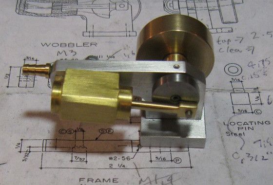

            You don't say what size lathe you have, but it doesn't get much simpler than the Elmer's 25, which is small enough to build on almost any lathe. You can download the drawings/instructions here: Elmer's Engines, Scroll down to to "25 Wobbler – The Start Off Project for all newbies".
            Here is my effort, it was built on a Unimat, and my introduction to Model Engineering. Although Elmer specifies North American screw threads, I substituted the closest metric size instead. One of the advantages of an engine like this for a first effort, is that it is built completely out of stock metal, so no need to replace expensive castings when the inevitable happens and a part needs to be remade.
