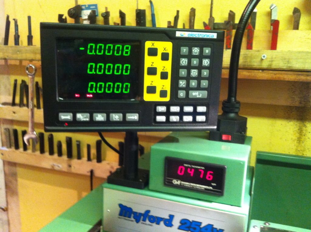

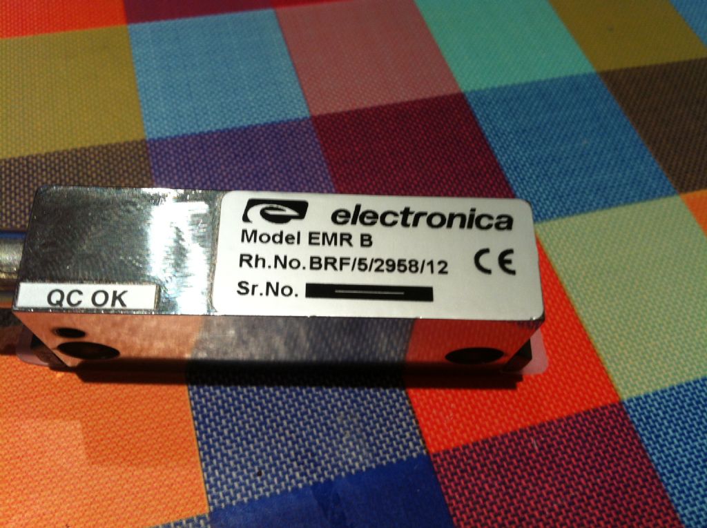

                              I have just fitted a dro to my Myford 254 c/w mill,, After much consideration , I decided to
                              purchase an Electronica EL400DRO .
                              I collected the unit in person from the UK distributor Electronica Mechatronic Systems, in Leicester.
                              The display was complete with a variety of brackets and elaborate instructions.
                              The console is very robust and unlike some is made of die-cast aluminium. looks and feels really good quality.

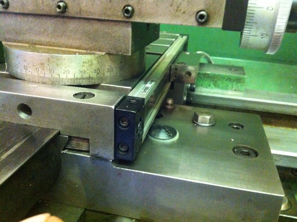

                              The magnetic scales are compact and very easy to fit/.
                              They can be cut easily to any required length., .
                              As a bonus the scales are totally resistant to coolant and swarf .
                              Speak to Mark Hudman, very helpful and very knowledgable.
                              take a look at ,my post on homeworkshop.
                              you are welcome to call and see mine, or if you want some photos of mine just email me.
                              best regards. ray

                                            EL 400 looks very neat. well made. The buttons are "REAL "buttons
                                            not "plastic buttons" on a membrain- as in some calculators.
                                            glass slides etc, these cannot be cut to length, if your travel is say 150 mm, ,plus mountings
                                            etc your total length overall would be , say 220. mm
                                            If the glass slide was 250mm, it could not be cut, you would have 30 mm overhang.
                                            The one I have has S1 magnetic slides, they are slimline , enclosed, yet very robust and totally swarf and coolant tollerant.
                                            they are rated at 5 microns and display to 4 decimal places
                                            to cut them to,length takes 5 minutes and is fool proof and easy,
                                            unscrew the one end.( 2 – 3 mm scews)
                                            take out stainless strip guard.
                                            put the slide in my chop saw
                                            slide stainless strip guard.back in
                                            put the end back on, — job done
                                            ray.
