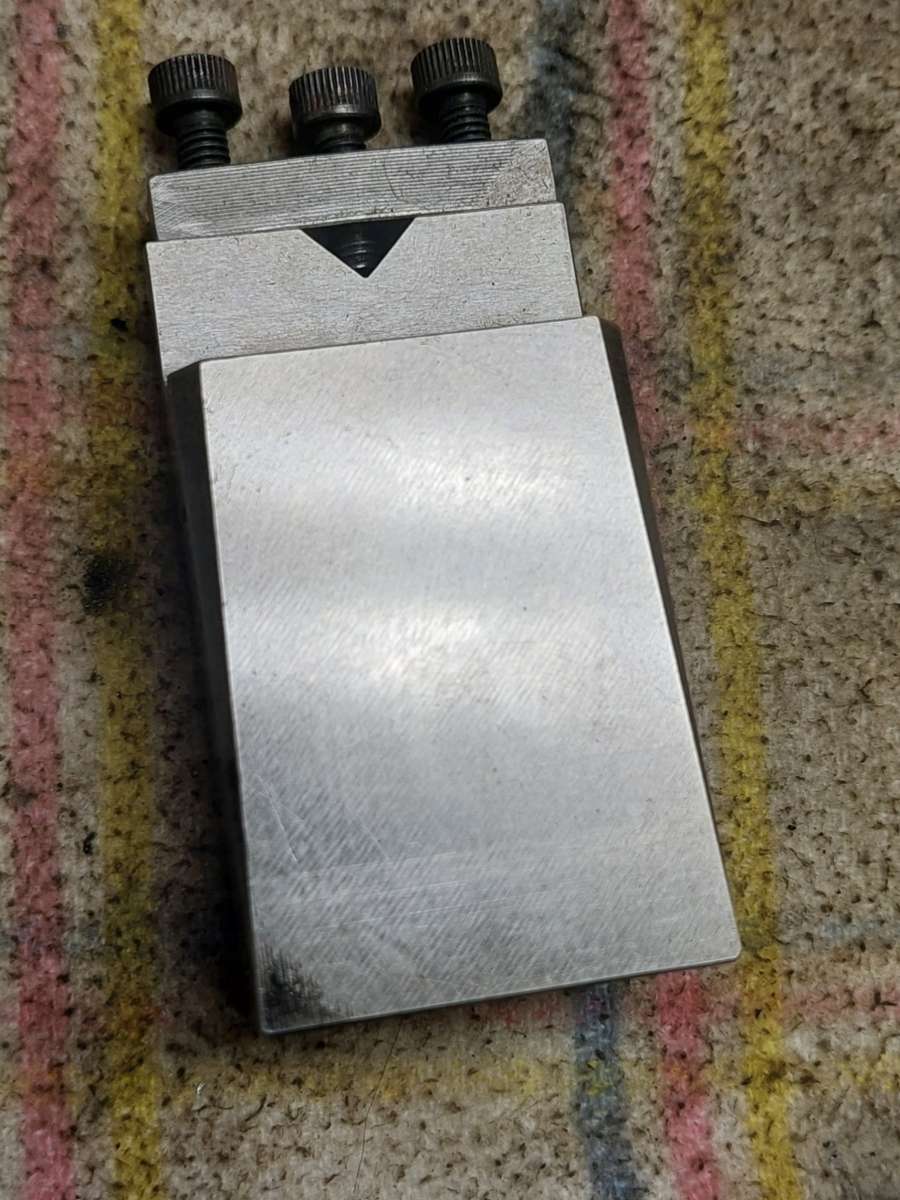

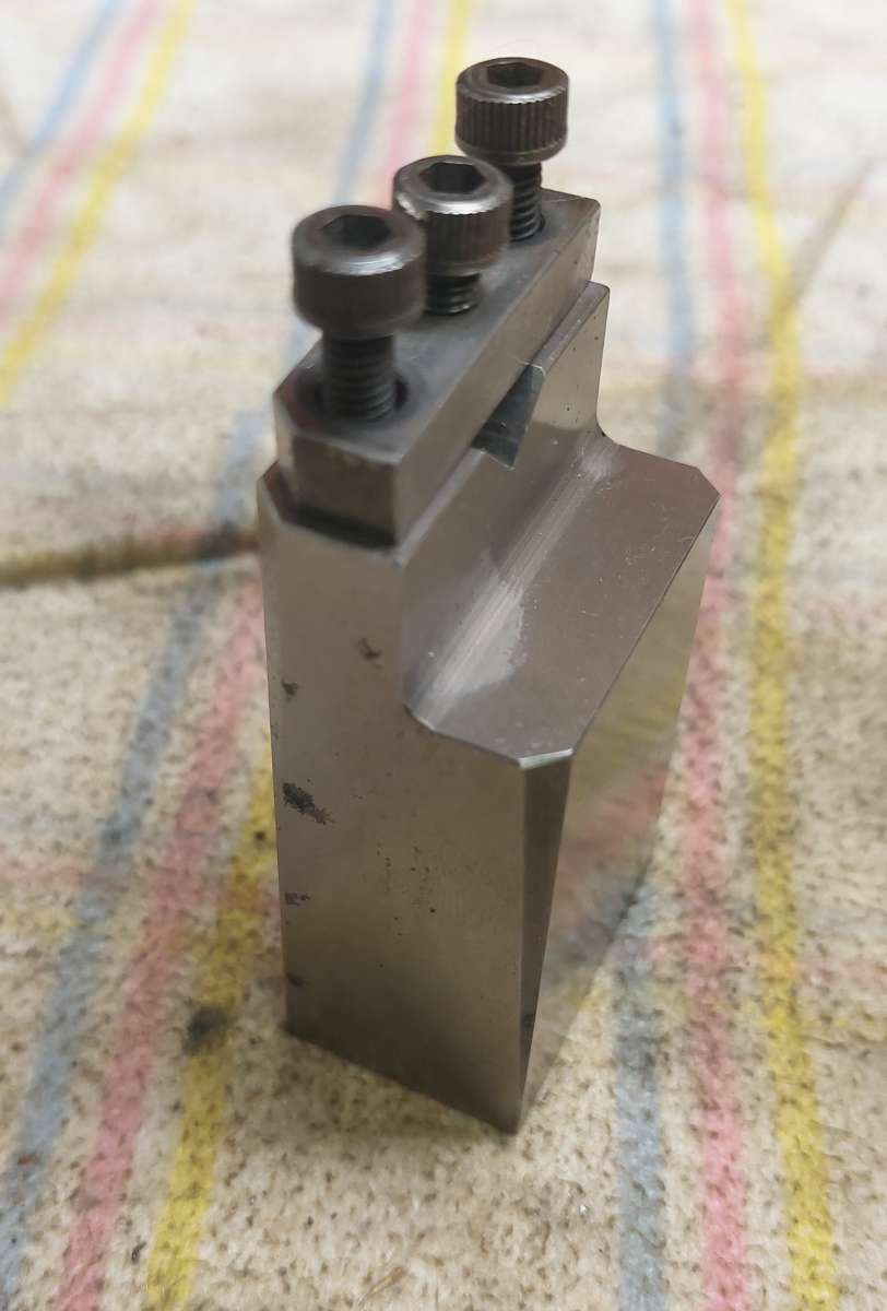

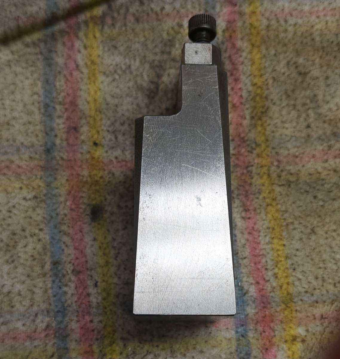

      Some sort of clamp but why the weird angles?
      20250301_16163020250301_16162520250301_161646(0)
      #786835
      Bazyle
        @bazyle
        Looks like about 5 degrees. A D-bit clamped in the V could have its front relief ground off. Bit of an odd way to do it though.
        #786847
        Tony Pratt 1
          @tonypratt1
          Could be, I have one similar to this but without the angles, typically these vee blocks were used to end sharpen headed press tool punches and from distant memory some did have an angled cutting face.
          Tony
          #786872
          Bazyle
            @bazyle
            Yes that’s better Tony. I was thinking too hobbyist.
