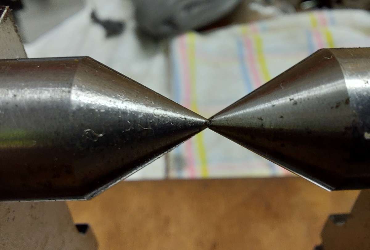

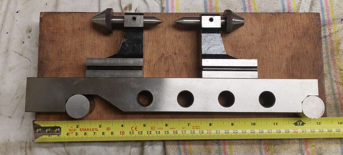

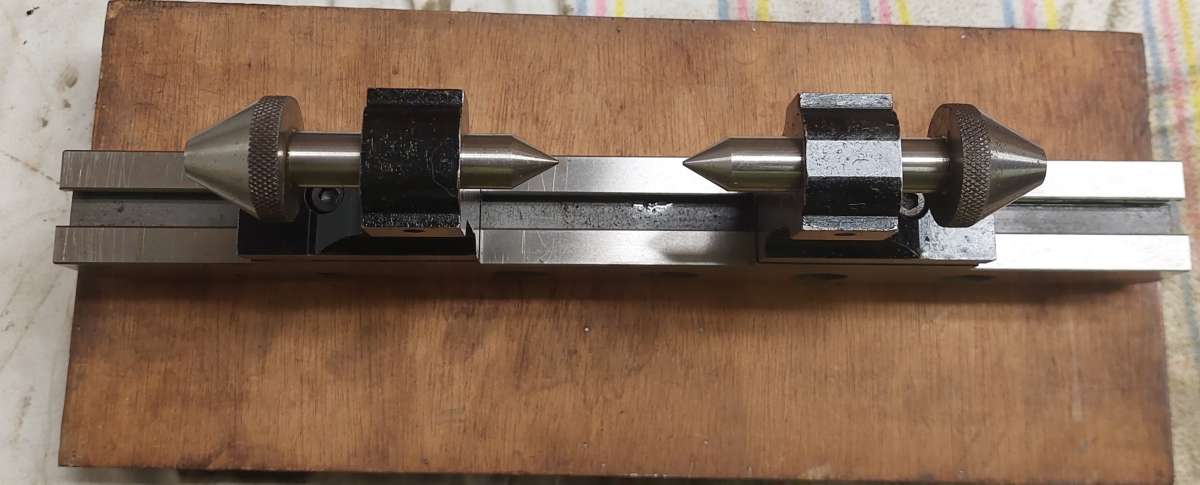

      Another custom tool. Surely not for grinding again 🙂 ????

        Surely is
        … or maybe a fixture for checking components that have been ground

          A pair of centers on a sine bar. So most likely to be for grinding or measuring tapers.
          By putting a slip gauge under one of the round bars you can set an exact angle based on the sine of the distance beween the two round bars and the thickness of the slip.

            You have some quality kit in your collection! I’ve never seen one of these in the flesh, off the top of my head you could check morse tapers etc without the need of a gauge, super!

              You should find that the distance between the round supports is exactly 10″…….That makes the sine calculations easy.

                  Internal and external centres, at that.
                  When both holders are set correctly and their clamp-screws nipped up, the centres should be exactly co-axial, not slightly misaligned as in your close-up photo.

                    It may be an illusion but the tape measure in the picture shows differently.

                      surely thats 10.5″ and correct for a sine bar

                        Where do get the 10.5″ from ?
                        I have always known sine bars to be usually either 5″ or 10″, or sometimes 100mm
                        I actually have a 2.5″ one in my toolbox as well.

                          The sine bar rollers seem to be at an odd dimension though it can still be worked out. Interesting bit of kit. Noel.

                            With something like a Morse taper, the half angle of the taper is kind of a derived quantity or by-product. The taper is specified in inches per foot.
                            This is complete speculation, but I wonder if the roller centres have been chosen to suit a 1 in ‘x’ taper, where we are interested in the horizontal and vertical legs of the right angle triangle. That does make the item into a one trick pony, but if it is for inspection purposes that would not matter.

                              Sorry but having looke again it still looks like 10.5″

                                The roller centres are irrelevant, you just need to know what they are to work out the slip gauge height.

                                    Measure from the RH O/D edge of the LH roller to the RH O/D edge of the RH roller instead of guestimating where the centres are.

                                          <p style=”text-align: center;”>It’s 10inches between sine cylinder centres</p>

                                            Thought so………..
                                            Much better to measure it, than guess from a photo.
