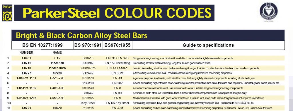

                    EN3B will give you a machineable / weldable steel
                    Paul

                          I think Steve that other contributors have overlooked the fact that you are purchasing for stock and not for a specific project. You do therefore have to ask what proportion of the tasks you will undertake will involve welding. If, say, only 20%, then it would be foolish not to benefit from the free cutting results that En1A (230M07) will give just to be able to weld the 20%. In this case, either purchase a small stock of weldable steel or purchase as required. Of course, if a large proportion of you activity involves welding then forgoing the free cutting aspect of En1A may be OK.
                          Another factor is that welding most frequently, though you may be doing something out of the ordinary, involves rectangular materials. In this case, En1A (as per Macreadys) is only available in a small range of imperial sizes and you will have to purchase En3B. I only know of one supplier to the home workshop who lists EnIA in rectangles and having purchased from them what I received was certainly not En1A.
                          As a guide to relative machinability, Macreadys use 100 for En1A as a baseline for all others, giving 55 for En3B (070M20) and 080A15 (no En number, known as good commercial quality) both of which they quote as being suitable for welding.
                          Incidentally, they give a value of 130 for leaded En1A
                          In a nutshell then, do consider how much of your work involves welding before limiting a large proportion of your turning to materials that machine less well.
                          Harold

                                Posted by David Colwill on 10/11/2012 11:14:27:
                                Terry the point is that you knew it was the correct information.
                                Edited By David Colwill on 10/11/2012 11:15:20
                                The OP asked what steel is weldable and machineable and did not state the application.  In the absence of an application I would not suggest using the wrong spec. Using his keywords  a simple search found the information below in just a few seconds, It does not take an expert to understand it.   – click on the image wink 2
                                Learning to research in the quest of knowledge is the best education, too many students now only know how to 'ask teacher' which is one reason we fare so badly in international education tables.

                                  Hi, free cutting steels are weldable, but, in most cases they need heat treatment either before or after welding and in a lot of cases both. The heat treatment depends on the nature of what is being welded and the masses of the sections i.e. a comparatively thin section welded to a big block will in all likelihood need pre and post heating and the temperatures are likely to be a bit critical too.
                                  Heat treatment of this nature is likely to be beyond the scoop of most home workshops, and as Harold suggests, get the best grades for the different jobs whenever possible.
                                  Regards Nick.

                                                Hi i am a welder who worked in a machine shop refurbing Machine tools and i always used EN8 as it was weldable without causing hard spots for machining and could later if needed hardened in oil and water. EN1a to weld and turn properly mas to be welded with a disimular welding rod and not with a mig .
                                                Martin
