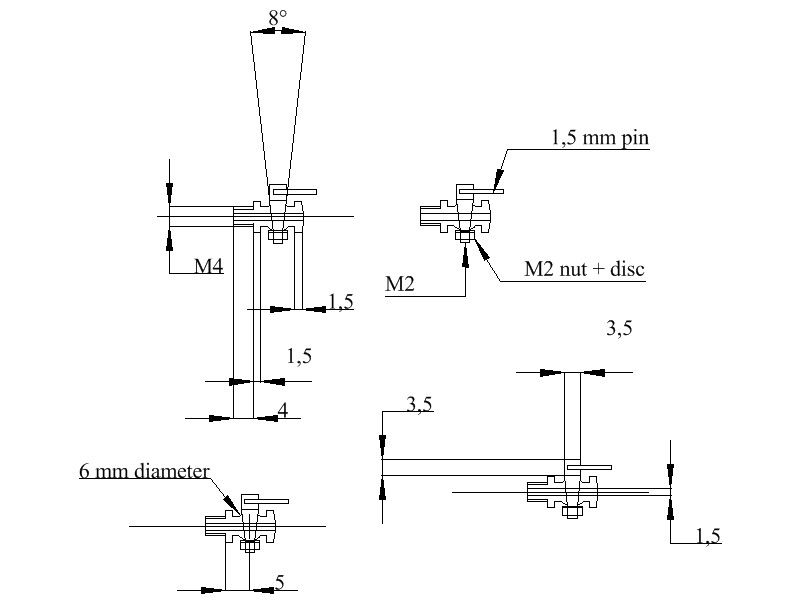

        What thread should you choose for the steam in and out connection to Stuart V-10, to fit common accesories.
        And what thread for the drain taps?
        Growing up with millimeter so I need advice.

            Dear Bertil,
            I have made several Stuart No 10 and other engines and I have just looked at the drawings used.
            Steam fittings in and out should for 10 H&V should be be ¼” x 32 tpi
            Drain cocks (smallest of the 3 sizes available) 5/32” x 40 tpi (from the Stuart models catalogue).
            I hope this is of help.

              In case you has not imperial treads for drain cocks, use M4 treads in the cylinder and make own drain cock, it is not difficult. I did with my Stuart D10 with ownmade drain cocks since the draincocks is not cheap to order from UK due toll tax.

                  Jens Eirik do you have any drawings for yor draincocks?

                    Svarven, i do not have the drawnings of the draincocks. I can make a drawings to you if you want.

                        Hi, here is the drawings of the drain cocks in millimetre for "non imperial" engineer **LINK**

                          Thanks
                          Looks good.
