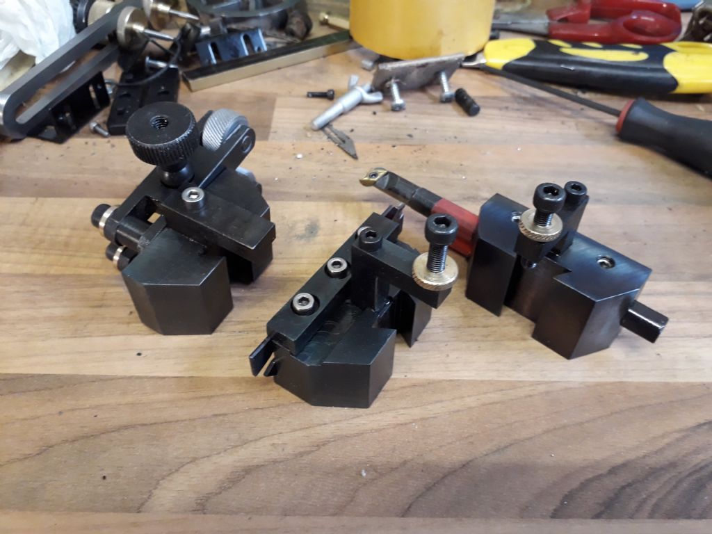

                              Had a go at hot oil blacking.
                              I'm quite pleased with the result.
                              Edited By Tim Chambers on 16/08/2019 17:09:15

                                Very satisfying when it turns out nice.

                                  That looks good Tim, will be going that route shortly – what oil / temp did you use ?

                                    I found an old can of Duckhams 20/50 in the garage. All I did was heat it up until it went dark and dunk it in the oil.

                                      Hi Tim
                                      Good even coating to all areas.
                                      What spec are the toolholders made from ?

                                        Just ordinary mild steel (EN1 ?) I doubt that I'll ever wear them out frown.

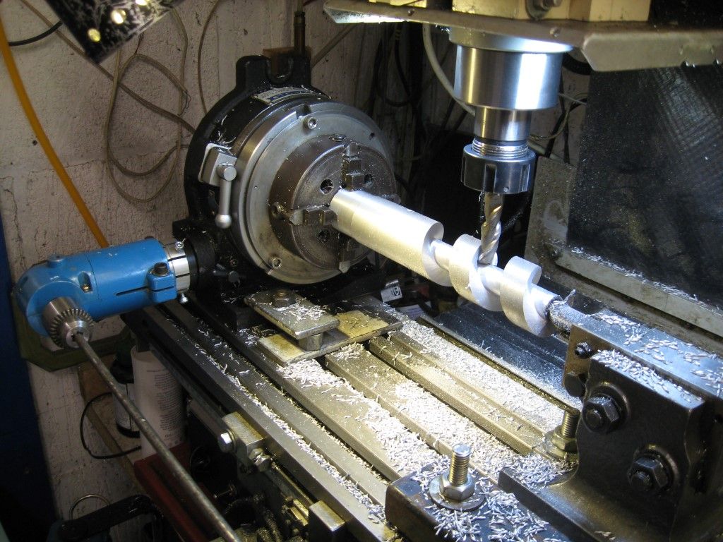

                                          Cut a helix on the mill using the rotary table and a right angle drill attachment. The right angle drill attachment was a lazy way to get a right angle drive.
                                          Les.

                                              Ingenious – I'm impressed, and not just by the right-angle drive!
