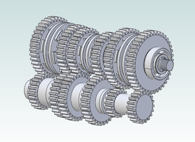

                        #422428
                        John Hinkley
                          @johnhinkley26699
                          Meantime back at the ranch …………
                          I've done a bit more with the gearbox internals:
                          Input and output shafts
                          The reverse gear idler is missing from this shot. I need to find out how to insert a new offset axis in Alibre Atom. And the shaft ends aren't complete, yet, either. But it's progress.

                                Posted by John Hinkley on 03/08/2019 15:39:52:
                                Interesting, what's the gearbox for?
                                John MC
                                #423224
                                John Hinkley
                                  @johnhinkley26699
                                  John MC,
                                  The gearbox started life as a bit of fun with Alibre Atom, to keep the old grey cells active. However, if or when I get around to making it, it'll just be a decorative or demonstration piece, probably using perspex panels to form the bearing supports in order to show its workings.
                                  I'll be posting more pictures in the album as work progresses, should you wish to follow it. Don't expect rapid progress, though!
