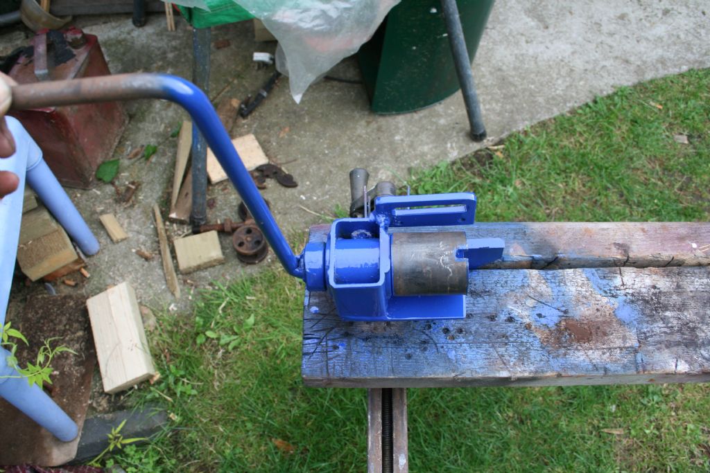

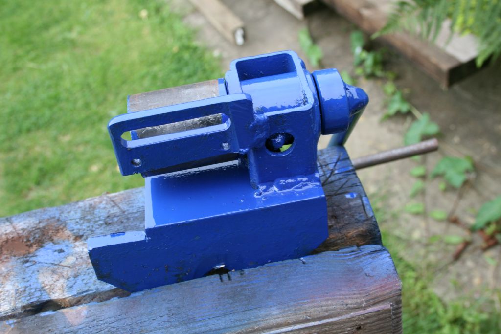

            Bish bash bosh , old junk into a useful ring winder for my horseshoe puzzles ! Not terribly proud of it blush, but works a treat !laugh Note ready fitted grease nipple yes    It was a bit of an electric  garage door opener

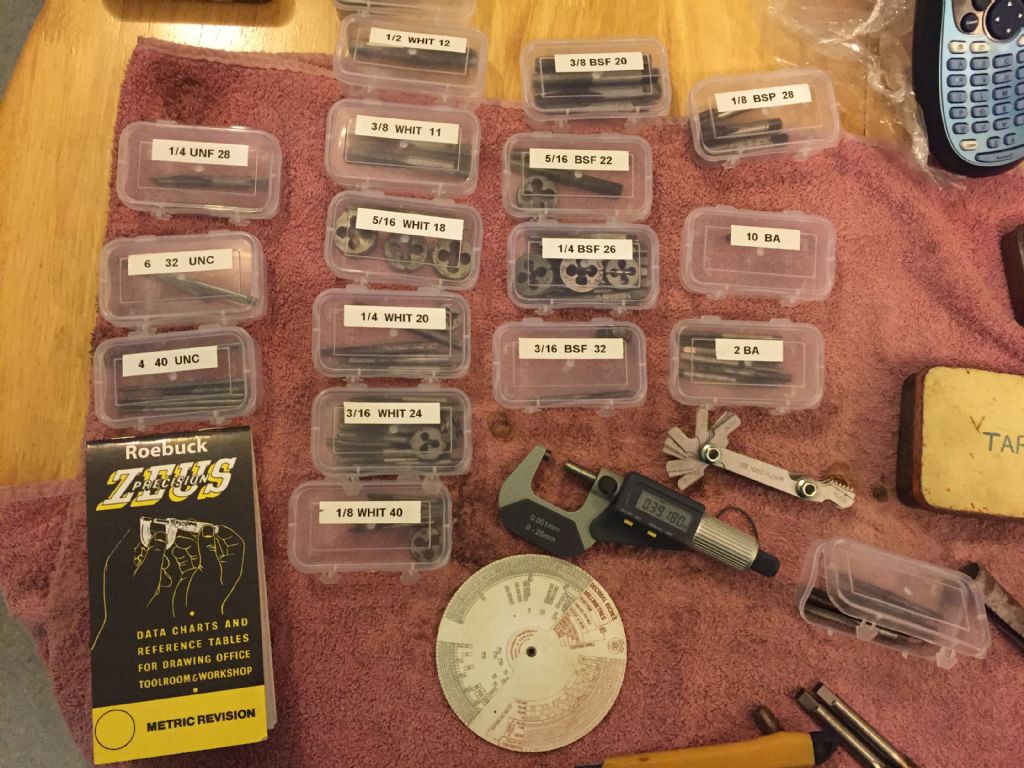

                    As I am waiting on some bolts to arrive, spare workshop time today has been spent identifying, sorting, boxing and labelling part of the collection of miscellaneous taps and dies I inherited. Items are being boxed in 3.5 x 2 inch plastic boxes. I would like to reduce the chances of corrosion so looking for recommendations for 'stuff' to put in the boxes to accomplish this please.

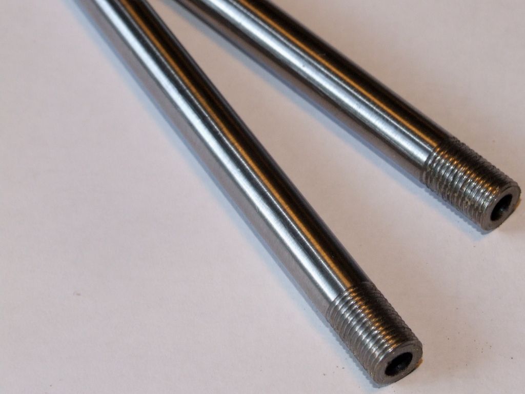

                      I am pleased to say that I did not bog up the screwcutting on the governor central columns, and the DOC to get a good fit was spot on the theoretical value of 20 thou for a 32tpi Whitworth thread:

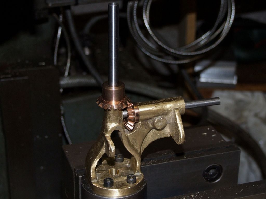

                      Oh, and I've also got the bevel gears installed and running smoothly in the body, all based on measurements from the 3D CAD model. It's taken some hard thinking to make fixtures that ensure that everything lined up on a casting that's less than easy to hold:
                      Andrew
                      PS: To forestall the pedants of course we all know that the theoretical thread depth for 32tpi Whitworth is 20.01 thou
                        Camphor as used in mothballs (not Napthalene mothballs) will do the job (available on EBay/Amazon from sellers of Indian spices/flavourings/chemicals), but it's somewhat impractical in small containers like those.
                        VCI paper wrap around the taps and dies will work very well.
                        Failing that, wipe them with a bit of way oil before putting them away.
                          My blood pressure tablets come in a bottle with a small sachet of silica gel – useful continuing supply about the right size for your application if you can find a 'supplier'
                          just a pity the bottles are opaque

                            Hi Nige, nice tidy up, try VCI paper cut / folded to size to fit your box's. I have pieces in all my tool cabinet draws, + in my mic' / dti / vernier box's etc. By the way I noticed the round drill / tapping mm/imp. gauge on bottom of your pic, have seen them before but have forgotten what the name for them is, grey matter slowing down 'n' all that, would appreciate reminder.

                                7 day shop.com are selling small sachets of Silica gel at the moment!

                                  Silica gell is bulky and needs periodic revitalising, VCI paper only lasts a year or less then absorbs water and becomes a liability – often find old never used spares with that wrapped around and causing rust.
                                  Just paint with grease if not likely to use for a few years, or oil if likely to use soon. Using a small stiff artists brush ensures it gets into the corners.

                                    I clean after use then dribble a small amount of cutting oil on mine, then they are ready to go next time.

                                        I spent a good while trying to find what was in volatile corrosion inhibitors and discovered research that shows molasses is very effective!
                                        You could put a slip of VCI paper in each box, molasses might be a bit messy.

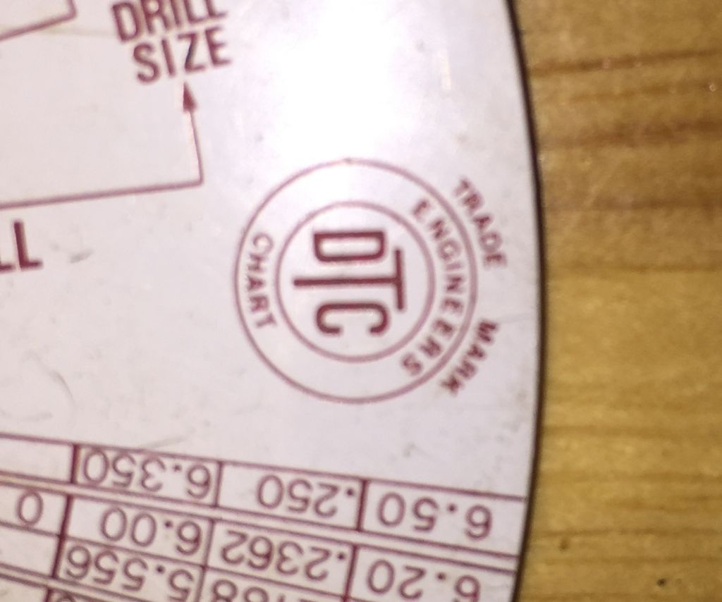

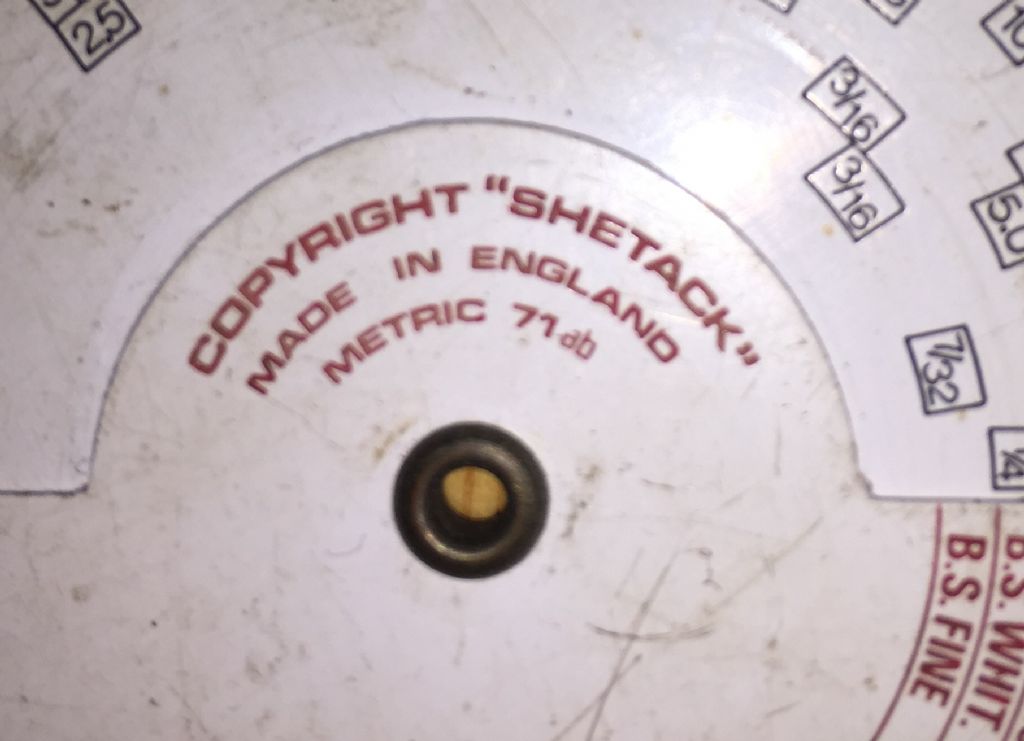

                                          George: Below are some closeups of the only identifying marks on the circular thread chart in my original picture.
                                          There are some similar available on eBay at the moment, the link below is current now
                                          **LINK**
                                          Thanks everyone for the suggestions. Ill get some VCI paper and use a little oil. I dont fancy the molasses thanks Neil

                                            George: In fact, one exactly the same here now.
                                            nEAAOSwFqNZR8ZJ”>http://www.ebay.ie/itm/Shetack-Engineers-DTC-Double-Sided-Chart-/122606369760?hash=item1c8be8bbe0:gnEAAOSwFqNZR8ZJ

                                              About half my taps and dies are in the dining room, the other half in an unheated workshop. I've never needed any sort of corrosion inhibitor or oiling.
                                              Personally I wouldn't keep taps and dies mixed together in boxes; it may not do the cutting edges any good.

                                                There is a long term storage grease called RIG, mainly used on firearms for storage.It's main purpose is to stop rust and acid attack.

                                                    Thanks everybody. VCI paper and a little oil sounds good; paper ordered😀
