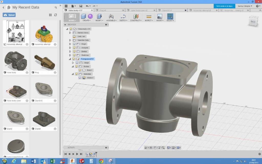

                      Like Ed, I spent some time today learning how to use Fusion 360 to create models and assemblies, Woke up this morning determined to accomplish something – and due to my current state of complete workshoplessness, this was the best I could manage. Things have come to a pretty pass.
                      Drew up a valve assembly using exam practice examples from "Manual Of Engineering Drawing" by Simmons, Phelps and Maguire. Turned out OK. It's not as powerful as the full Inventor program but has got most stuff you need.
                      Like most CAD programs, it has its own infuriating features although in this case the documentation is particular;y crap. It's that old chestnut again – the people who developed it and created the help files knew how to use it so the documentation is chocolate teapot quality in (most) places.
                      It seems to require you to make a bizarre (and irreversible?) transition from "bodies" to "components" before you can assemble parts into assemblies. The lack of any remotely intelligible documentation doesn't help at this point. I sort of got there but I'm still perplexed and a more than a little irritated on several fronts, not least at my own apparent stupidity.
                      Finished off trying to generate a pukka 2D drawing from the final assembly. This wasn't straightforward, so will need to read up on it – or more accurately watch some Youtube videos by non-Autodesk users who are actually capable of explaining what to do.
                      Murray

                          Capstan Speaking
                            @capstanspeaking95294
                            Posted by Muzzer on 27/06/2015 20:59:07:
                            Murray
                            It does seem to be a bit different to the approach that Inventor takes.
                            A "body" would refer to a dumb 3D object that has no geometric history to it. Imported files would exist this way. Inventor Parts could then be "derived" from such items.
                            It seems that many of the players in the CAD market have gone for a complete range from low end to top end products.
                            Parametric modelling is so different to the old ways. It used to be that geometry drove the dimensions but now the dimensions drive the geometry.
                            #195229
                            Muzzer
                              @muzzer
                              The bizarre thing is that in Fusion, what you are creating with all the sketches / extrusions / cuts etc is known as a "body", even though it was created within Fusion's "modelling" environment. Unlike the other products, Fusion needs these "bodies" to converted into "components" before they can be assembled together.
                              In Inventor, you can import a body (as STEP or IGES) and make it an Inventor part, much as you can in SW, SE etc. I suspect Fusion is a collection of different applications that aren't really very mutually compatible and this is the kind of bodge required to make them work together.
                              Fusion seems to be the "low end" of your scale not surprisingly, along with Cubify and Designspark Mechanical. Inventor, SW, SE, Alibre/Geomagic etc are the midrange. However, Fusion has the full 3-axis version of HSM Works, rather than the free 2.5D (Solidworks add-in) that you can get for free anyway.
                              Murray

                                Capstan Speaking
                                  Posted by Muzzer on 28/06/2015 14:08:09:
                                  Murray
                                  OK that's just weird.
                                  Perhaps Autodesk have bought up a separate product rather than write one from scratch. Perhaps the extra step is a conversion to make them compatible.

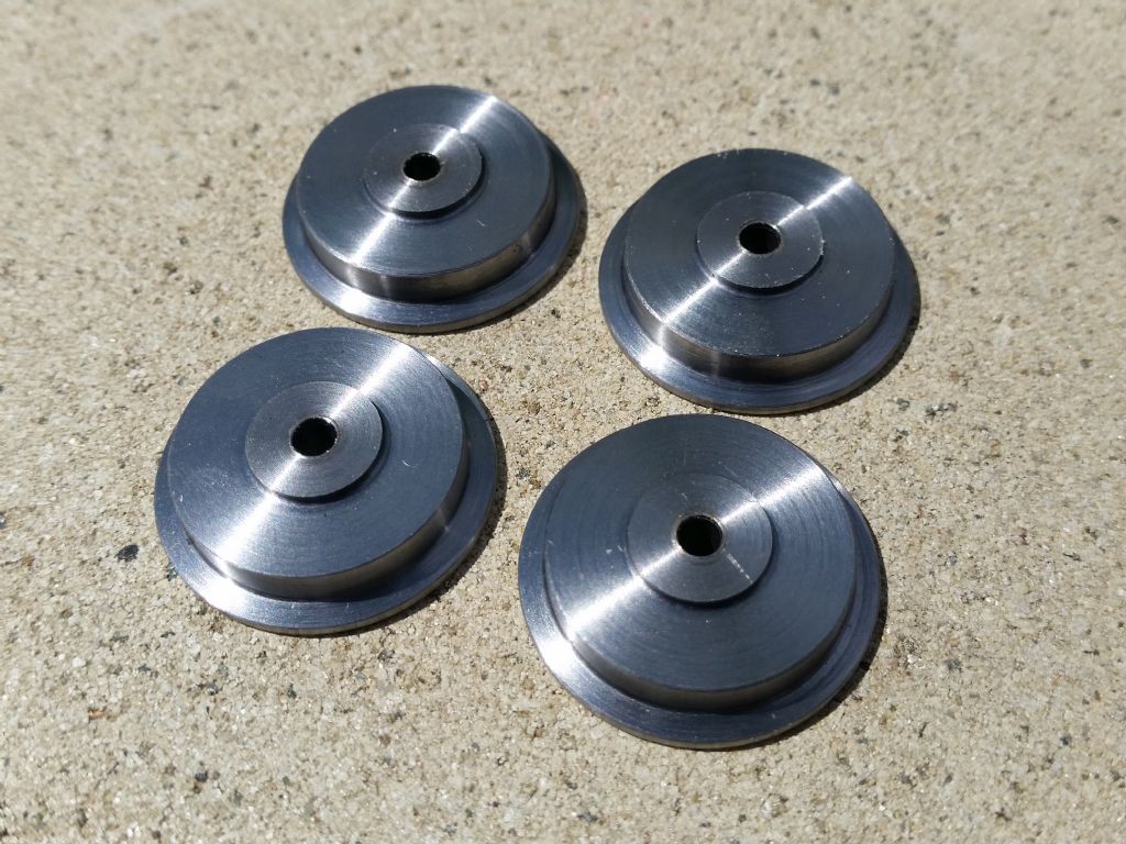

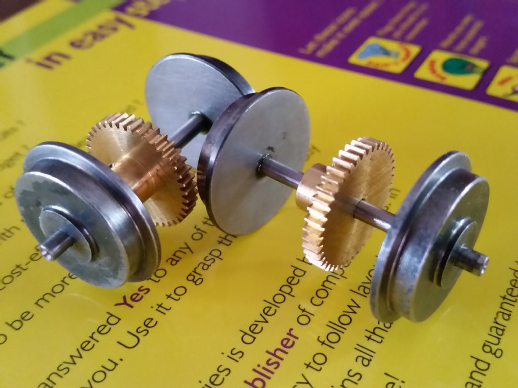

                                                    Steven Greenhough
                                                      @stevengreenhough56335
                                                      Pulled my finger out over the last few days and finally made some little locomotive wheels:
                                                      Originally I intended to have them as a press-fit on the axles but the plan has the axles as a continuous piece of 3mm rod – there is no shoulder, AND as it is an outside-framed locomotime adapting the plan to turn a shoulder would thin the axle somewhat. So I drilled the blanks to 2.9mm and made a toolmakers reamer of (very) roughly 2.95mm (from the axle-rod), and ran that through turning the lathe by hand. Then I mounted them on a turning fixture with an M3 caphead screw – these were quite snug and each wheel kept it's own screw for each stage of turning. There are no photo's of this as I was concentrating. Alot. Likewise I've not added any decorative holes, or recess to the front, it was all about getting the dimensions correct, and the same.
                                                      So, to mount, I thought about, and tried, heating the wheel to get it to expand and shrink on the axle; It didn't work (I was probably much to far away in terms of fit) and only suceeded in dropping two of my wheels and putting a liitle ding in the flanges. Oh fluff. A little bit of gentle filing rectified that, and wire brushing the wheels removed most of the blacking where they had been heated, while leaving them duller than when first machined..
                                                      In the end I made another toolmakers reamer from the 3mm silver steel I was using for the axle, at full size. I mounted the wheels backwards with the tread in the three-jaw and the flange pushed up hard against the jaws, and just hoped that any runout would not result in an overly-enlarged hole. It seemed to work fine with the wheels sliding onto the axle with an almost imperceptable degree of wobble. So with the adition of some retaining compound (not forgetting to slide a (shop-bought) gearwheel on before the wheels) and a bit of measuring and jiggling we ended up with these:
                                                      22mm tread, 26mm flange. 2 degree taper on tread and 10 (or is it 80?) on the flange, this angle is less than on the plan, but more than on the guide I followed which reccomends a square flange for 16mm narrow gauge. I suppose I could have rounded the flange off a bit more, but… Quite please if I'm honest, they run smooth, straight and true when let free on a bit of inclined Peco SM32 track.
                                                      Apologies if this is teaching anyone to 'suck eggs'…
