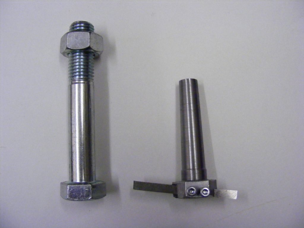

                FlycutterA bit of a frustrating day. I bought some M20 bolts at a car boot sale because they were cheap metal. I decided to try to make one of them into a flycutter. Nice simple project and all went well to start with. The last operation was to bore out the Morse 2 taper and tap it M10 for the draw bar. I had previously drilled the taper 4.5 mm so I quickly drilled the hole out to 8.5 mm without any problems. I then started to tap the hole M10. At first this was straightforward but quite suddenly it became hard to turn the tap. I withdrew the tap cleaned out the swarf lubricated the tap again and tried again but it would not advance past the hard spot..
                I decided to redrill the hole 8.8 mm and then try again with the tapping. Again it became very hard to turn the tap so I tried a new tap but still the same problem. I drilled it out again to 9mm and tried a new tap still impossible to advance. I have now given up for today. Tomorrow I will heat the flycutter to bright red heat (weather permitting) and let it soak for a while and then allow it to cool and try again with the tap.
                The bolt was marked 8 8 which means that it is medium carbon steel that has been hardened and tempered so I guess there is a hard spot.

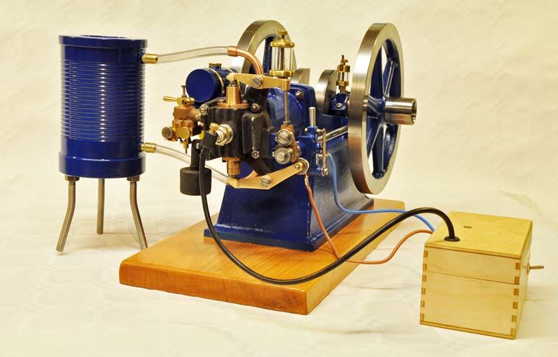

                        I finished pimping my Wyvern:
                        She''ll be flaunting herself on the Modelenginemakers stand at the Guildford show next weekend, being outshone by some really good stuff from JasonB, Jo and Ramon amongst others.

                            Mike,
                            Why don't you just screw a threaded extension piece into the end, provided there are enough threads.
                            An application of locking fluid would secure it, or silver solder/braze it in place.
                            Rod,
                            I like it.
                            Well done!

                              Looks very nice, Rod. Polished brass and 'Oxford blue' al;ways go well together.
                              Where on earth did you source that corrugated tube for the coolant tank

                                ?? a tin can from the Super Market/ kitchen ie., Baked beans or something would be my guess. Ian S C

                                  Perhaps a rectangular tin would have bean (see what I did there?) less obvious (red kidney actually – the chilli was delicious)

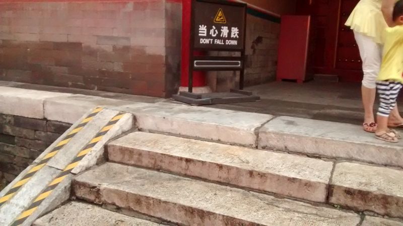

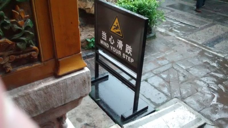

                                                  Just sorting thru some of the pics from the China trip and though I'd share these two with the forum.
                                                  All two often there are posts on Chinese bashing on various forums with collective thought about their lack of Elf and Safety but let me tell you they are now taking this very, very seriously.
                                                  Firstly a warning in two languages.
                                                  Then a more pointed command.
                                                  Incidentally these were taken in the Forbidden City in Beijing where all the temples are from 6' to 10' off the ground and you walk round the outside on narrow ledges, no hand rails or supports but despite over 10,000 visitors per day you don't see anyone falling off these.
                                                  Quite refreshing to see common sense used.

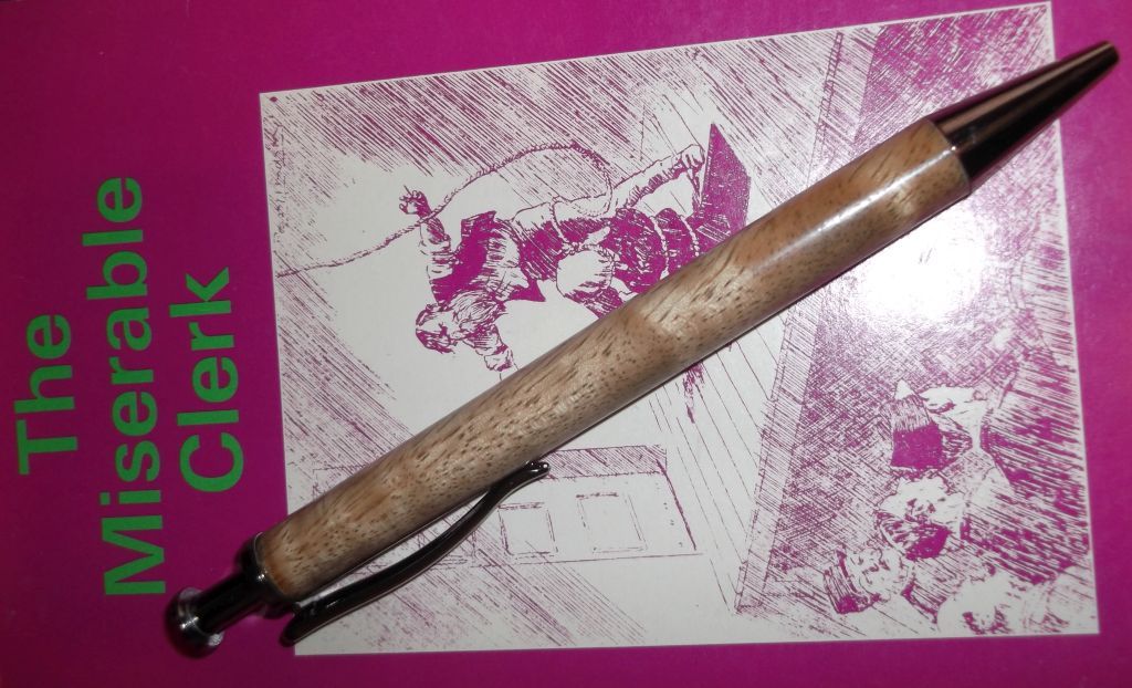

                                                    Yesterday finished off this pen I made an Executive Clicker with QLD Mangodscf7794.jpg

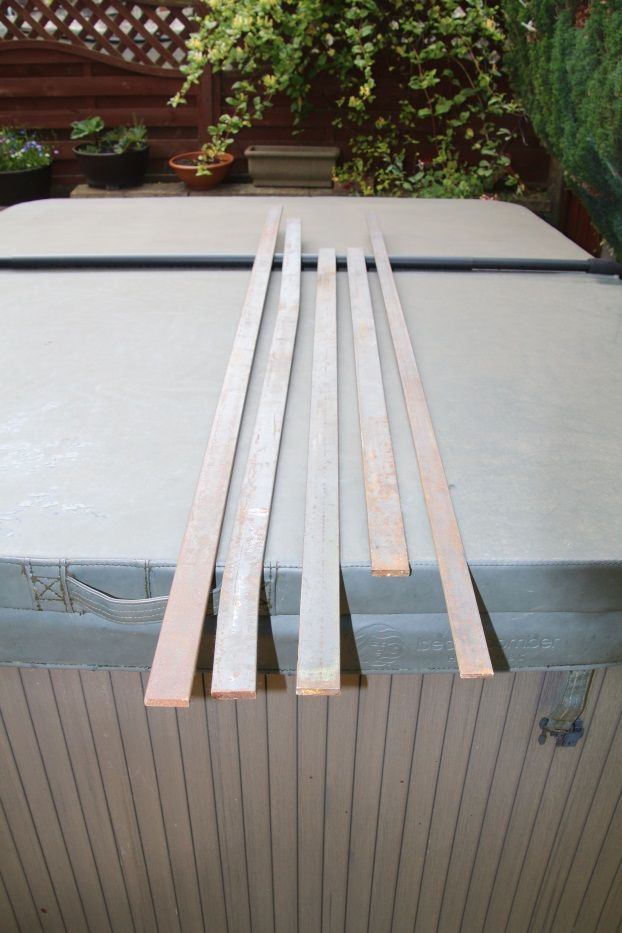

                                                      Only managed one boot today before rain stopped play but got this lot just before the heavens opened.
                                                      All black mild steel:
                                                      1.7 metres of 6 x 30
                                                      5.78 metres of 10 x 40
                                                      He wanted £15 but I managed to persuade him that £10 was more acceptable – to me you understand?
                                                      A new 5 litre container of Millmax 10 hydraulic oil for a couple of quid finished of my shopping nicely.
