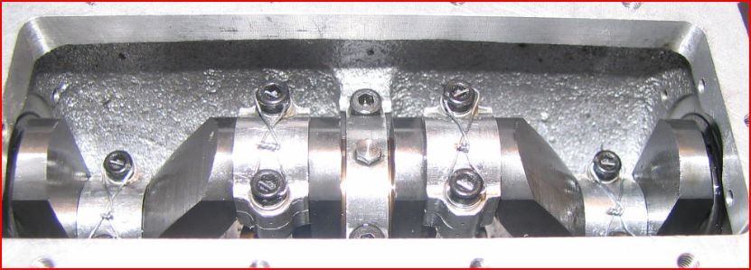

      Hi guys I have recently started a Sealion by Mr E.T. Westbury to power a Tank I was contemplating.
      One of the things which has always bothered me has been collecting suitable materials for a project hence the kit.
      The other worry I have is with the design of the crank it's self. I am thinking of changing the configuration as it looks to me as though the engine must have inbuilt vibrations due to the shape of the crank.
      So to my question: Has anyone here built this engine to spec and drawn any conclusions about vibration pertaining to the cranks configuration?

            Where do you see the problem? the two rising pistons will basically balance out the two falling ones as its a 180degree crank

              On the contrary, when the two outer pistons are rising, the two centre ones are falling, this will flex the crankshaft in the centre. Could be OK if a centre crankshaft bearing is fitted. If you want to redesign it, here is a good article :- http://www.epi-eng.com/piston_engine_technology/crankshaft_design_issues.htm   http://www.epi-eng.com/piston_engine_technology/crankshaft_design_issues.htm

                  Many older vehicles were built with this crank design and it seemed to work ok, I think the Austin 7 was one and I have Coventry Climax sidevalve that only has two main bearings.
                  They were never stressed enough to cause a problem.

                    The sealion has a central bearing so no whipsmiley

                      Jesse, I don't think economy of materials had anything to do with the shape of the crankshaft. On several of Westbury's models the crank starts off as a round bar as it is generally easier for hobbiests to get hold of metals like EN24T in the round which can then be machined to a flat section and then turned to form the crank, a bit like this one of mine.
                      Malcom Stride covered crankshaft design pertaining to model engines over about 3 or 4 installments of "IC Topics" worth having a read through to see how things affect our little engines.

                        Reading again the instructions it says that the casing will NOT accommodate circular crank webs as the body is too narrow. Which may negate my enquiry altogether.
                        For the record Wesbury uses flat bar on this crank from which I gather he roughed out using a saw, and then stress relieves the piece in the normal way.

                          ETW once wrote a long explanation of why the extra complexity of a centre bearing was not required for the Seal and related engines.
                          I think he got rather fed up of people telling him it needed one and pointed out the large numbers of Seal engines built that had no signs of problems from crankshaft distortion…
