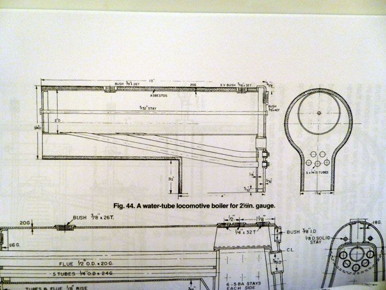

      I am currently reading a book called 'Model Locomotive and Marine Boilers' by Martin Evans. A chapter towards the back of the book shows a very simple 'water tube' gas fired design for a 2 1/2" gauge locomotive and the book suggests that similar designs could be applied to larger scales – say 3 1/2" gauge. The design appears to be far easier to build than the traditional coal fired version and seems to use a much smaller proportion of very valuable copper/ silver solder.
      Is anybody familiar with the performance of these types of boiler and why with such high material costs is this type of boiler not gaining in popularity e.g., is the performance simply not good enough. Any views?

          do you have a sketch/picture? I had a go at water tube boilers some time ago, it all depends on what type of water tube boiler you mean?

            Good idea Fizzy so here it is. You might not be able to see all the detail but it is 3 1/4" diameter and 10" long. Its firebox section is obviously narrow enough for 2 1/2" gauge but this could surely be made wider. It is not far off the size of a boiler that would fit Rob Roy – maybe. However, I am still reading the book and the next chapter might hold the key. Chapter 8 is about the testing of boilers and it might give an insight into performance.

              I suspect that for a larger loco expected to do some work i.e pull people around, you won't get enough heating surface to produce the steam output required. Probably be ok for a loco pulling a few wagons or coaches around?

                Yes, that is my suspicion but there is a suggestion from the book that this is not necessarily the case. I guess without doing some sums – it is difficult to see why the heating surface is lower because heat from the burner is able to heat the small bore water tubes, the bottom and sides of the inner vessel and the exhaust fumes are able to heat its entire length all the way to the smokebox. Without sums, instinctively, the area seems much higher???!!!
                  and therein lies the problem. There is a very finite amount of boiler space (for water) which scaled up to a bigger gauge would mean a very fast turn around, thus making heating difficult. Think of a little mamod boiler, small amount of water and runs for ages, but step this up a few fold and you cant heat the replacement water fast enough.

                    Fizzy – I am definitely not with this (by the way – Im sure it is me not understanding it – not your explanation) because If you took this to its extreme i.e., kept reducing the water volume but increased the heating area – the likely result is flash steam isn't it?
                    I am going to try a few estimates/ calculations to understand what is going on. I am quite sure that something is wrong with the idea or everyone would be doing it (unless people simply with to stay with tradition of course).

                        The problem for simple type water tube boilers is the same as for firetube boilers with only one big flue – it doesn't matter how much heating surface you have the bulk of the heat in the gas flow just goes down the centre of the flue and uselessly out of the chimney .
                        For effective steam raising the hot gas flow has to be forced into contact with whatever constitutes the heating surface in any partcular boiler design and also has to pass over the heating surface with as near as possible ideal conditions for heat transfer .
                        In full size water tube boilers many water tubes are used , arranged quite close together in banks and often semi enclosed in ducting so that the hot gasses have no option but to pass over many tubes before exiting to exhaust . This is the normal arrangement where forced hot gas flow is used .
                        There is an alternative way of managing gas flow in full size boilers and that is to use an abnormally big firebed and very slow combustion rates so that the hot gasses spend a relatively long time in contact with tubes before exiting to exhaust . Most effective with solid fuel but possible with any fuel . Hot gas flow is usually unforced .
                        Forced means blower or high chimney designs with induced convection . Unforced means natural convection .
                        The above is general – there are many boilers which use some of each concept and some boilers which use novel designs .
                        Many boilers incorporate systems of baffles to direct hot gas flow .
                        Water tube boilers have been extensively used in land based power stations and in ships boilers . Use in locomotives has been limited , experimental and usually not that successful .

                              (1) For an experimental engine it would certainly be possible to design a water tube boiler that was effective . To do so , however , it would be nescessary to design one on sound principles – trying to develop the standard Smithies / LBSC design would be a waste of time .
                              (2) An effective water tube boiler is likely to be a funny shape in cross section – not the usual round . May not matter on an experimental engine .
                              (3) Never heard of any proper comparitive tests though odd people have built water tube boilers when their conventional boilers wore out .
                              (4) Most famous (and bad tempered ) trial which proved nothing at all was the ' Battle of the Boilers '

                                  As suggested by Mike, I did an initial search and found two articles. One called 'Battle of the Boilers' and a Wikipedia article on the same subject.
                                  The first article was inconclusive. It said that Bassett & Lowke (spirit fired water tube) versus LBSC (fire tubed) both built a test locomotive and both were successful. The larger B&L engine ran longer but the LBSC ran with a heavier load.
                                  The second article suggested that the fire tube engine could pull about 200lb load (at small scale) whereas the typical spirit fired engine could manage about 30lb.
