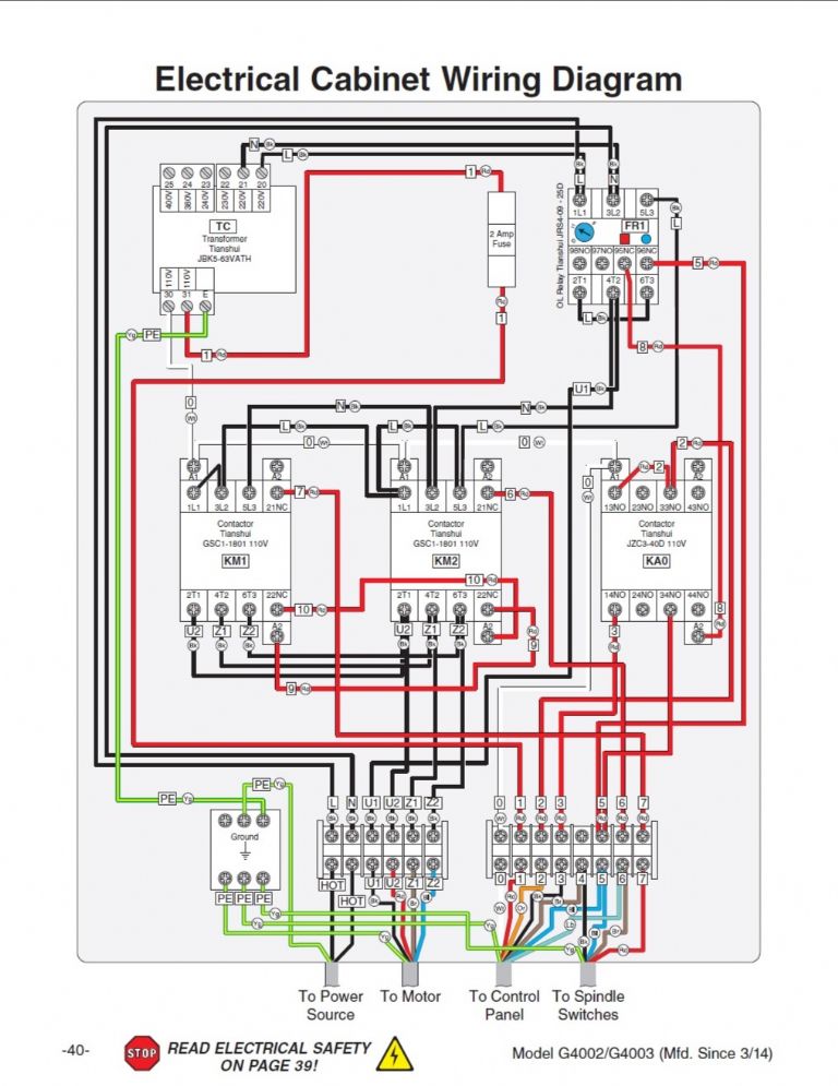

              Judging from pictures only, the Warco 1224 bears a distinctresemblance to the Grizzly G4002 lathe. If you have no luck with Warco have a look at this, taken from the Grizzly manual. (Obviously there are differences linked to the U.S. 110V supply and there is also a manual for models produced prior to 03/14.)

              Trevorh
                @trevorh
                Thanks John, its better than nothing
                So first stop check the mains fuse, the rest is quite straight forward to follow
                cheers
                trevor

                              It's a good theory, except John Haines' Hinkley's Grizzly Diagram doesn't show any suppression capacitors! Possibly there are some in the Control Panel circuitry.

                              John Hinkley
                                @johnhinkley26699
                                Dave,
                                Don't blame John Haines. That was my contribution in response to Trevor's original request as.nobody had come up with a diagram specifically for his machine.
                                John Hinkley

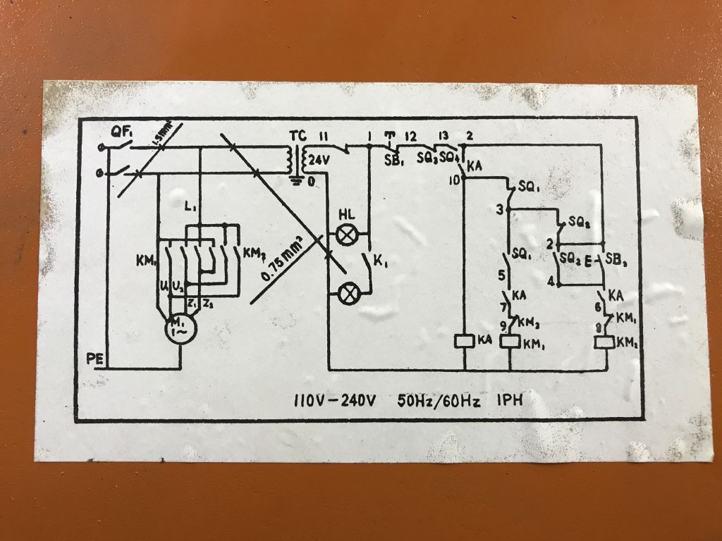

                                  When opening the back cover I did find this photo which shows the schematic is slightly different in that I have a couple of breakers and not a fuse or contactor
                                  #434292
                                  Trevorh
                                    @trevorh
                                    But by putting the schematic that john posted with my schematic it made it easy to understand how it had been wired
                                    so a very useful piece of information
                                    trevor

                                      Also I couldn't see any form of suppression on any of the contactors, I have uploaded photo's of the insides in an album,
