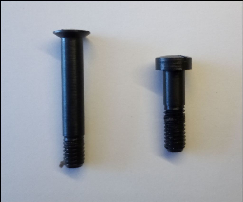

                  LH screw:-
                  o/all length = 37.3mm
                  Head diam = 10mm
                  M6 thread
                  Threaded portion (to the shoulder) = 9mm
                  Plain shank (under head to the shoulder above the thread) = 26mm
                  R.H screw:-
                  o/all length = 26mm
                  Head diam = 9.8mm
                  M6 thread
                  Threaded portion = 12.5mm
                  Plain shank = 9.5mm
                  Head thickness = 4mm
                  Max torque loading on these will be 4.5Nm
                  I think the above covers all the detail and I'd be looking for 2 off of each screw.

                    Those are stndard firearms components so take a look in one of the big gunsmithing catalogues or portals and you will probably find them there

                        Bob – You're correct in that they are standard gun screws but these are slotted head. I'm looking to replace them with SCH or Torx before the slotted heads get too chewed up. The screws are readily available as an upgrade in the USA but not in Europe. USA stores won't ship internationally because of ITAR (International Traffic in Arms Regulations).

                              If they are, indeed, gun smithing screws, surely the place to get them would be from a gunsmith? Dave at Whittlesey would likely sell you a couple of each. Probably slotted – they do not get damaged if treated properly with the appropriate turn-screw.
                              Then there is Elderkins at Spalding. Plenty of others, too. I’m thinking they might be for ‘scope mounts for the second example, although a bit big, maybe?

                                  The bolts are the bedding bolts for a CZ rimfire.
                                  Replacement screws (i.e. same ones) can be found in abundance but isn't what I'm looking for. As mentioned in my earlier post, what I'm chasing is to upgrade the bolts, replacing the slotted head with either SCH or Torx.
                                  Agreed, slotted heads do not get chewed up if treated correctly but 1. you don't always have the luxury of guaranteeing that previous owners have used the correct tools (it's secondhand) and 2. I've given up trying to find a 10mm wide screwdriver bit that fits in to a 1/4 drive torque wrench.

                                            By the looks of your screw on the left the tor’s or hex socket will be fairly small for the size screw as there is no real head to be able to rotary broach a decent size into. Surely the screw on the right is a straight mod from a shoulder bolt.?

                                              Tried Sterling Nut & Bolt in Peterborough without success (it was worth a try – thanks for the suggestion Howard).
                                              I've got some standard sized SCH screws so I'll adapt those. It won't be a perfect or pretty job but it'll at least get me to where I want to be.
