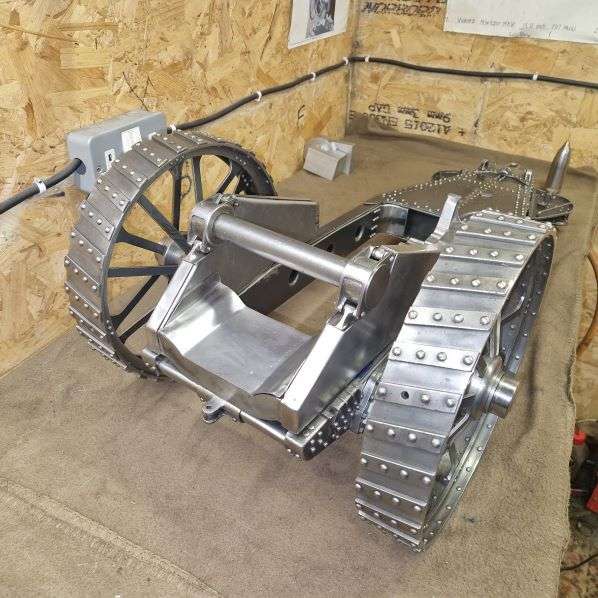

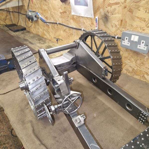

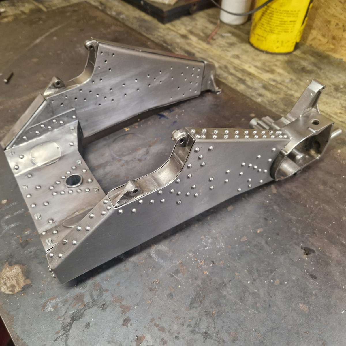

                    Hi all, it’s been a while, small update the Howitzer is back in the shed and I’ve made a small start on the  sheet work on the cradle,plenty still to get done on the sheet work and to build the left hand traversing slide, couple of pictures on how it looks.
                    Thanks Mal.

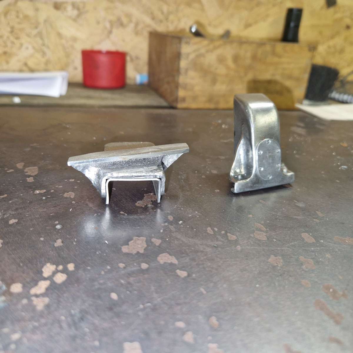

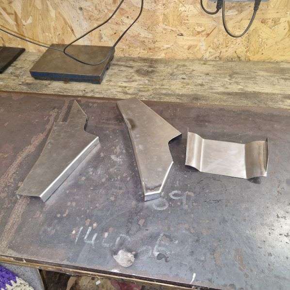

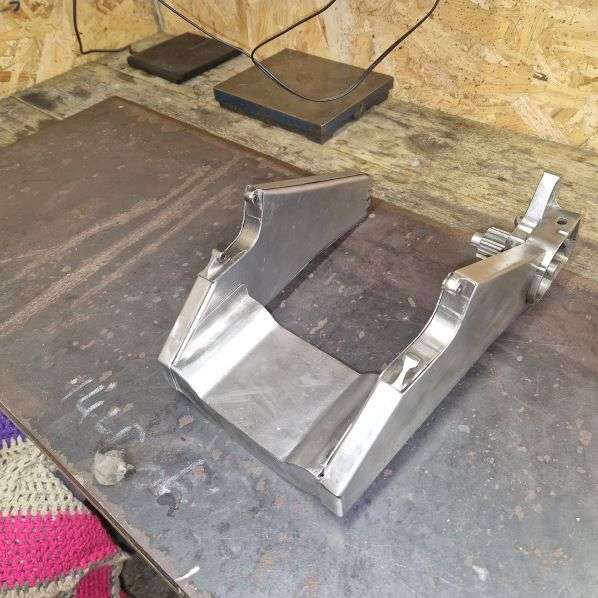

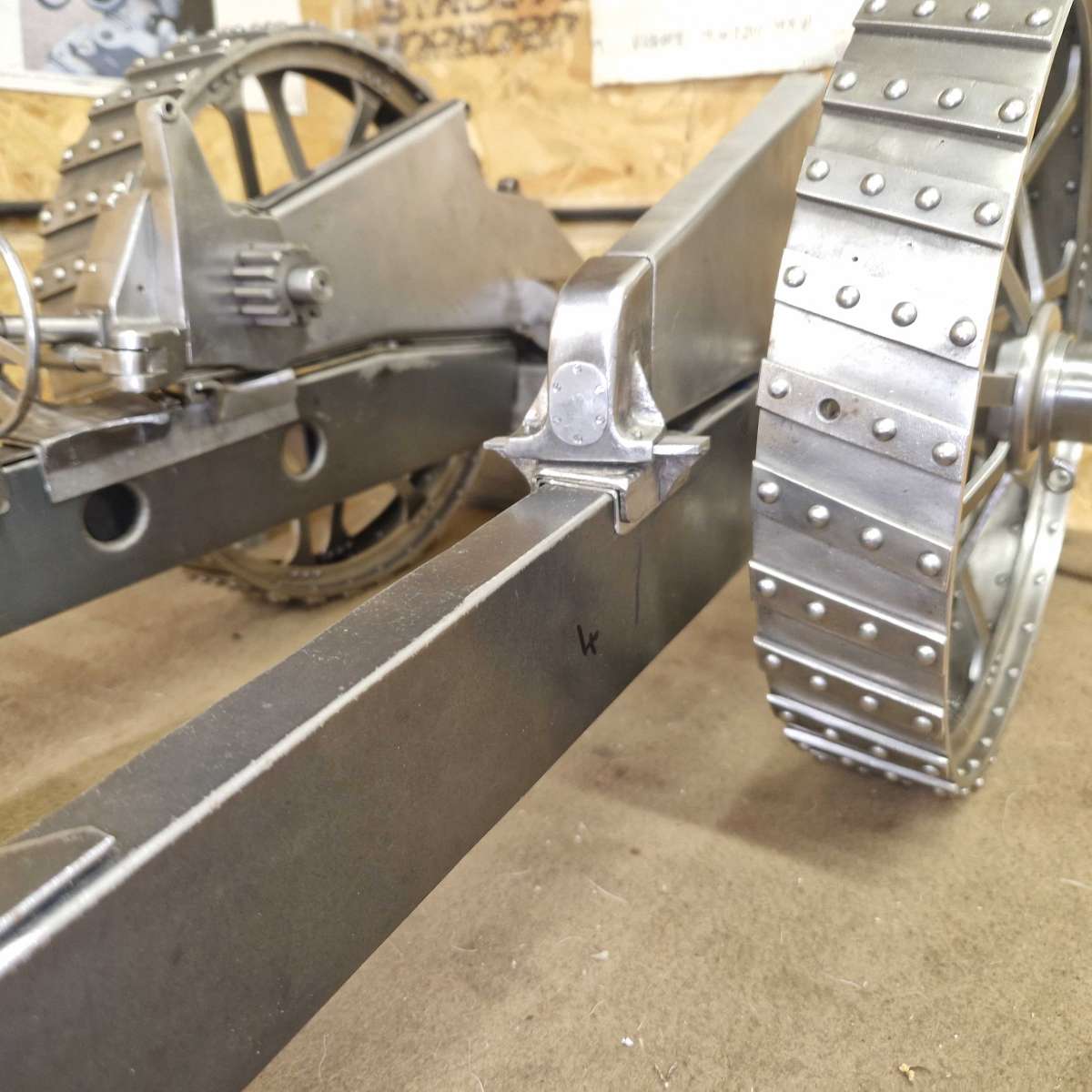

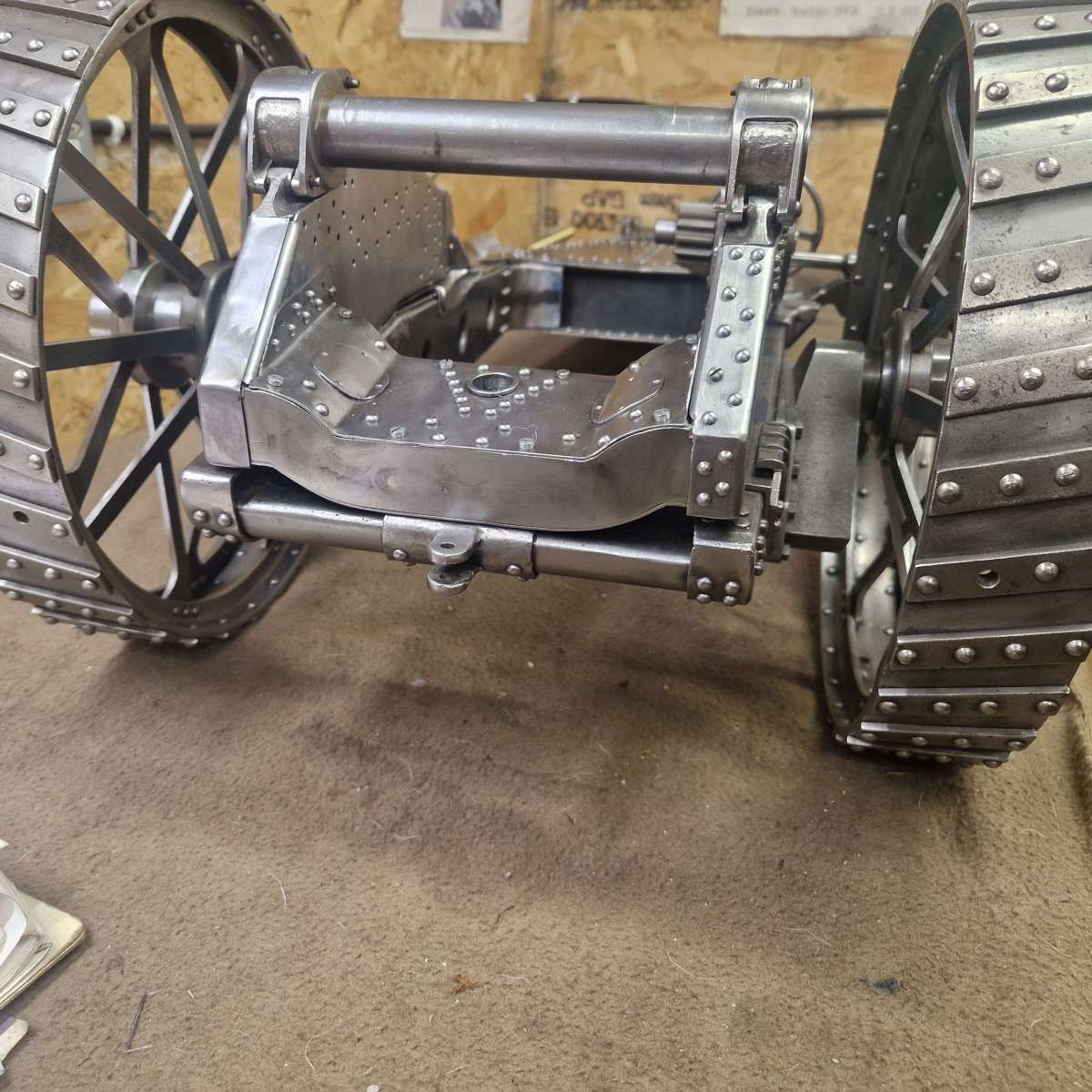

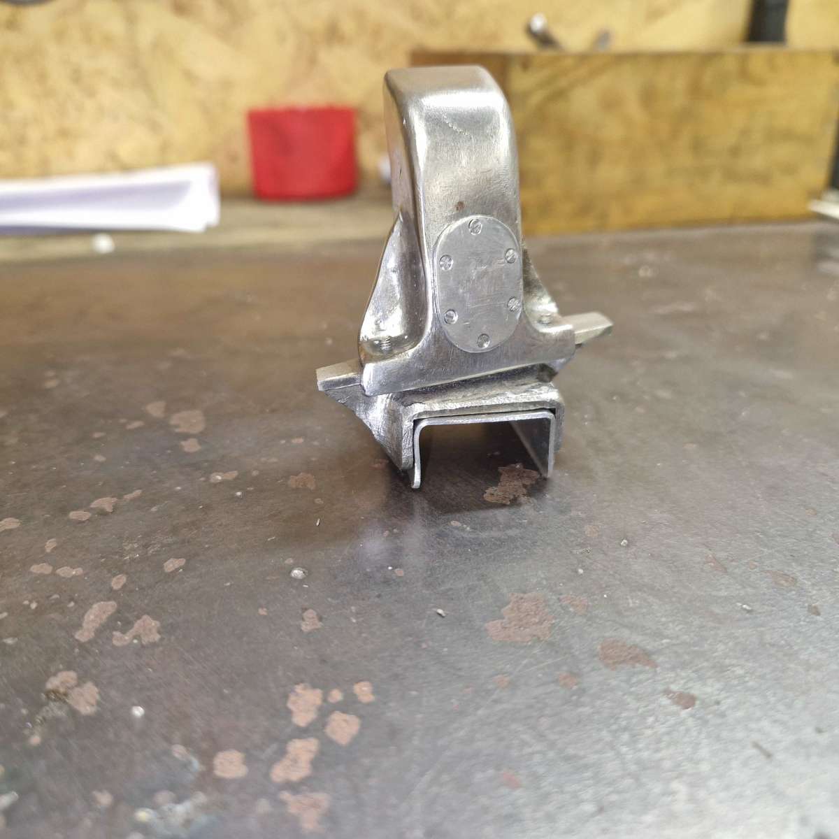

                      Hi all, I finished both sliding parts one to go on the cradle and other to attach to the trail ,both parts together allow for the 4 degrees transverse movement on the Howitzer cradle.
                      The part that attaches to the trail was made from solid, and the for the cradle was made from flat plate welded together and a bit of fettling to finish it ,couple of pics below on how things turned out.
                      Thanks Mal.

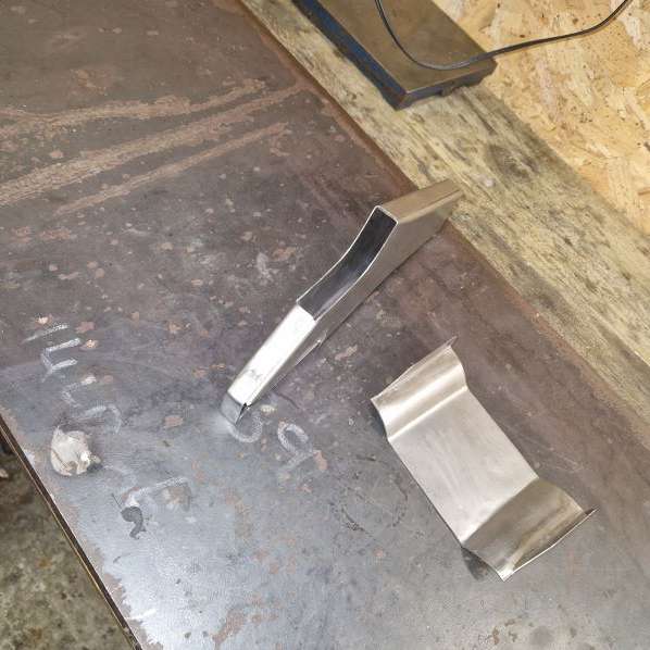

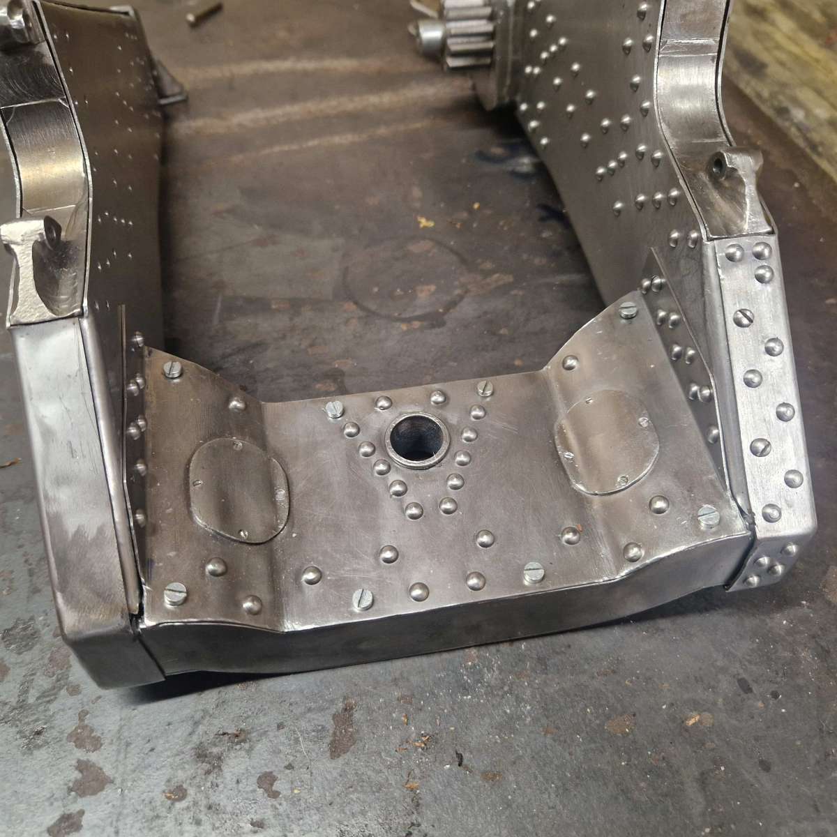

                          Hi all, small update on the Howitzer build. I’ve been busy on some detailing on the cradle with some rivets but now have run out so more on order to finish other side, the screws will be replaced with rivets on final fitment, after I finish other side it will be back onto trail to finish some fitments and rivets. couple of pics to see how it’s coming along.
                          Thanks Mal.

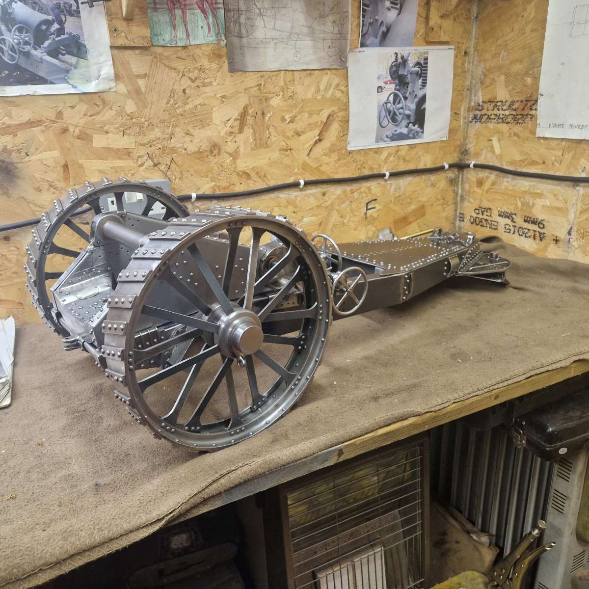

                                            Hi all , the bl8 build stalled a couple years ago as life just got in the way , a year ago i had health problems which made going into shed and using the machines little unsafe , but slowly on the mend and hopefully pick on the build when I feel ready to get back into the build.
                                            Thanks Mal.
