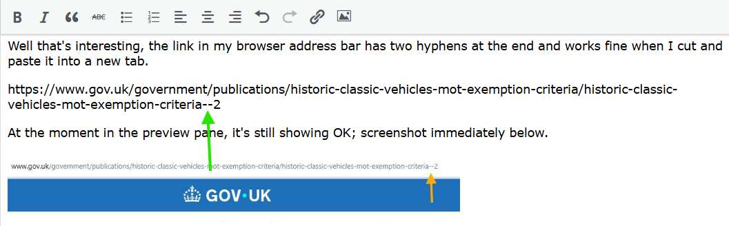

            peak4
              @peak4
              Well that’s interesting, the link in my browser address bar has two hyphens at the end and works fine when I cut and paste it into a new tab.
              I’ll paste it below>
              https://www.gov.uk/government/publications/historic-classic-vehicles-mot-exemption-criteria/historic-classic-vehicles-mot-exemption-criteria–2
              At the moment in the preview pane, it’s still showing OK; screenshot at bottom.
              This is what I copied>
              image_2026-03-11_215401513
              Lets see what happens when I submit; screenshot pre submit below
              image_2026-03-11_215654991
              Edit; yes, the forum software has deleted one of the hyphens.
              Bill
