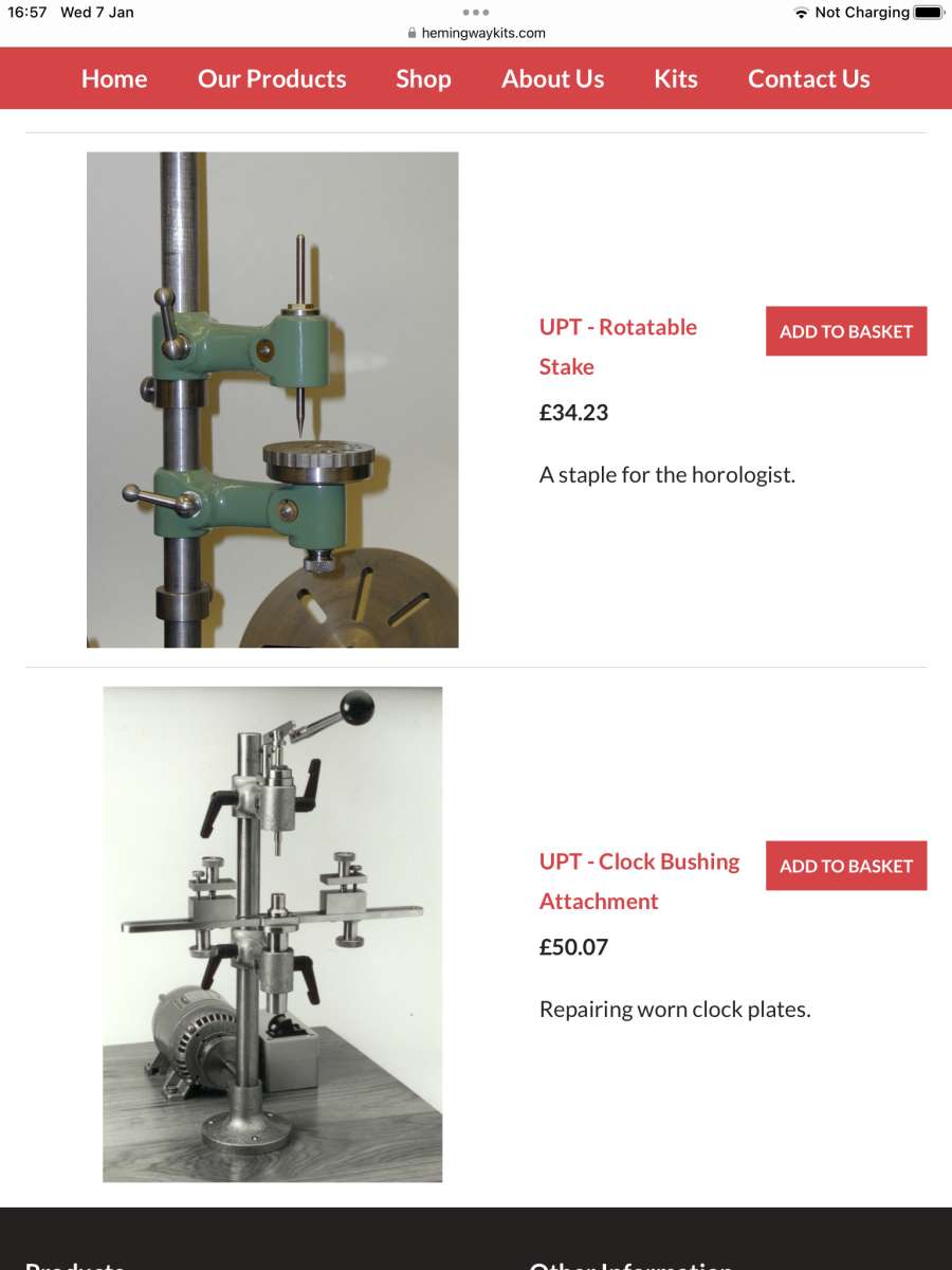

      Hi all, can anybody point me at plans for the clock bushing attachment to go with the universal pillar tool?
      Apparently there is an in depth book about the pillar tool by George Thomas which includes it, but the only copy I’ve seen was going for 80 odd quid.

          Nothing about clock bushing tool in either Building the UPT or the Red  GHT workshop book that I have but would be interested if anyone finds it. Perhaps you are thinking of the one on Reeves 2000/Hemingways site?

              Hemmingway do a kit for the bushing tool add on to the UPT, but they say “We are indebted to Mr James Batchelor for this design”, and include the construction notes and drawings in the kit. So it looks like its not one of George Thomas’ designs.
              From the image on Hemmingway’s website the bits look fairly simple to design. There is a similar kit sold by Sherline as an add on to their mill for clock bushing which may give you some ideas.

                  The top half of the Batchelor bushing attachment looks like the same casting used for the sensitive drilling attachment.  Would you need anything better than the drill lever downfeed for inserting bushings?  I have no experience of bushing plates except seeing Steve do it on the Repair Shop.
                  Rod
                  Edit – looking more closely, the bushing tool seems to adapt the normal UPT arm.

                        The standard UPT only uses 2 arm castings which are identical.  The Sensitive Drill addition uses a 3rd arm casting which differs in providing a support for a pillar for the drill downfeed lever and an attachment face for jockey pulleys.  It looks like Mr Batchelor has adapted the principle of the drill downfeed lever to fit on to the normal upper arm and designed a plate support for the lower arm.  Even though the bushing tool is not in GHT’s book, looking at the details of the Sensitive Drill found in the book and the picture of the bushing tool on the Hemingway website will probably supply sufficient information for manufacture.
