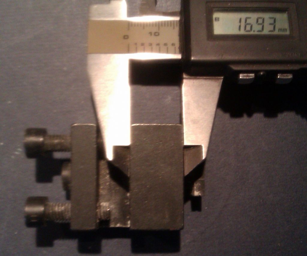

        I have some unimat parts I'm converting back into a usable lathe. Could some kind soul who has one measure the height of the bottom of the tool slot to the top of the carriage for me please? I'll have to make the tool post.

          Dug out my old unimat from the pile in the corner and got 5.81 to 5.85 on my digital caliper as far the thickness of the bottom of the toolpost is concerned

              I get 16.9mm on a U3 fixed single tool post, that suits the 6mm toolbits with a small packer.

                      Thanks for the replies. Mine just says it's a Selecta Unimat, but definitely old style. Actually I'm thinking of making a quick change design but wanted the basic dimensions as a starting point.

                          Hi John, thanks, it sounds like 6 mm nominal is the thickness for the old style from Ady's reply. I have a cnc lathe and 2 mills, one being cnc, but sometimes it's nice just to have a simple lathe for small quick jobs!
