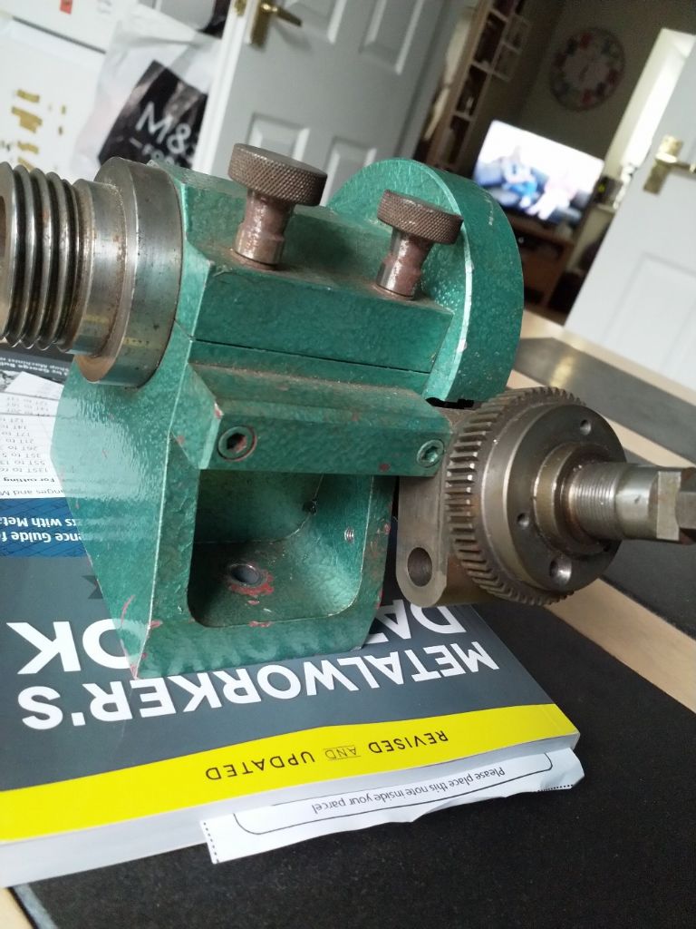

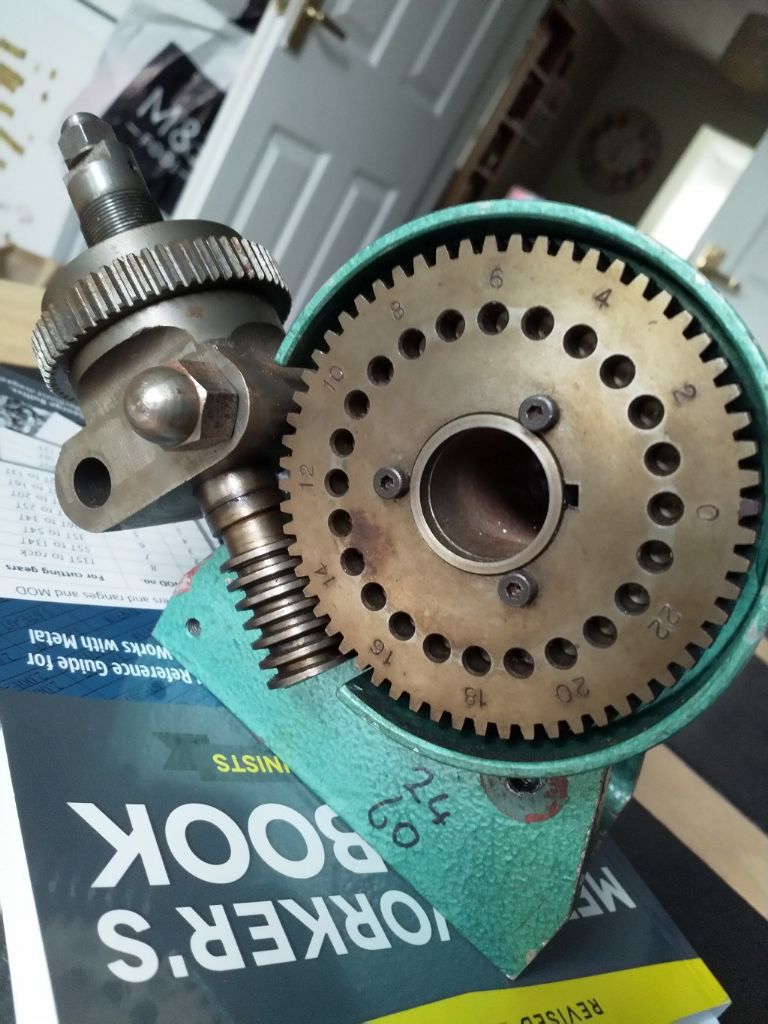

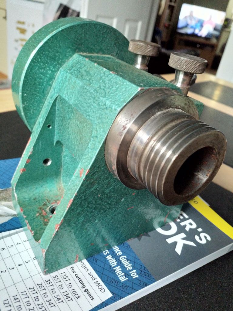

      Is anyone able to identify this incomplete dividing for me. I picked it up locally cheap with the intention of trying to complete it or attempt to turn it into something useful. It was sold to me as made from a kit and GH Thomas plans in the book workshop techniques, however from pictures I can find on the Internet it looks a bit different to the GHT one.
      Dividing is a new thing to me but I gather knowing the ratio of the turns is important. It appears to be 60:1 and the plate on it has 24 holes. Apparently the thread is to suit a Boxford chuck.
      I'd love to get it functional if I can by making or buying what is needed but first I need to know who's plans it was made to.
      Thanks, Simon

              It's a George Thomas versatile dividing head but the maker has fabricated the body. Do you have any plates or the rest of the micrometer adjust worm ?
              regards Martin
              #490994
              Simon Barr
                @simonbarr48213
                All I have is in the photos. I was hoping that once I have identified which design it is I may be able to fabricate/buy any other parts I need. I made a gamble buying it but hopefully I can put it to use somehow. It appears to be well made, I've just got back in from the garage and dismantled it as far as I could the inspect it.
                If you think it's based on the GHT design then I at least have something to go on in my research. Thank you.

                  The worm assembly is certainly GHT. I made the Headstock Dividing Attachment which uses the same dividing plates, sector arm and micro adjustment as the Versatile Dividing Head.
                  In a similar way to the original maker of your DH, I adapted a base, in this case the Timmins, to take the GHT stuff.
                  Your base looks very nicely made, possibly milled out of a solid lump. You will see that I have also made it possible to do direct indexing in the holes as well as via the worm and wheel. GHT's Dividing and Graduating is available second hand **LINK** somewhat cheaper than buying the compendium Workshop Techniques.
                  Hope this helps,

                    Nice. If you make the fine adjustment worm and graduated thimble to fit on that second small worm gear, you can use it to generate its own indexing plates using GHT's diabolically cunning method.
                    Have fun drilling all 812 holes. And then chamfering both ends of each hole. 😁

                        The Hemingway Kit Versatile Dividing Head appears identical to that in GHT's book "Workshop Techniques". As GHT includes drawings in the book for making your own patterns to get castings done, I think Hemingway still uses his original design.
                        However, GHT does mention in the book that his was not the first VDH. That was made by his friend, referred to only as "A.B.", following discussions with GHT. He writes that that A.B. "made it up from available materials". GHT then went on to design and make his own version with its own castings, appearing the same as today's Hemingway kit.
                        Could this one above be the original pre-GHT prototype made by the mysterious "A.B."….?
                        Either way, all the running gear as described in GHT's book should work for you. It appears to be only the casting that is different. The fine adjustment attachment and the indexing plates should be the same.
                        Or if you just want to get going and use the dividing head, a set of commercially available indexing plates from any 60:1 ratio dividing head should be able to be adapted to fit. Costs about 40 quid for the three plates with the crank arm and plunger and sector arms.
                        Albeit, the 24 holes in the side of the main gear will do most jobs if a suitable bracket and plunger are made up so it can  be used as a spin indexer basically. Also, the 60 teeth of the gear with a suitable plunger can be used to get a few more numbers of division done, such as 5, 15, 30, 60 etc.

                          What is the centre height?
                          Looks to me like a hybridised Geo. H Thomas VDH / Tom Senior design re-worked for home construction by carving from solid and sized to match a Boxford or SouthBend 9" clone.
                          Basic layout follows the Tom Senior design, which also used a Boxford compatible spindle nose, but the worm drive and carrier arrangement is GHT.
                          Way back I looked into fitting a GHT drive set up onto a Tom Senior head that had lost its original worm drive and plates. From memory the size and relative dimensions from your pictures look similar to my concept sketches. Objectively the over the top arrangement of the GTH worm drive isn't completely ideal but made necessary by size constraints. With a slightly bigger device the Senior arrangement is preferable.
                          Nice unit but I'm surprised that the builder used a simple split body and closing screws to clamp the spindle rather than the GHT floating collet system.
                          Clive

                                  As already mentioned at least twice, the body looks like it is milled from solid rather than a casting which would suggest that it is a one off shop made item. In the days before cnc, it was much more cost affective to buy in batches of castings for finish machining than milling from solid.
                                  When I was in aircraft engineering making parts for Airbus amongst others, we made lightweight brackets which were part of the undercarriage, they carried hydraulic and electrical lines. They were castings, and did not require much machining. However, it turned out to be cheaper to mill them out of solid rather than pay for the castings and £100 each for the mandatory X ray when the solid ones could be NDT tested in house. Only using CNC machinery could the saving be made, plus a lot of swarf, (about 90%, I would estimate).

                                      Thanks everyone, it's all becoming clearer for me now. My initial confusion was because it looks very different (Body shape) from the Hemmingway kits causing me to doubt if it was a GHT design or not. Also to clarify the body does appear to be milled from solid and the centre height is approx 3" or 77mm measured in a quick, not very precise way.
                                      As it seems to be universally agreed that it is GHT design in part I feel positive that I can get it to completion in the future. With that in mind I found a copy of the book Roderick mentioned on eBay for £6 so I have ordered it. When that arrives I'll have a set of drawings that I can compare to what I have already and draw up a list of what's needed.
                                      As for dividing plates I will maybe use my mill once I have installed the DRO currently sitting in boxes as it has a PCD function. But I may change my mind once I see GHTs text in the book.
