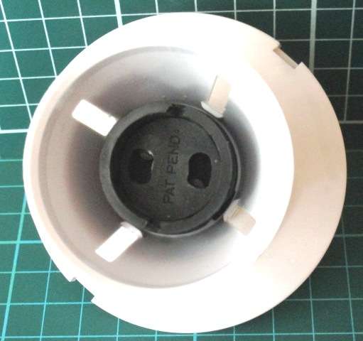

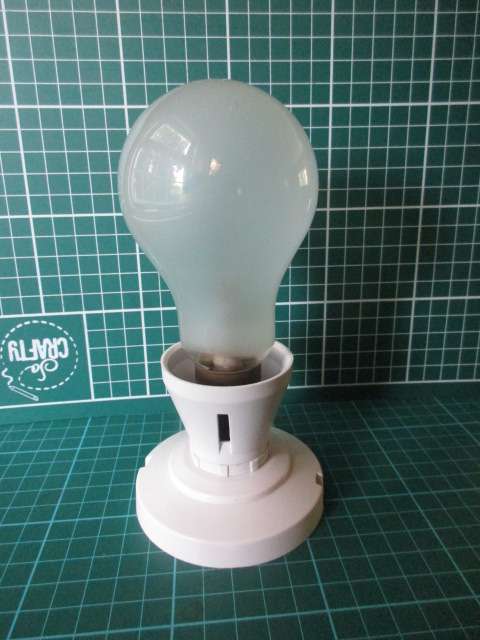

                Hi Martin, yes I can remember those incandescent light bulbs, and I’ve still got a dozen of each 60 & 100 watt unused ones, along with a really old 150 watt one that still works, all of which are Pearl ones.
                001
                The socket it’s in is quite interest, as it has an integrated switch, which can only be operated when a bulb is inserted, therefore you can’t get an electrical shock if you stuck your finger in it, if the light switch is left on.
                002
                As you can see, the two pins are mostly covered without a bulb in place, and both are disconnected from the electric supply.
                It has 2A with T2 underlined with 250V ~ and BS EN 61184, and HS9696, moulded into the plastic. I’ve never seen one of these before.
