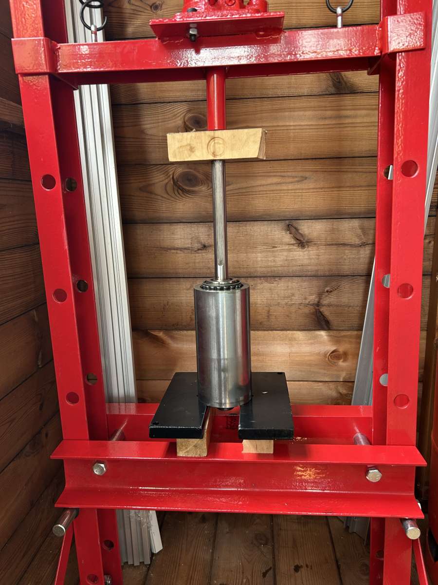

                              I can update, unable to bear the torment of not knowing any longer I found some suitable looking tools and just went for it.
                              In fact it is a surprisingly simple process to remove the quill from the Twinmill and it does, quite literally, drop out of the head once the the rapid feed arm and spring return plate are released. I will post pictures and full description later tonight.
                              As I tilted the quill upside down to look at the spindle nose I was astonished, in many ways, to find I had tipped about 10cc of grimy looking oil out of the quill onto my foot! The oil wasn’t particularly thick about the same as you put in old cars, it was rather dark and turbid but no evidence of metal flakes. No grease in sight, whoever owned it previously was clearly using oil as maintenance. Judging by the amount, the lower bearing would have been submerged in medium oil.  Perhaps too much oil is as bad as too much grease?
                              Getting the spindle out of the quill required the press, but was straight forward. The bearings were clean, bottom bearing was only oiled and only a little residual grease on the top cone. Both looked undamaged, no sign of brinelling, deformed cages or untoward wear. There is a bit of polish on some rollers to about the same degree on both bearings. The shells looked perfect to my eye. There was no sense of any roughness when manually turning the spindle in the quill. Even with the oil removed, the bearings feel smooth when fully seated in their shells and rotated by hand. The shells look properly seated, the cones were not loose on the spindle and the spindle is perfectly straight. The spindle oil seal was in good condition.

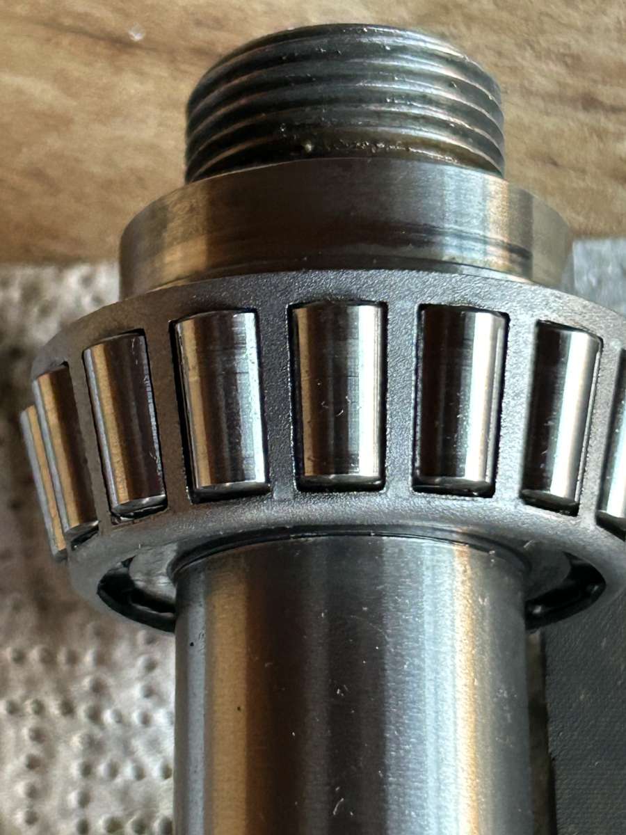

                              I have no idea how to assess what is unacceptable wear on cup and cone style taper roller bearings, but they look OK to me. The bearings are SKF 32206A, not particularly expensive but don’t want to spend £40 unnecessarily (particularly as James reports that replacing his bearings has not solved the heating issue). Also, it will be a bit of a task to extract the bearing shells. So for the time being I shall put a thin smear of grease on both bearings restore everything to original condition and hope for the best.
                              It’s a mystery.

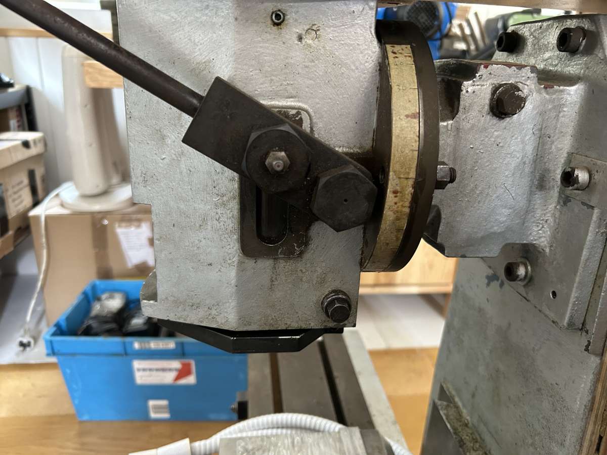

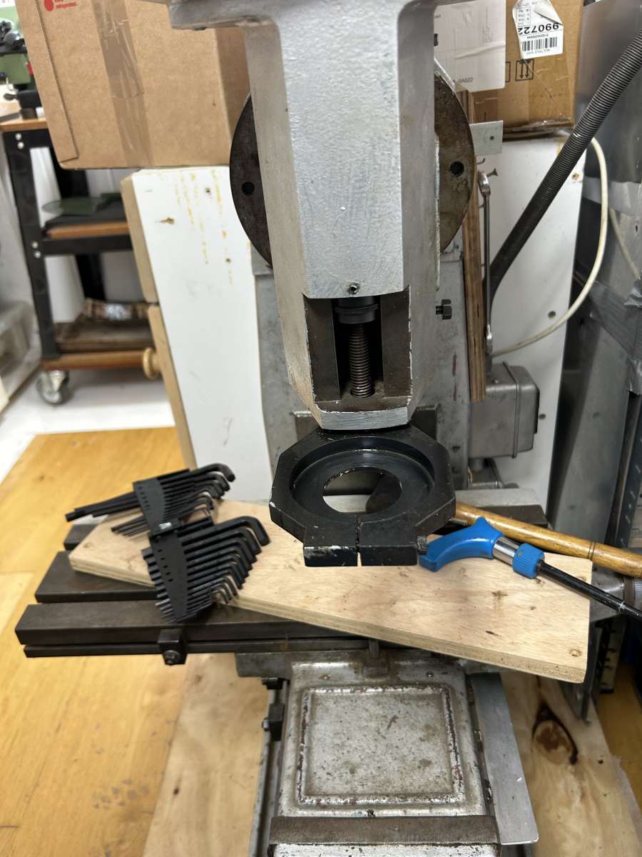

                                    Thanks James, set out below are steps to remove quill.
                                    IMG_0269
                                    First remove the quill rapid feed lever by undoing the two large nuts, then loosen off the quill clamp nut at bottom right of head giving a slight tap to ensure split collets are not stuck with congealed grease etc.
                                    By the way, if you feel compelled to oil or otherways lubricate the bearings, use the grease nipple for the lower set and pull down the quill rapid lever and this will expose the top of the upper bearing for you to point the oil can at. The grub above the slot I suspect has something to do with the spindle pulley bearing assembly – a battle for another day.

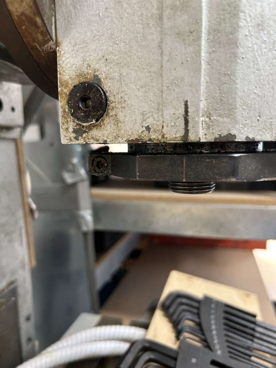

                                    IMG_0271
                                    Next slacken clamping allen bolt at rear of quill clamp return collar,  seen here on the black plate directly below the left side of the quill clamp lock nut.
                                    IMG_0272
                                    Then, with your 3 hands, simultaneously slide a screwdriver into the slot in quill clamp return collar to loosen its grip on the quill while pulling down on the quill clamp collar and pushing up on the spindle so the collar can be pulled clear of the spindle and rotated forward out of the way. At this point, the quill and spindle will drop like a bunker buster and hit the piece of wood that that you thoughtfully placed on the table before you started. If you happen to have a fourth hand, you may able to catch it, but it is heavy and oily!
                                    Picture shows the position of quill clamp plate after quill has dropped out (and been recovered).

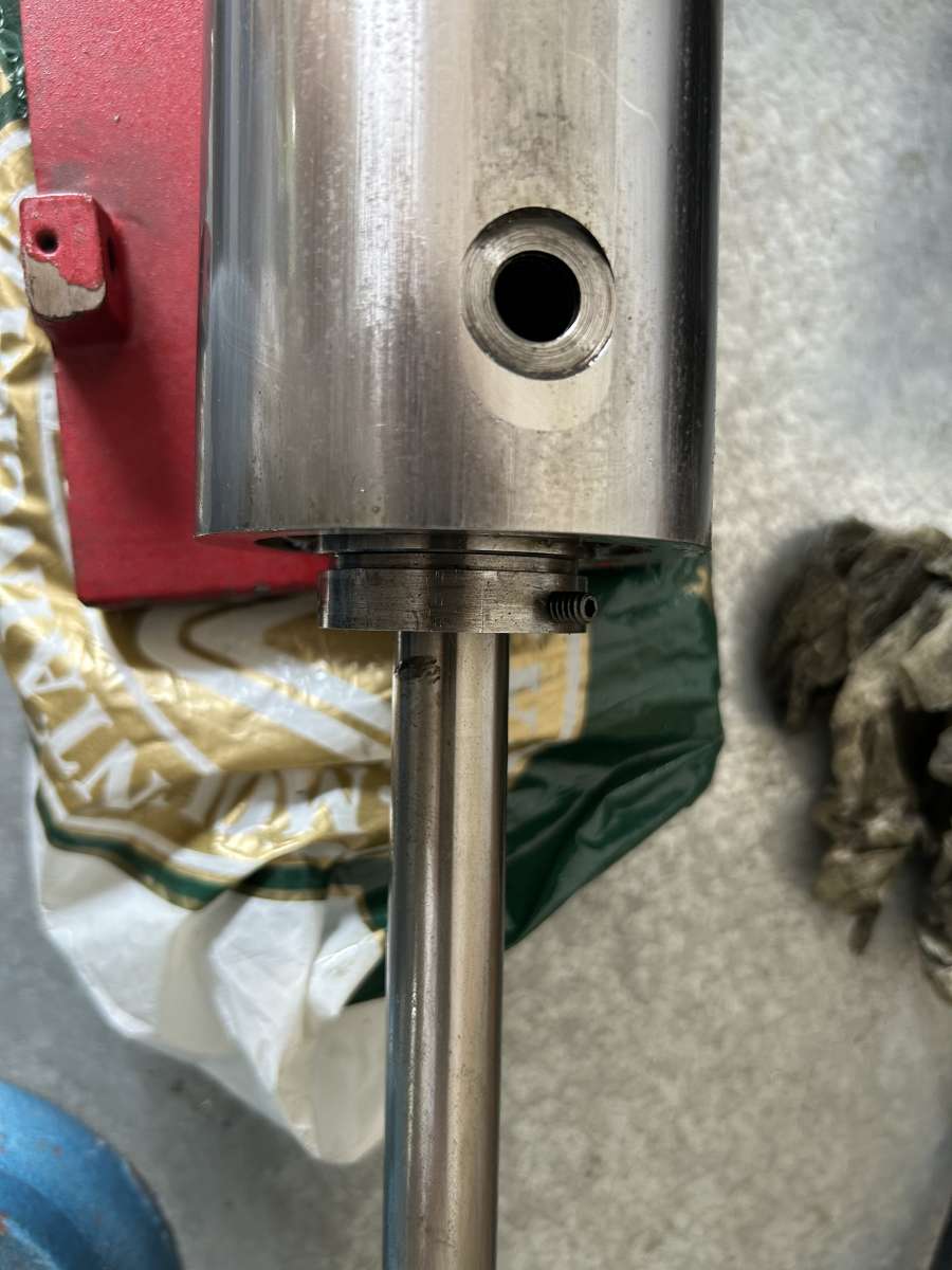

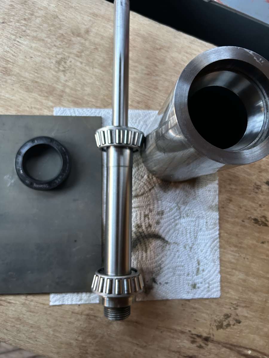

                                    The quill and spindle, freely dribbling oil everywhere, showing bearing pre load collar, need to unscrew grub and unscrew  collar using C spanner.
                                    IMG_0277
                                    Extracting the spindle and bearing cones using press (Hangs his head in shame at the dodgy set up but it did the job).
                                    IMG_0281
                                    The spindle and bearing cones, oil seal and quill body.
                                    Note no grease, just oil.
                                    IMG_0279
                                    IMG_0280

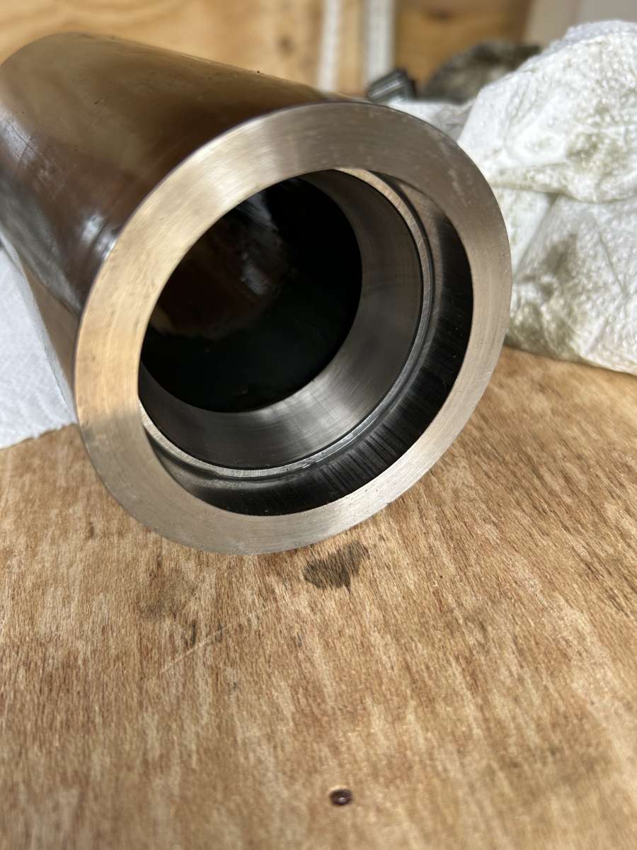

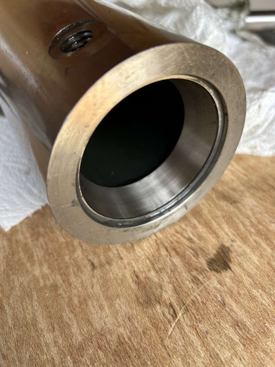

                                    Lower and upper bearing  cups. They are perfectly smooth despite the appearance of marks, no ridges or scoring evident just burnish from some use.
                                    IMG_0283
                                    IMG_0282

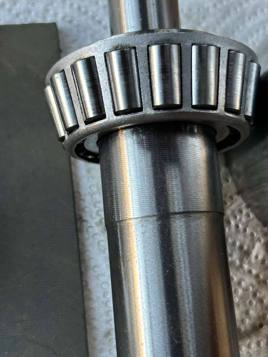

                                    Lower and upper bearing cone with oil wiped off. Looking pretty good to me, just some slight burnish.
                                    If both ends of the quill had been getting hot, I would consider too high a pre load, but only the lower end gets hot, specifically the spindle nose and the heat build up is very rapid at 2000 RPM and above. This and the fact that the heat dissipates very rapidly may point to another hypothesis. Someone might suggest it too, far-fetched though it may be…

                                            Mill quill now re-assembled, bearings greased relatively lightly in the best vintage Castrol LM, all rollers coated but but void space not completely packed. In any case, with this type of cup and cone arrangement over packing  probably wouldn’t matter much as excess will just get squeezed out top and bottom of the bearing.
                                            Bearings pressed into place with the last mm left for the pre-load nut. Tightened down until all play removed but smooth rotation to the spindle maintained. Timkens suggest you crimp ’em down till they squeal and cant move, then back off a quarter turn – macho stuff from the good old days eh! but not for me.
                                            The shaft oil seal WAS NOT replaced in order to test the effect of omission on spindle running temperature.
                                            Just to recap, before all this rigmarole, at middle speed or 1300 RPM, the spindle nose would become too hot to hold after 5 to 6 minutes, but at least seemed to stabilise at this high-ish temperature. At 2000 and 3000 RPM within a couple of minutes the spindle nose became alarmingly hot as in capable of giving a nasty burn.
                                            Testing without the seal gave the following results:
                                            All 3 speeds up to and including middle speed, ie 300 600 1300 RPM, minimal temperature change after running for 6 to 7 minutes and stable.  At 2000 RPM, very slight warming of both bearings, but temperature stabilises below blood heat.
                                            At 3000 RPM there is a temperature build up over 5 minutes to what I would guess to be about 45C ie, at the level of a hot bath. The  temperature seems to stabilise at at that level beyond 5 minutes and both bearings are equally affected.  This seems quite acceptable for 3000 RPM.
                                            So there it is –  the main culprit all along was the shaft oil seal, which at 3000 RPM was busy converting about 15 to 18% of the motor output into heat for the spindle, if the generative AI analysis is correct.
