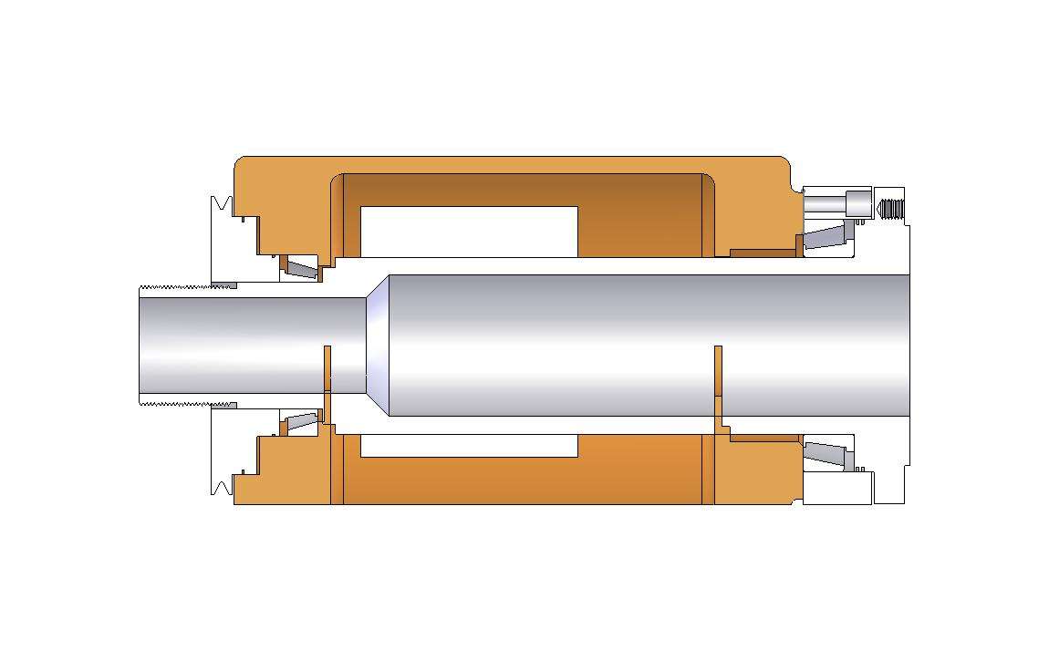

                                                #871557
                                                Niels Abildgaard
                                                  @nielsabildgaard33719
                                                  I am trying to think of a simple way to give an external reference to lathe (Boxford maybee?) centerline as shown on photo.
                                                  Rules are:
                                                  Do not disturb existing bearing bores .62mm shown and 72 and 76.2mm for Boxford
                                                  Do not remove headstock from lathe bed.
                                                  A Boxford owner can do the utmost for humanity by taking a like picture that is spindle end and alu dust shield removed
                                                  last page
                                                  https://forum.zerspanungsbude.net/viewtopic.php?f=43&t=70825&start=20
                                                  Click on pictures fore resolution
                                                  #871564
                                                  Niels Abildgaard
                                                    A sketch of nessecary changes on a Boxford headstock to allow a much better spindle.
                                                    The two grease traps on inside of bearings have to be removed and turned to 50mm plus say 0.1 to o.2mmand 70 mm plus same clearance
                                                    Some clearance for front bearing roller cage but not crical
                                                    Front face has to be ultra flat and concentric with bearing bores.
                                                    Rest is piece of cake.
                                                    boxrevolution
                                                    #871605
                                                    bernard towers
                                                      @bernardtowers37738
                                                      Isnt that a bit like fitting a V8 but not doing the brakes?
