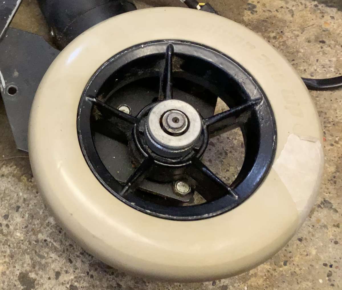

      Hi guys, a  long time since  have been on here looking for help.
      I have built a full size motorised Dalek, the motors and wheels are from an old Sunrse Medical Powered Wheel Chair. A while ago the wheels started to deteriorate and I was able to buy replacements from here:
      https://discountscooters.co.uk/products/colson-200-tyre
      One of these replacement wheels has now developed a crack (after about 2 years). On the website linked above the wheels are now out of stock.
      I am struggling to find a a replacement solid rubber tyre anywhere and decided to take a look at how to make my own.
      I have done loads of 3D printing in the past and thought that maybe there were now rubber style 3D filaments. It appears that there are but so that may be an option.
      I then considered molding using two part silicone or something suitable. I have never made a mold or molded anything before.
      All I have is one good tyre on one of the wheels and if I can remove it without damaging it, I am seeking help in how to make a mold of this tyre.
      Does anyone on here have any experience with molding silicone?
      Many thanks

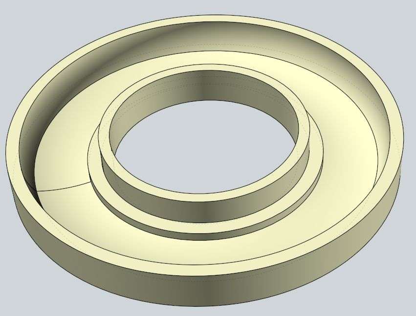

            If you can 3D print, could you model and 3D print two halves of a mould for the tyre. Clamp them together and fill with your silicone rubber. Suspect PLA would do.
            Something like this
            Tyre Mould

            DC31k
              @dc31k
              It is a very small word that ‘fill’, but it seems to me that it is doing a lot of work here.
              The mould and stopping the ooze escaping is the simple part. Putting it in in a way that does not leave voids or air bubbles in the cured product would appear to be the challenge.
              FWIW, the My Mechanics YouTube channel cast a set of tyres for a child’s scooter, so some of the techniques shown there might be educational.

                        On Fulmen Said:
                        You might want to look for castable polyurethane, it’s about as strong and durable as it gets. I’m sure you can cast it in a 3D printed mold.
                        Printed TPU should also be a viable option. It’s not the easiest to print but I’ve had good luck on my CR6 (improved Ender 3) so it’s not impossible on a simple printer.
                        Yes, in this video I found they used Polyurethane rubber. Also looked at TPU, but I don’t have a decent 3D Printer at the mo. I do have my first ever Anet A8, which still works, but the build plate is only 200 x 200 IIRC. Might look out for a second hand Creality. I used an Ender 3 at school (where I have just left teaching), good solid machines.
                          Something like this
                          Tyre Mould
                          Yes I think that will be the plan. Don’t have a 3D printer at the mo and was considering making a mold of the good rubber tyre?

                            Can’t you just turn 2 halves out of wood, give them several coats of gloss paint then smear with furniture polish as a parting agent

                                Yes I could buy any castor wheels if this where a push along Dalek, however it is motorised. The wheel that I need the tyres for are the drive wheels. If you look at the image in my first post, the silver bit in the middle is a spring loaded external lock that twists and locks the wheel onto the drive shaft.

                                  Wooden wheels? This is a full sized motorised Dalek and is pretty hefty, so we need some traction and suspension. this was a short video before it was painted:

                                        I meant a wooden mould, hence the reference to parting agent
