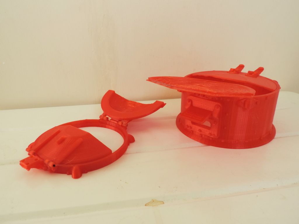

                                          Out of interest only, TurboCAD does export to STL, so I design all my 3D prints using it:
                                          Turret rendered in TC:
                                          The hatch and cupola from the above printed:
