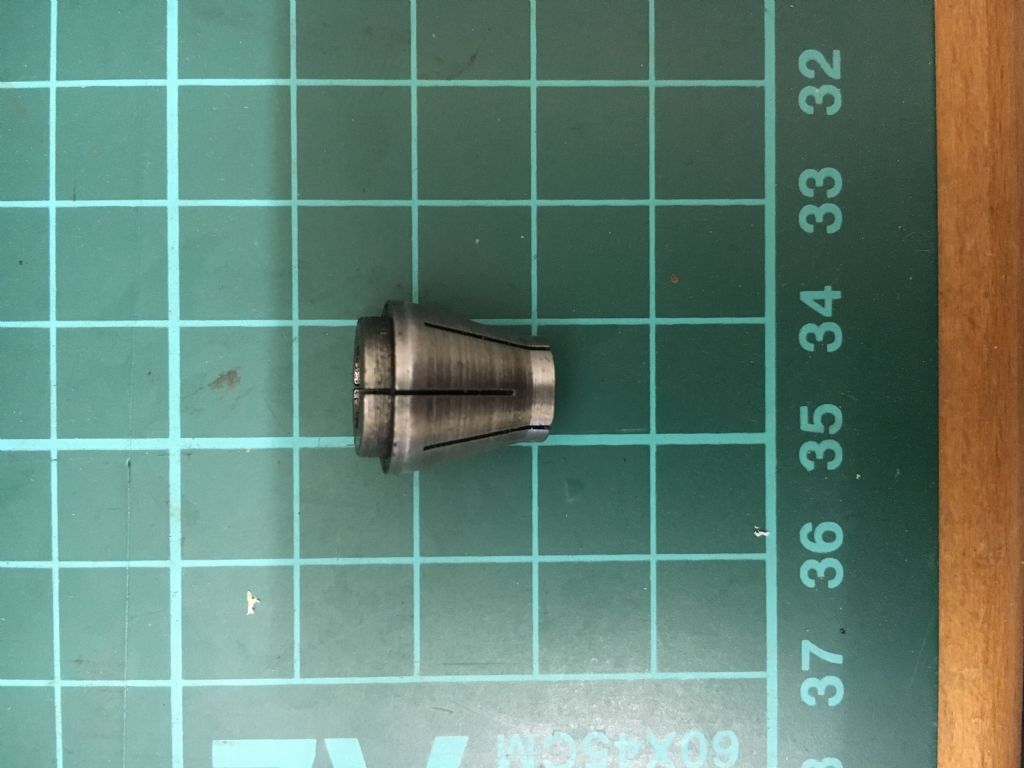

      Hi,
      Total beginners question, but can anyone help me identify the collet below? It’s out of an old mill (unbranded / homemade?)I bought off eBay.
      Dimensions are:
      – widest point : 0.52” (13.3mm)
      – ‘neck’: 0.42” (10.6mm)
      – overall length: 0.57” (14.5mm)
      I've only got one, so any advice as to where I can get more (UK) or a starter set would be very welcome!
      Thanks in advance
      Ross

          Sorry, image dropped off

            Welcome Ross, I'm afraid you will have to explain a bit better, I presume you have a mill. You could try googling milling collet systems, a picture will probably set you on the right track.

                    Ross,
                    I don't think I've seen that one before … but you might find something similar in here: **LINK**
                    http://www.rotagriponline.com/datasheets/5C.pdf
                    [don't worry about the 5C filename, it's a full catalogue]
                    The problem is … Crawford don't make the wide range of designs that they once did.

                      Looks to be from a Marlco or similar indexing unit often used on horizontal mills, have a look here to see a set – no indexing tool though **LINK**
                      #415487
                        That's what I wondered, John … but are the Marlco ones slit from both ends ?
                        Age-related brain fade is getting to me sad

                          Taig / Peatol lathes and small mills. **LINK**
                          #415511
                          Baz
                            @baz89810
                            Agree with John Haine, that is Taig / Peatol available from Peatol or MEDW as they are used on the CNC micromill. I think the largest size is 1/4 dia.
                            #415512
                              Posted by John Haine on 22/06/2019 07:27:02:
                              Looks like it, John yes
                              http://www.jeffree.co.uk/Peatol/accessories.html

                                Ross, I sent you a PM.

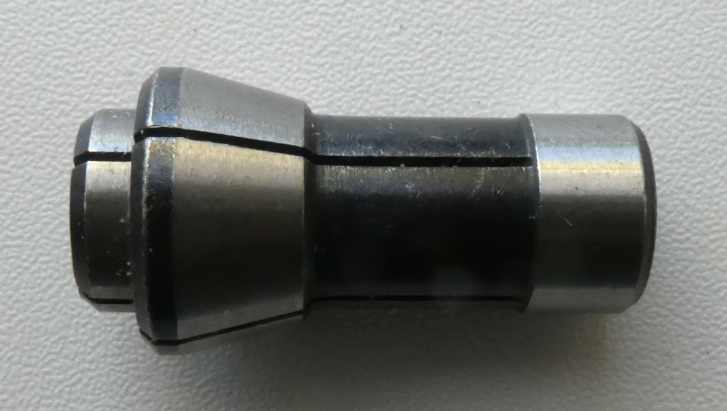

                                  I have a left over set of those collets from my old peatol – long since moved on.
                                  Here is another type altogether – this is a 1/4" collet.:
                                  Overall length = 27.00mm
                                  Rear locating register diameter = 9.98mm
                                  Any ideas what for?
                                  Rik
                                  Edited By Rik Shaw on 22/06/2019 10:35:08
                                  #415594
                                  MichaelR
                                    @michaelr
                                    Rik, Your collet looks if it may be for a Die Grinder Link
                                    Mike.
                                    Edited By MichaelR on 22/06/2019 17:02:55

                                      Appreciate all the comments / suggestions, thanks all.
                                      Mine looks like an older version of the Peatol mill and definitely those collets.
                                      Nice to have such a helpful response to such a basic question.
