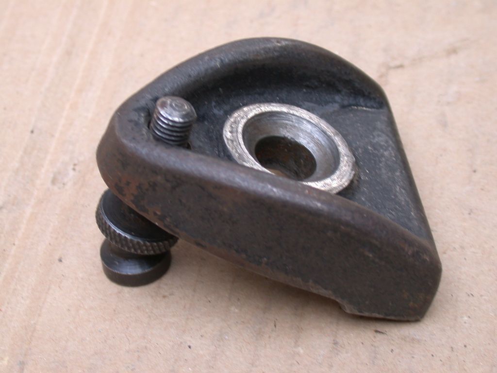

                      My S-7 came with a black painted triangular cast block with a height adjusting screw under one corner with a knurled disc fixed to middle of screw. The opposite side was a thicker, machined part which pressed the tool down upon the topslide. Centre of triangle had a hole where it fitted over the vertical stud mounted in the topslide. A light spring fitted on the stud under triangular tool clamp which was held down by special nut like you have described. Reason for curved underside of nut was so it fitted neatly in matching recess in top of tool clamp. This enabled varying angles of tool block to accomodate differing thicknesses of lathe tools and still provide secure clamping. Sorry this seems a bit long-winded but I wanted to describe whole attachment in detail. Hope this helps.

                      Robbo
                        @robbo
                        John,
                        That sounds like a description of the standard Myford toolpost clamp, like thismyford tool post clamp.jpg

                            Robbo.
                            You are quite correct, but my post actually started with "My S-7" etc.
