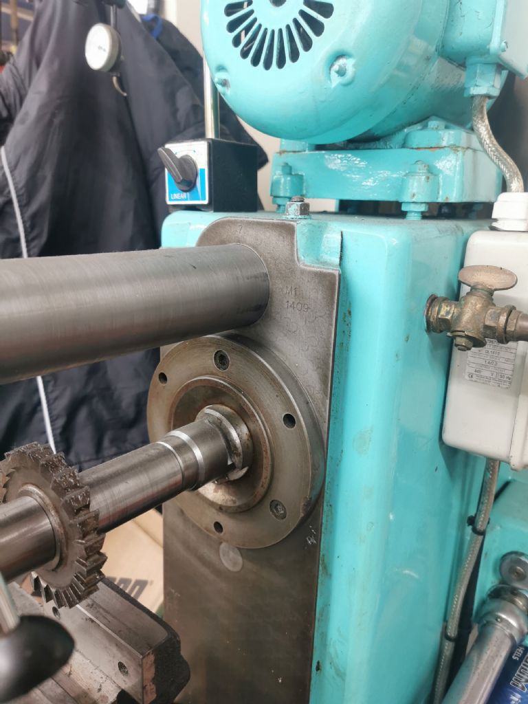

      Hi all the main support bar has started to move when milling both the locking bolts are tight anyone had this happen? is there a way to stop it? and am i right in asuming that the locking bolts will need to be replaced if so where can i get some
      Many thanks Bob

                                  hi all thank you for the replies i am using it in the horizontal not vertical the bar goes right through the casting so i would be suprised to find any cracks and there is nowhere to measure what it clamps on. tom.jpg

                                  Brian Wood
                                    @brianwood45127
                                    Hello Bob,
                                    Thank you for the photo, it makes all the difference to understanding what the problem is.
                                    The overarm, to give it it's proper name, is clamped by two pinch bolts, the other is behind the motor at the rear of the body that close shaped blocks onto the bar when tightened.
                                    I suspect the gap between the two clamps is non existent and they close on each other. To put that right, slacken the two bolts, pull out the whole bar and then lift the clamps from the bores they live in. Machine off a little, only a little, of the face where the scallops face each other to increase the gap again, refit and insert the bar again. They should now clamp with no further difficulty.
                                    Lathe tailstocks often use the same method to grip the barrel rather than squeeze a slot.
                                    I hope that helps you
                                    Regards Brian

                                          Ah, a picture which explains everything. The pairs of clamps touching are the prime suspects, strange that both sets should fail to clamp at the same time. This type of clamp is featured on the Light Vertical quill, the drill mill quill, the drill press and the lathe tailstock, all four of the machines at the museum lock perfectly.

                                            Just a quick update i found time today to sort the Tom out i relised i could pull he shaf out without undoing the 2 lock nut so i did as sugested and removed the locking bolts and i took 0.3mm off each end of the brass shoes where they meet refitted everything and it is now rock solid and does not move when cutting so thank you for all the comments i now have a fully working Tom Senior
