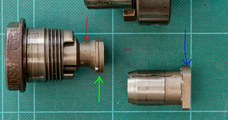

                          #731230
                          peak4
                            @peak4
                            On ChrisLH Said:
                            Michael,
                            Sadly all my Autolock collets (Vertex) with the exception of the largest sizes (5/8 and 16) have a rather wide circumferential groove (see Peak 4’s illustration above) in both imperial and metric sets. So it seems that identification by groove is not universally applied, mine are etched with the size on the body. All are 20 tpi though as Andrew says.
                            The little green indicated groove, as opposed to the big one with the red arrow, which I assume is to allow the jaws to flex. Blue arrow is imperial collet.
                            The later photo above does throw that somewhat; none of my imperial collets have that thin groove

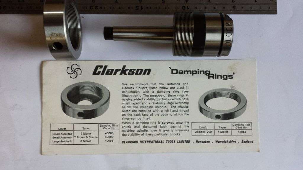

                            peak4
                              @peak4
                              This is also worth a squint for those unfamiliar with the damping ring[ can’t remember where I found the photo
                              Damping Ring
