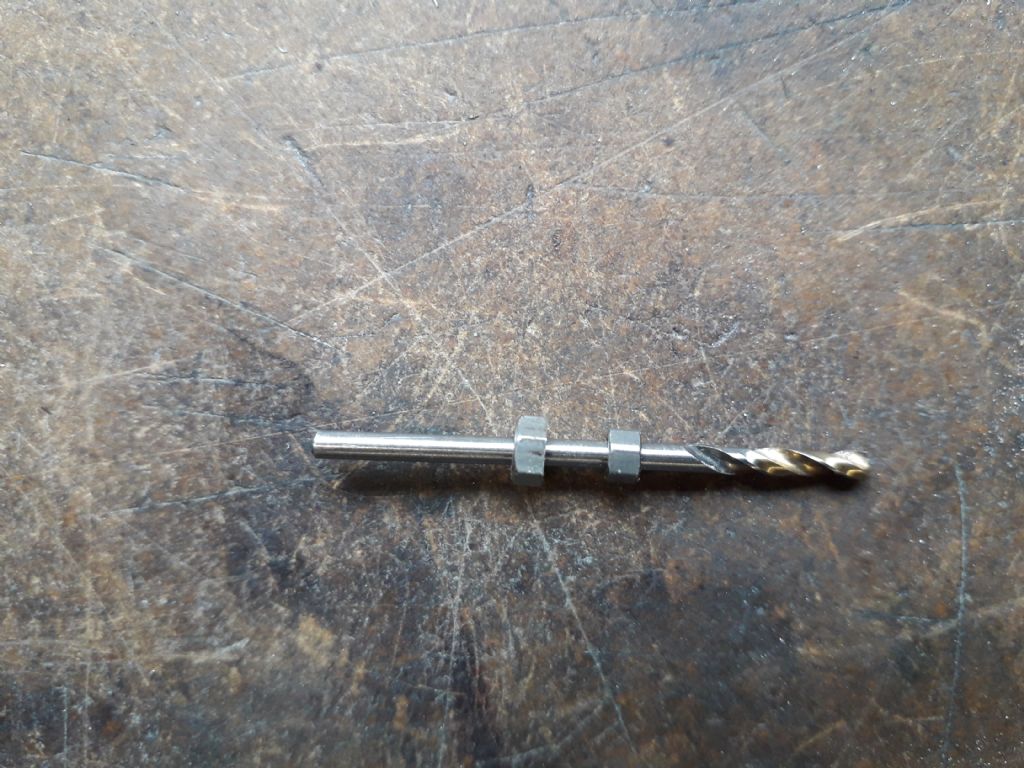

      I'm trying to find a thread (with available taps) with a major diameter of less than 2.4 mm and a minor of 2mm.
      It's for a shaft that passes through a 3/32 bearing which needs a nut that clears a 2mm section.
      And it would make life much easier if it was 60 degrees as well.
      I'm not bothered about the die as I can single point cut it.
      I've looked at the usual places. Zeus charts, Tracy Tools and Google but can't find anything.
      There must be some fairly fine 3/32 thread out there.

          8BA could be ok 0.086 " diamiter. (2.18mm)

              If you can single point that small cut a 3/32"-40tpi thread in silver steel, harden, grind 3 sides to make a tap then use the tap to make a nut. Cut the same thread in your part.

                3/32 x 40 would need a minor dia less than 2mm, even 3/32 x 48 Whit has a minor dia of 1.7mm.
                Unlike the chart above this one shows both major and minor diameters but I can't see much that would suit. I'll have a look and see if a 60tpi spoke thread may fit the bill
                #429160
                  If the load is not great you could thread your rod M2.5 x 0.45, the crests would be a little flat but you would get a minor dia of 1.948, but as tapping size is generally 2.1mm that will slide over the 2mm section.

                            I gave the M2.5 option earlier as Steve seems to work in metric but the other option is the good old model engineers favorite that can be found on many designs going back through teh years of 7BA on a 3/32" shaft which is much the same as using M2.5.
                            And just to show that the practical method can sometimes be better than the tables which may suggest that both will not fit over a 2mm shaft as minor dia is less than 2mm this photo shows a 2mm drill with 7BA nut to the left and M2.5 to the right (small hex) &BA from EKP, M2.5 from GHW so both good quality machined nuts not even looser mass produced items

                              Thanks everybody, I had considered inventing my own thread (M2.3 x 0.25 sprang to mind) but I don't have access to a grinder so the thought of making a tap of that size is a little daunting. If I had a bit more time on my hands I would give it a go, especially as the nut will be brass.
                              Thanks Jason, I like the M2.5 x 0.4 idea as I already have taps and dies. I like to work in metric but I mix and match when it comes to very small stuff to get a wider range of sizes. Hence the use of a 3/32 bearing.
