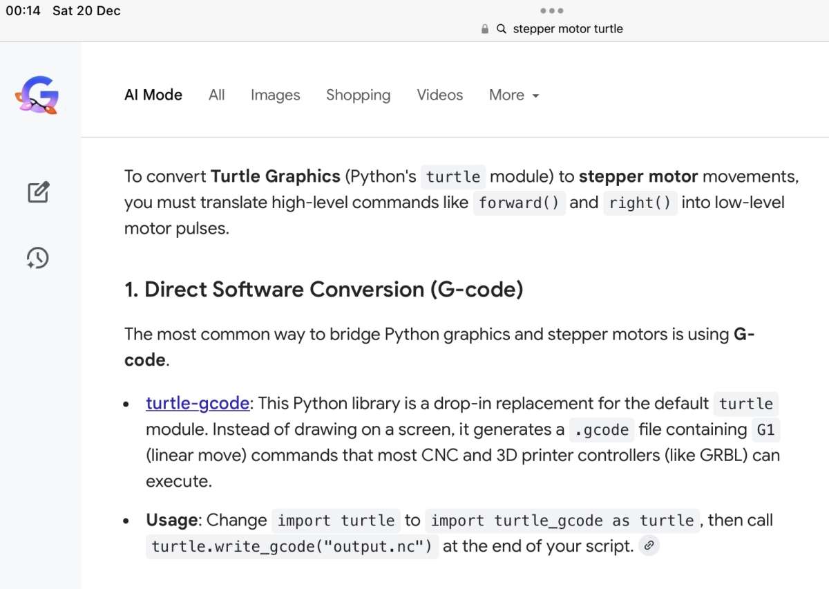

                                                #829447
                                                  Thanks to an AI-assisted search … This looks encouraging:
                                                  IMG_1308
                                                  Ref. __ https://pypi.org/project/turtle-gcode/
